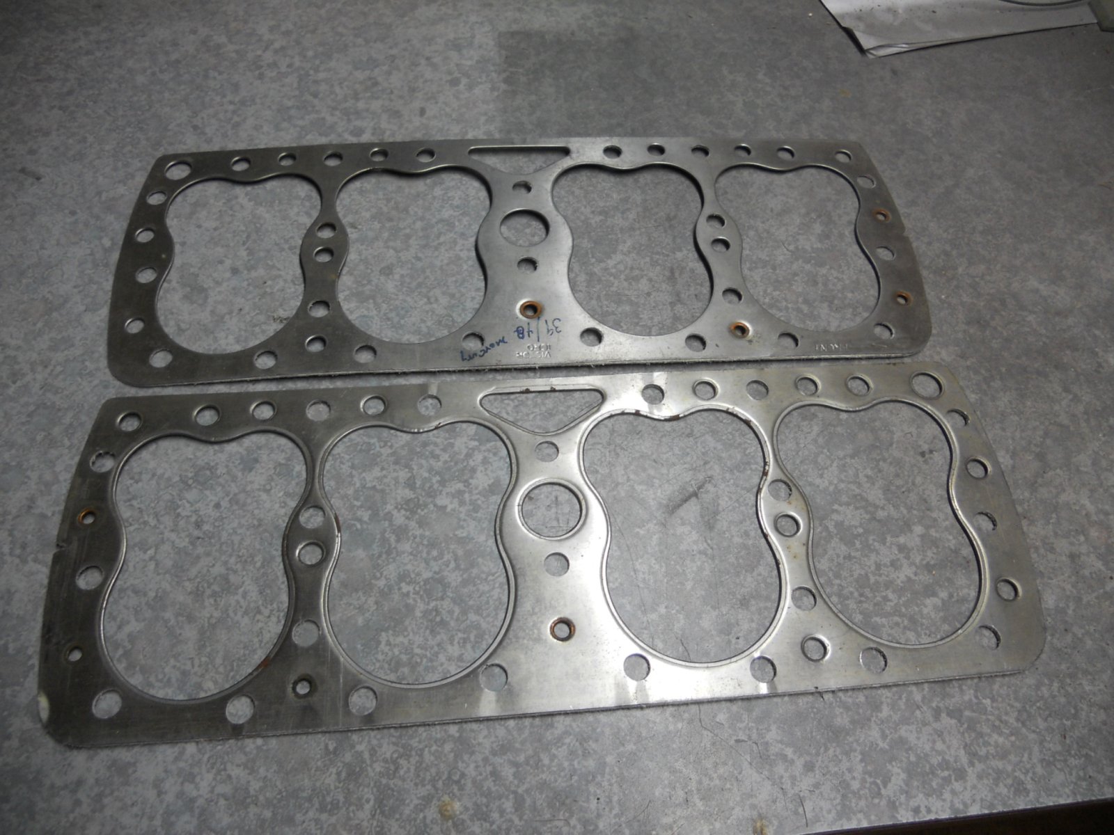

    1 - I'm a little confused about the reasoning on some of the responses that have been posted here.
    It seams like most of you think I should keep the 1st block instead of going with the 2ed block and either buy new heads or do a lot of machining to reduce the compression.
    First off, I don't have $900 to spend on new heads and if I did, I wouldn't buy them anyway.
    I like my Navarro heads. You don't see them that often. The new heads that are $850 plus tax and shipping, are Offenhauser which are very common.
    2 - Thanks to Chiken from Kansas, I know that the 1st engine has 9.75-1 compression. The 2ed engine has a little under 9.1-1 with using my Navarro heads.
    Simply by using the 2ed engine, I've already dropped .65-1 compression, That seams like a no brainer to me.
    3 - It has been mentioned here and on other post that I have read, that there is no problem with using 2 head gaskets.
    I have a pair of the old Victor metal clad gaskets with 3.250 bore hanging on my garage wall and I can get another pair for less than $60.
    Together, they measure .160 thick and I wouldn't think that they would compress down more than .01 or .02 so that will open up the compression chamber and maybe even drop the compression down to around 8-1 ?
    As you can tell from the color left on the heads of the 1st engine, I always use a copper seal gasket spray on head gaskets and I've never had any problem with them leaking.
    4 - There seams to be a lot of concern with cracks in the blocks. It's hard to find a flathead now days that doesn't have at least one crack between the water hole and the thread in the center of the block between the first two bores or the last two bores.
    So what ! I have always used a non hardening gasket sealer like Permatex High Tack on all the head bolt threads simply because they are threaded into the water jacket and they can leak around the threads themselves.
    I did that with the my first flathead way back in 1963 and with every one that I've had since. I know at least two of the engines that I've had over the years had cracks in those places because they were clearly visible.
    I was lucky with the race engine that I just took out of this car in that it doesn't have any cracks because up till now, it hasn't been run since the 1970's at the latest.
    This replacement block has a crack in each of those four spots, I knew that when I bought the thing. From past experience, I know they won't cause me any problems !

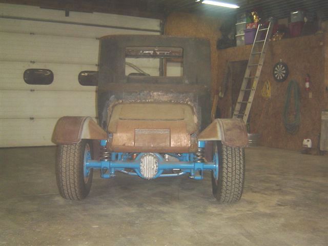

    Are you going to keep the Jag rear visible in the first picture ?
    Retired likes this.
  15. Retired
    Joined: Jan 4, 2009
    Posts: 366
    Retired
    That is a 65 Mustang rear axle with a quick change rear cover adapted to it.
    hrm2k likes this.
  16. hrm2k
    Joined: Oct 2, 2007
    Posts: 5,495
    hrm2k
    sorry, my mistake ….sure looked independent in that picture
    Retired likes this.

    How about running a set of stock heads for a while? The're cheap enough and should give you a good indication about what's going on. The only problem here is the cost of head gaskets these days. Around $60 a pair for regular gaskets, but you can spend up to $200 for Cometics. I only use grease when installing head gaskets. With properly prepared mounting surfaces, leaks are not a problem and they come right off. Copper spray and other sealants make the gaskets difficult to remove and they are frequently not able to be reused. When you are on a budget, being able to reuse a set of head gaskets 2 or 3 times is a real moneysaver. Save the sealant for the headbolt/stud threads.
    About cracks. The obvious cracks that a lot of engines have between the water p***age and bolt hole are harmless and common enough to be called "part number cracks". (Meaning they are so common that some say they have their own Ford part number.) Other not so obvious cracks can render an otherwise pristine block useless. It all depends on whether you feel lucky. There are dozens of threads on the forums about guys who have gone through as many as 7 blocks before they found a usable one. I, personally, have been lucky in that 6 of the seven flathead blocks I have gotten over the years have been good. I even had 4 without the "part number cracks".
    Let's hope you get lucky.

    "3 - It has been mentioned here and on other post that I have read, that there is no problem with using 2 head gaskets.
    Together, they measure .160 thick and I wouldn't think that they would compress down more than .01 or .02 so that will open up the compression chamber and maybe even drop the compression down to around 8-1 ?"
    You are almost right on the money...a close guess will be that the extra gasket will add about 10cc or a bit more and put you at 7.9 or so. (close guess) What you will NOT have is a good quench distance from piston crown to combustion surface of the heads (it'll basically become an open chamber), but as with anything it's all a balancing act and you work with what you have. If you like the heads and are willing to experiment a bit ( as I know you are) why not try it? Some great things can happen when a person stops listening to accepted practices. I do wonder if the more open chamber might want a bit more timing than "normal".
    INVISIBLEKID and Retired like this.
