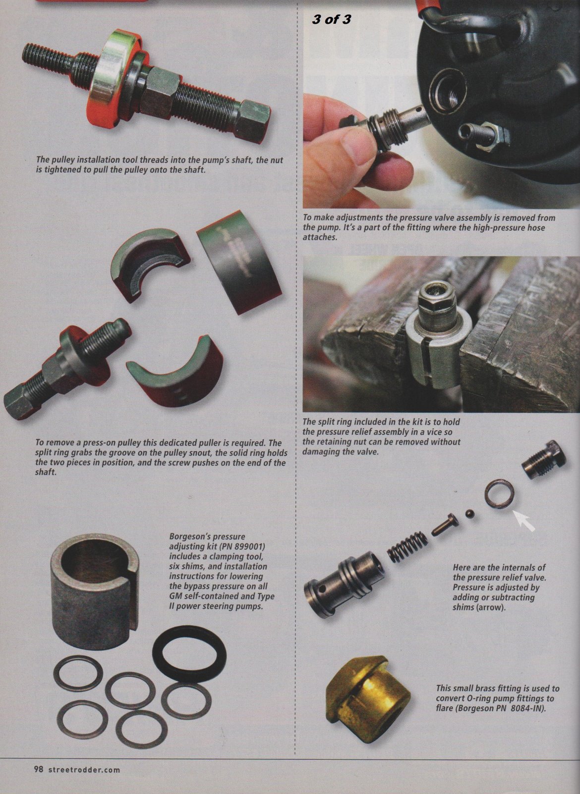

    If the power steering is too quick to suit you, you can shim/some pumps to lessen the pressure and make them more better. Here is some info on the Chevy pumps as an example.
    GuyW and Retired like this.
