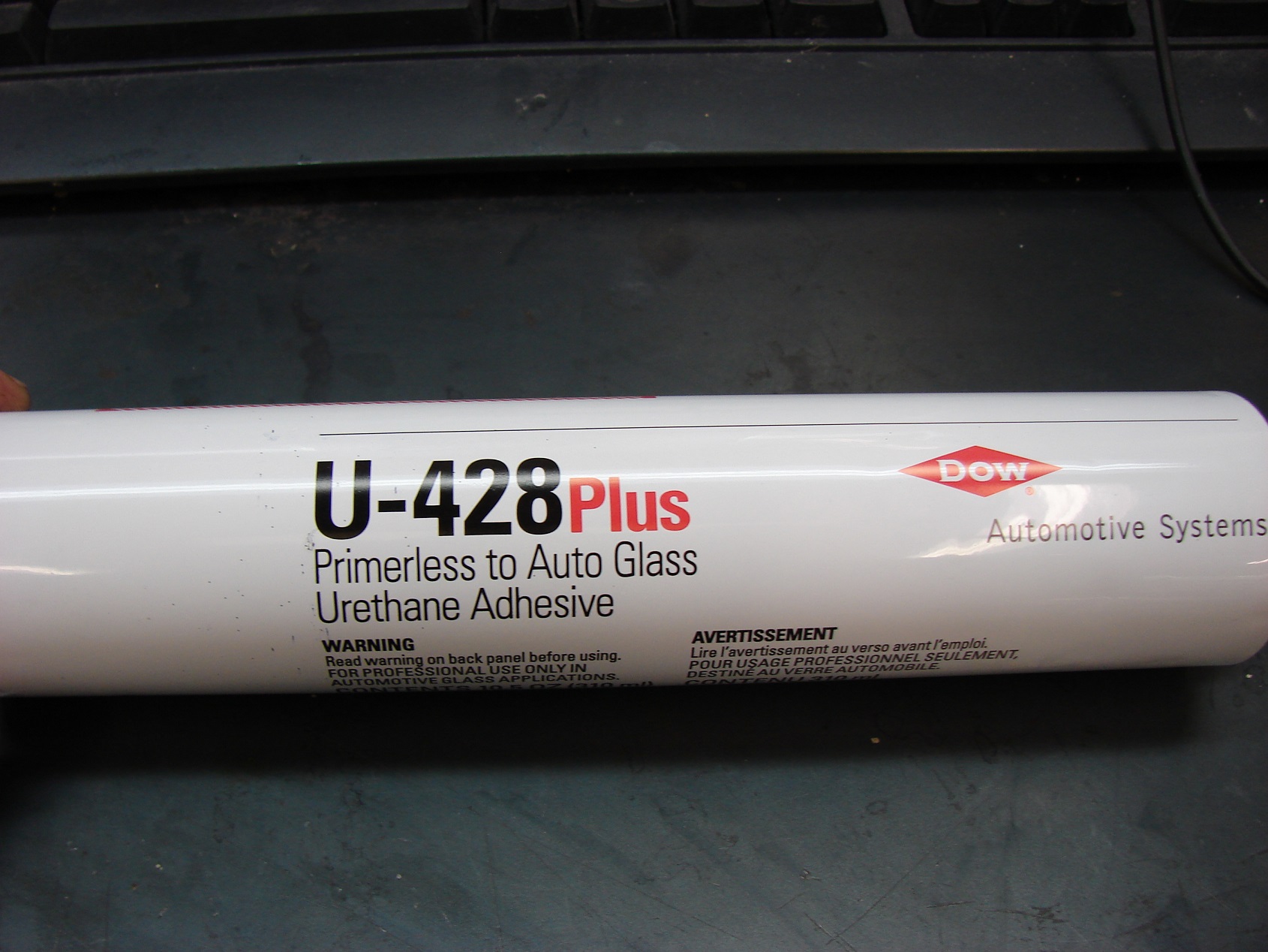

    What is the urethane sealant you used?

    This is what we used. It`s windshield sealant that we use in our gl*** shop.
