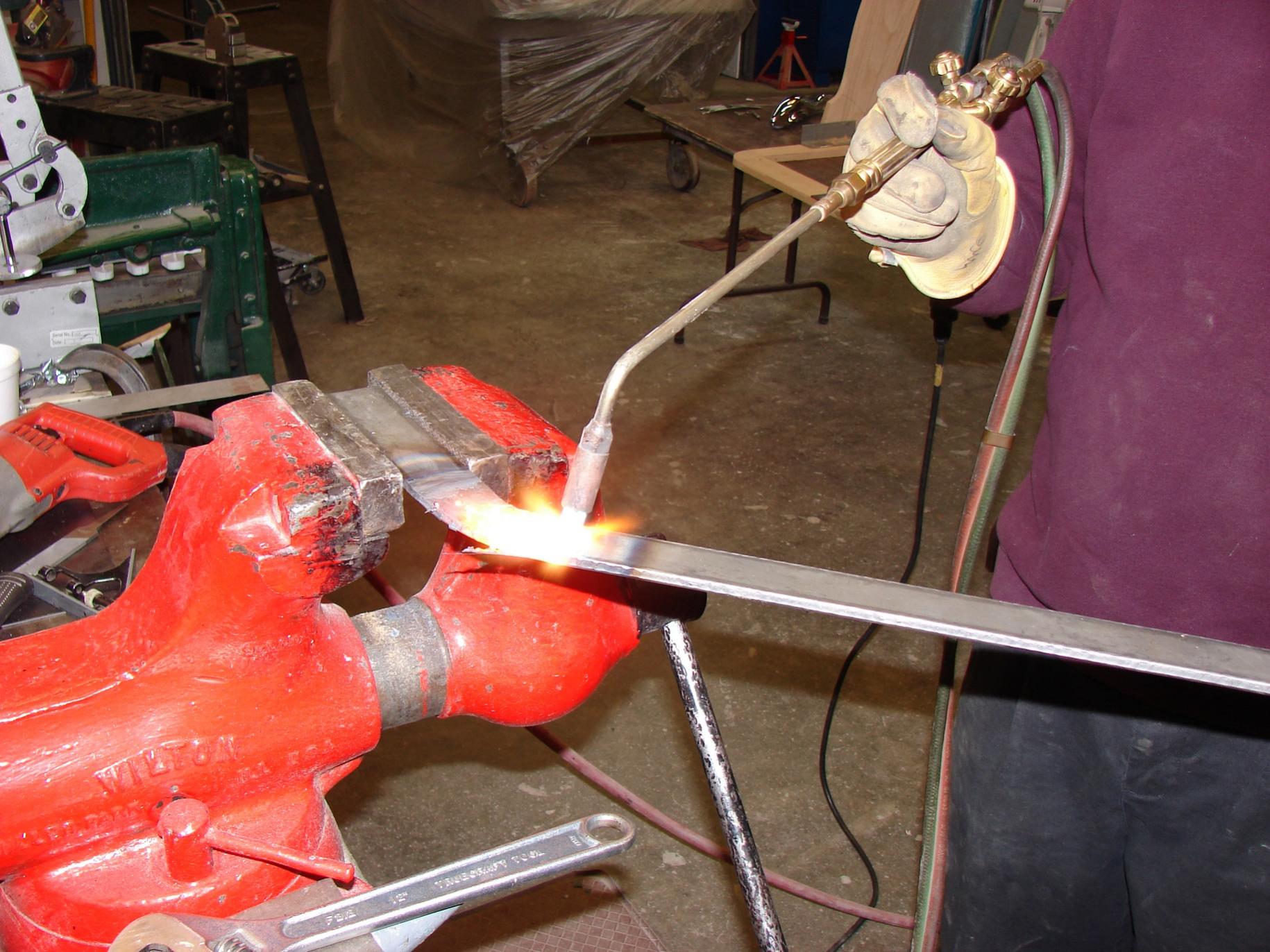

    When you did the plywood on the roof did you lay the outer edge on the metal or just inside? and what was the thickness 1/8" or 1/4"
  7. sailingadventure
    Joined: Feb 11, 2007
    Posts: 283
    sailingadventure
    We used 1/4" plywood, it was cut to fit exactly in the opening so there would be as little gap as possible. The plywood was given a coat of clear polyurethane to give the contact cement a good surface to stick to.
  8. rusty rocket
    Joined: Oct 30, 2011
    Posts: 5,262
    rusty rocket
    Kool thanks for the info. was going to do a metal insert with top material over that but the wood looks like it works well.

  16. sailingadventure
    Posts: 283
    sailingadventure
    005 (2).jpg I don`t have any pictures with the bare plywood showing, but this is how it looks with the insulation installed.
    111/10/15 Well I did find a picture of the plywood from inside. Here it is 012.JPG
