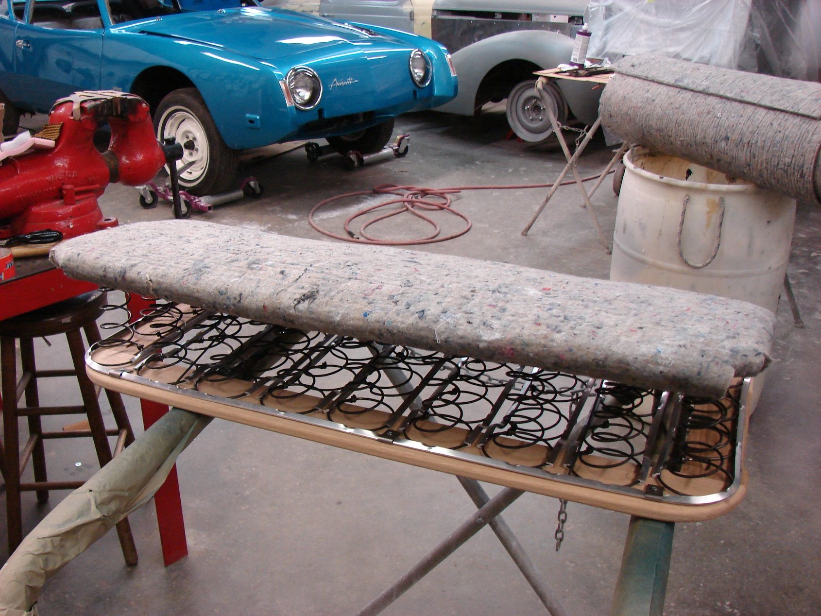

    Last week was busy at the shop and not much time was spent on the `32, but here are a few pictures of Steve starting to upholster the first seat bottom.
    The first step is to cover the springs with burlap. Then cover the burlap with padding. I bought a heavy duty sewing machine a while back, and now it`s time to learn to use it. That`s about all that was done last week, but I`ll have more pictures soon.

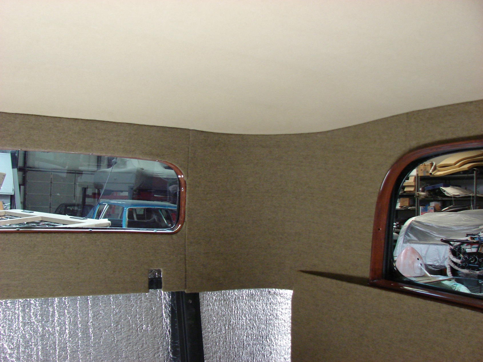

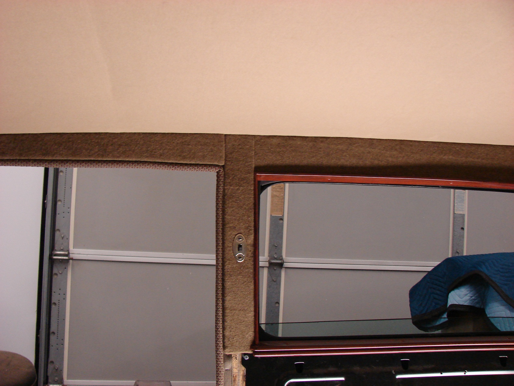

    Since the last post, the headliner and some of the panels have been installed. First the wind-lace around the doors was installed by gluing and stapling.

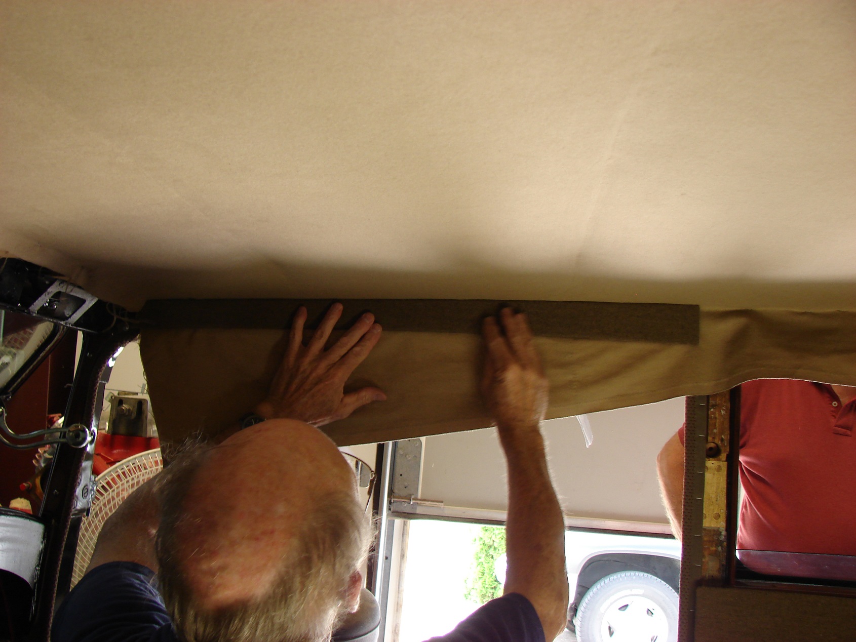

    In the next picture Don Fowler is helping to install the headliner. Starting at the back of the car and going forward.
    After stapling the headliner to the wooden bows, it was glued and stapled to the sides of the car.
    The trim panels were fitted to to make sure everything fit properly.
    We are learning as we go, so it is taking longer than it would if really knew what we were doing. I`ll have more soon.

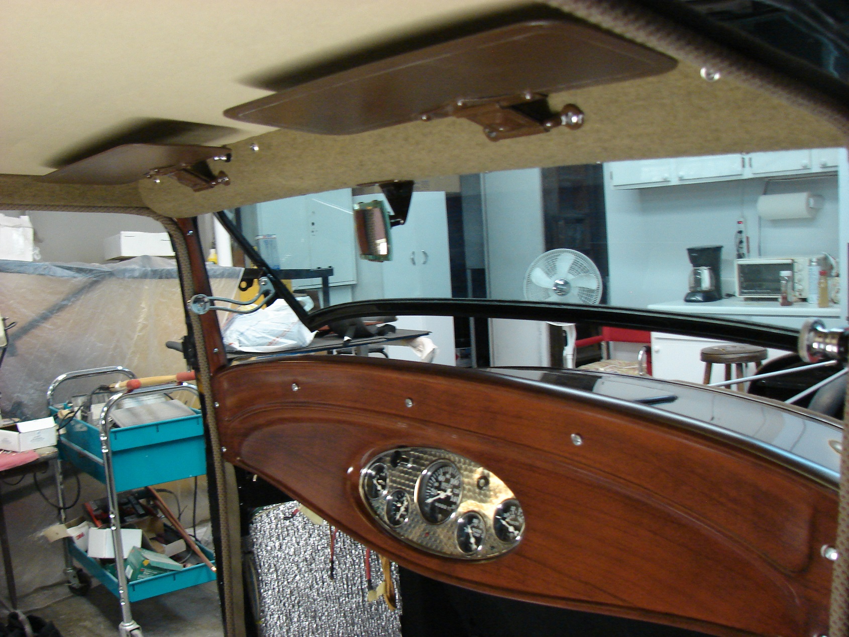

    Here are a few more pictures of the trim panels in place.
    Not all of the panels are permanently installed yet, but this gives you an idea of what it will look like.
