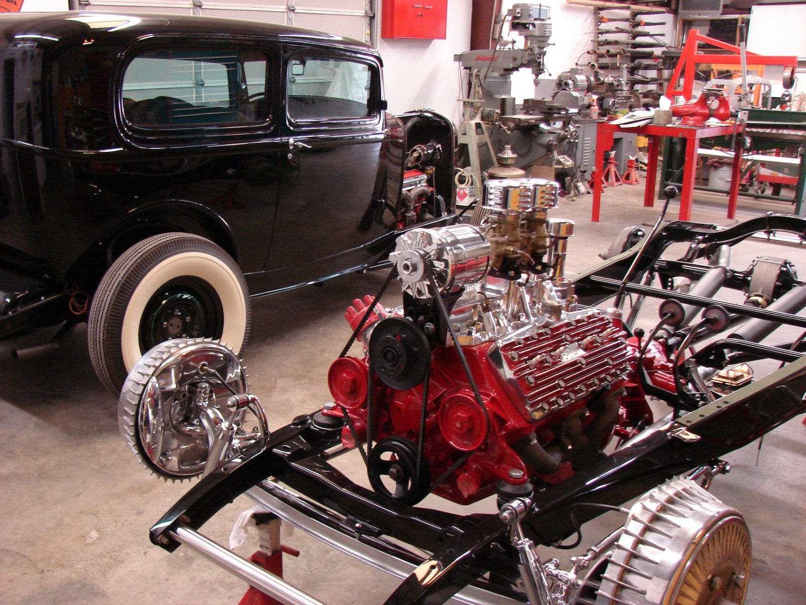

    OK, here are a few pictures of the exhaust system. Steve bought some "U" bends to make the turns in the pipe and cut them to fit, kind of like making a set of headers. After tacking the pipes together they were TIG welded. The pipes have flanges to make possible to remove them when needed. The flanges were not welded on the end of the pipes, but a couple of inches back and the pipes slipped into the mufflers for a more air tight seal. Heat shields were made by welding a couple of bolts on the pipe where needed. A piece of the pipe was cut out and spaced with lock nuts.
    The upholstery of the seats is on hold while practice continues with the new sewing machine.
    Meanwhile, the fenders are being prepped for paint.

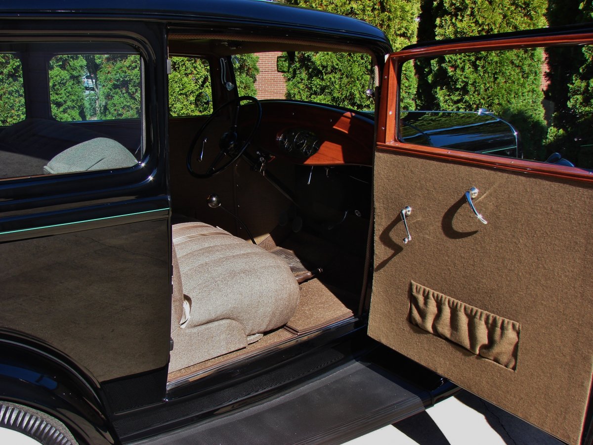

    002 (800x600).jpg 001 (800x600).jpg 002 (800x600).jpg 003 (800x600).jpg 027 (800x600).jpg 030 (800x600).jpg View attachment 2773431 038 (800x600).jpg 032 (800x600).jpg Well, it`s been some time since I`ve updated this thread, but we`ve been busy. Steve is just about finished with the interior and here are some pictures.
    The interior is finally finished and now it`s time to get the fenders ready for paint.

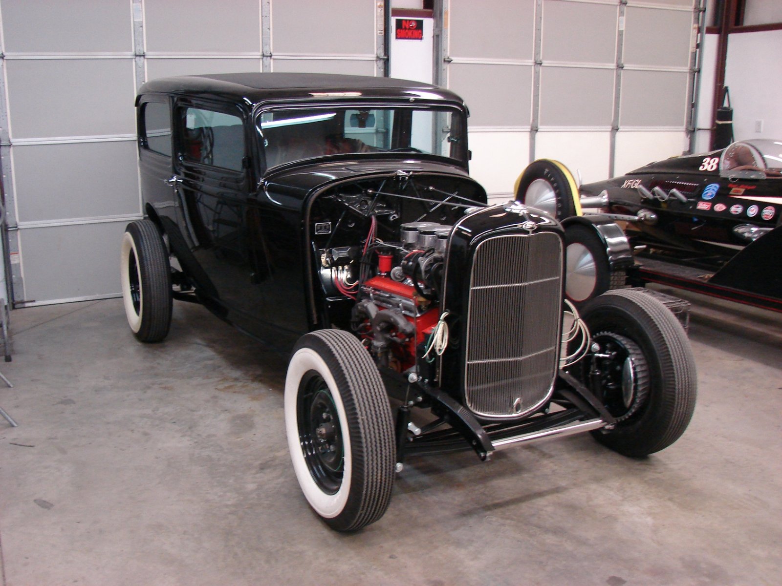

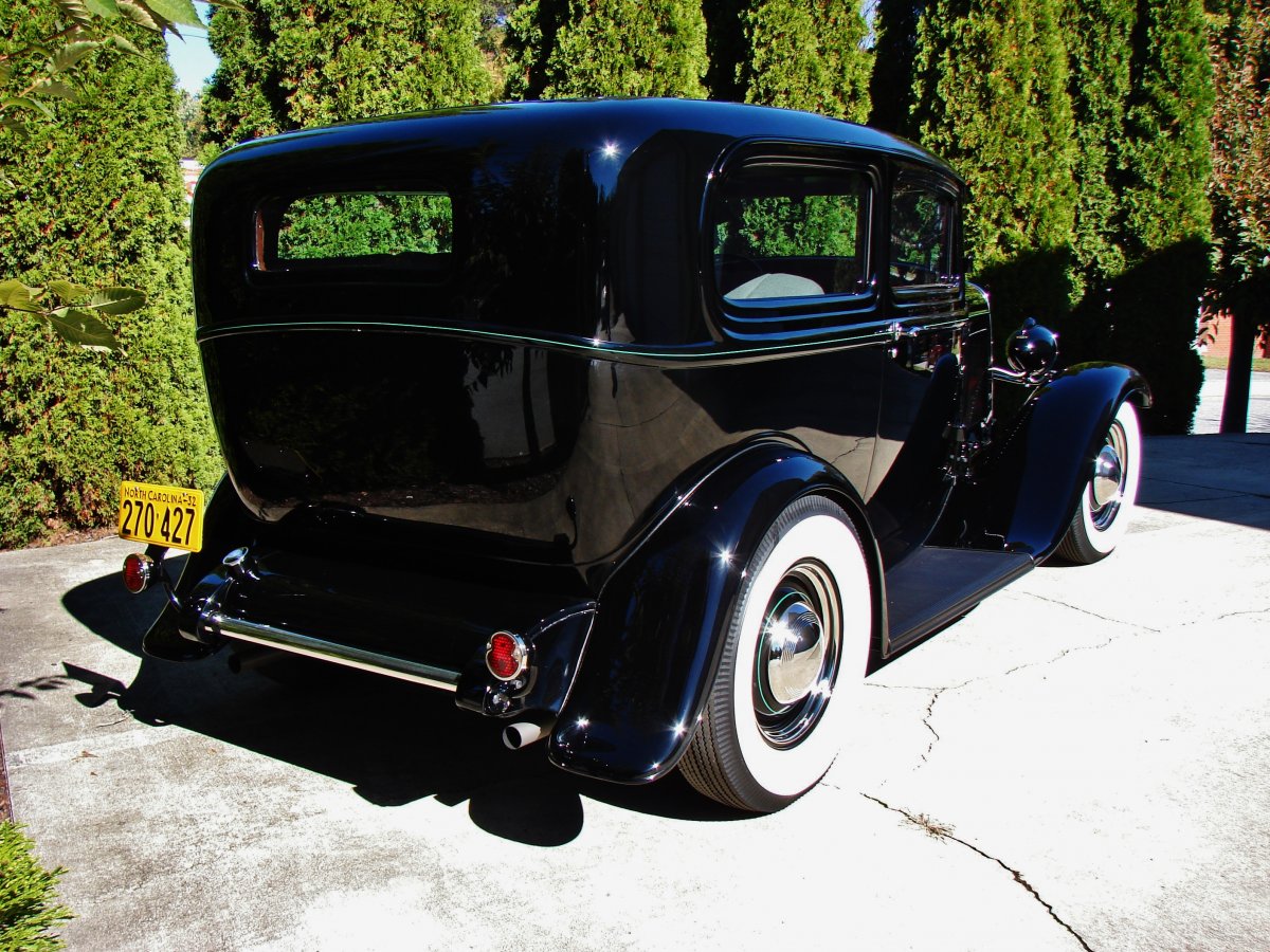

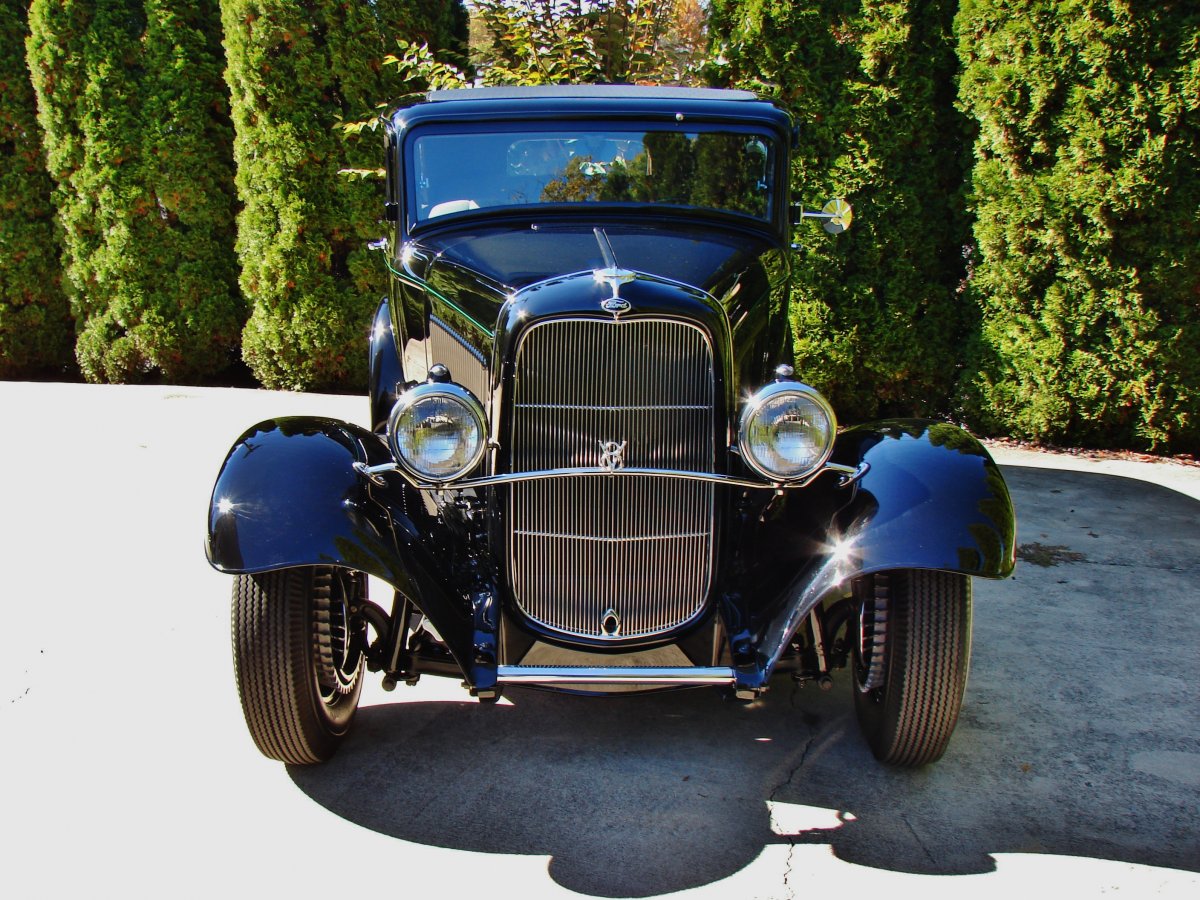

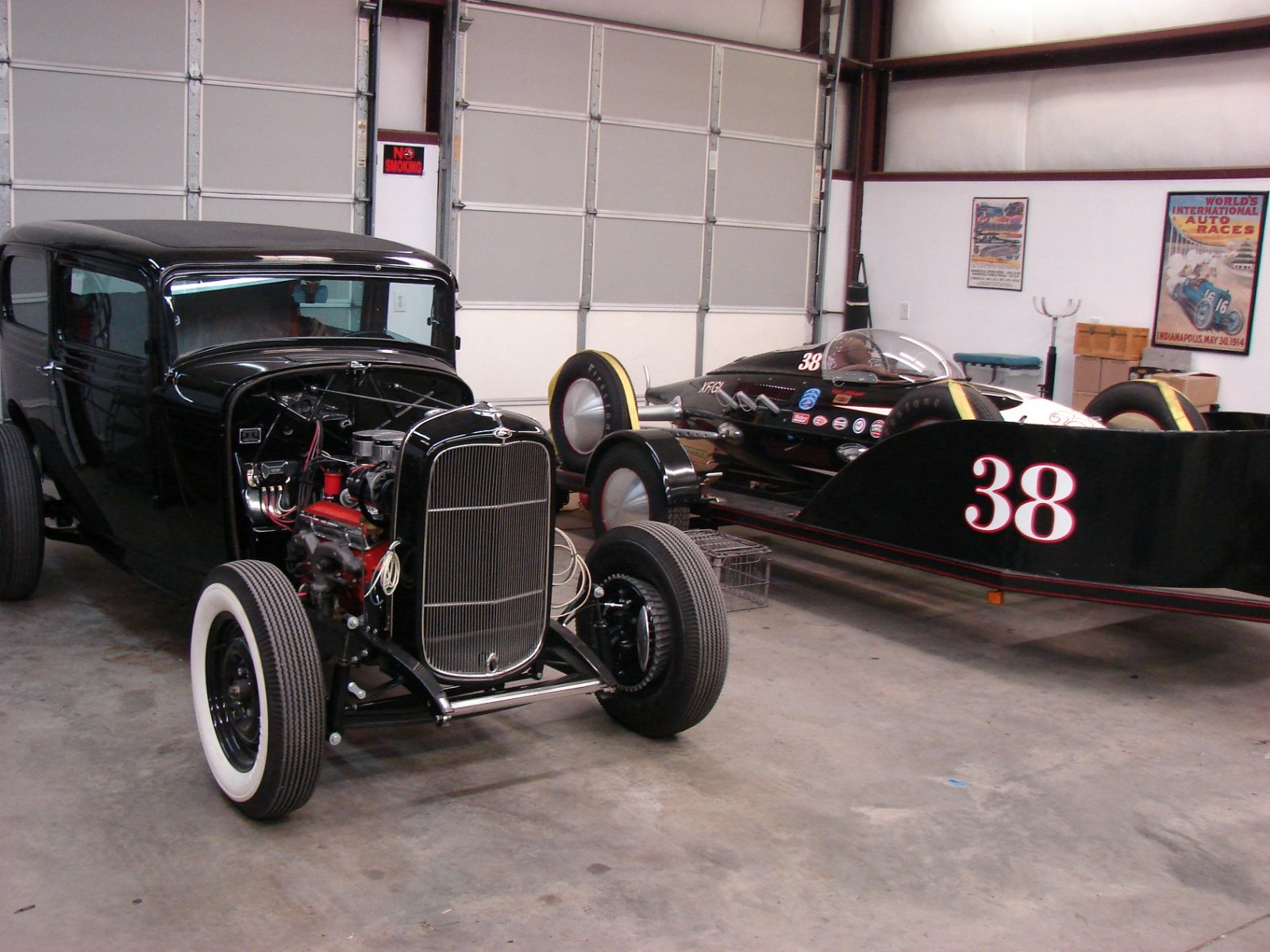

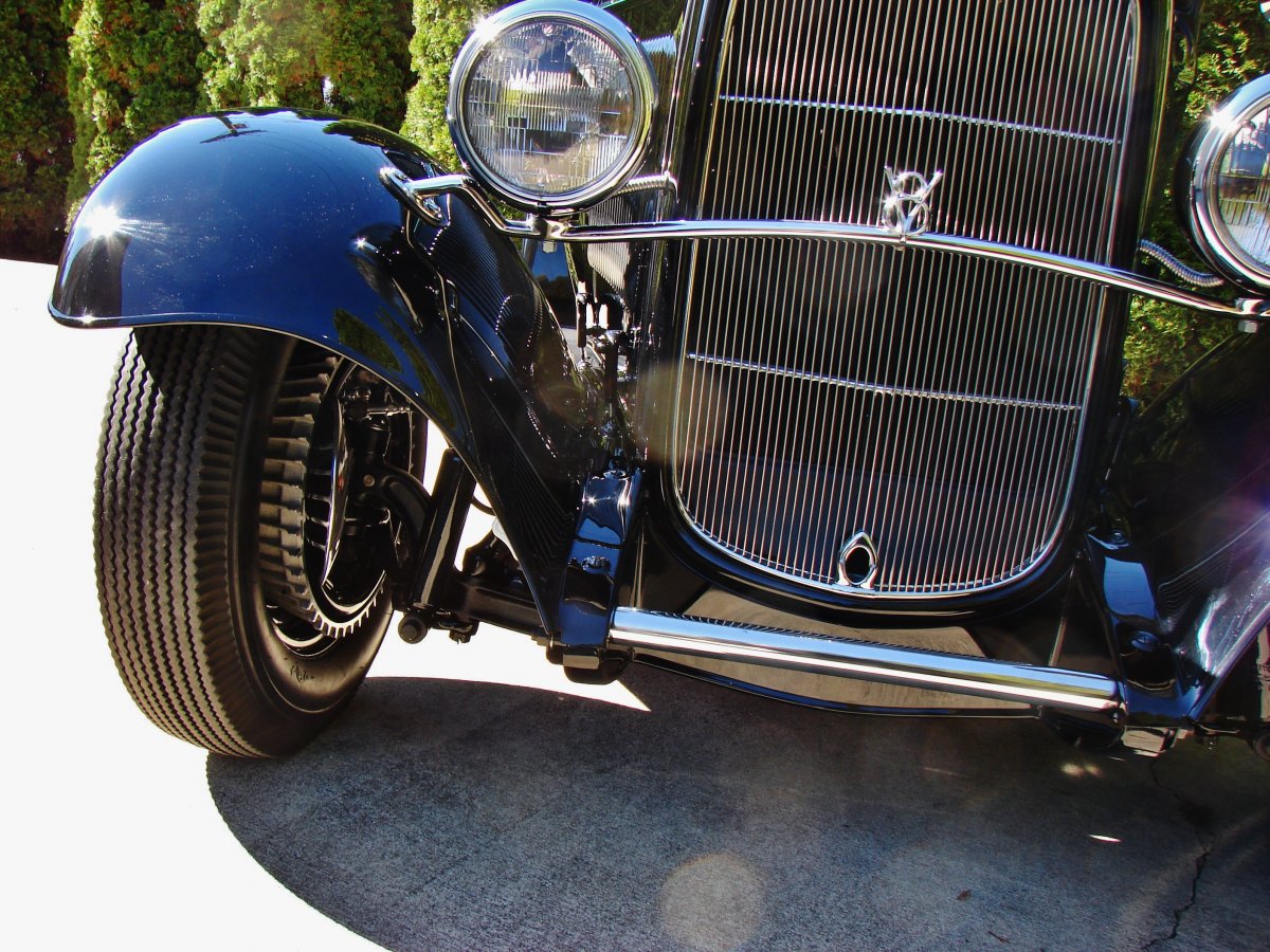

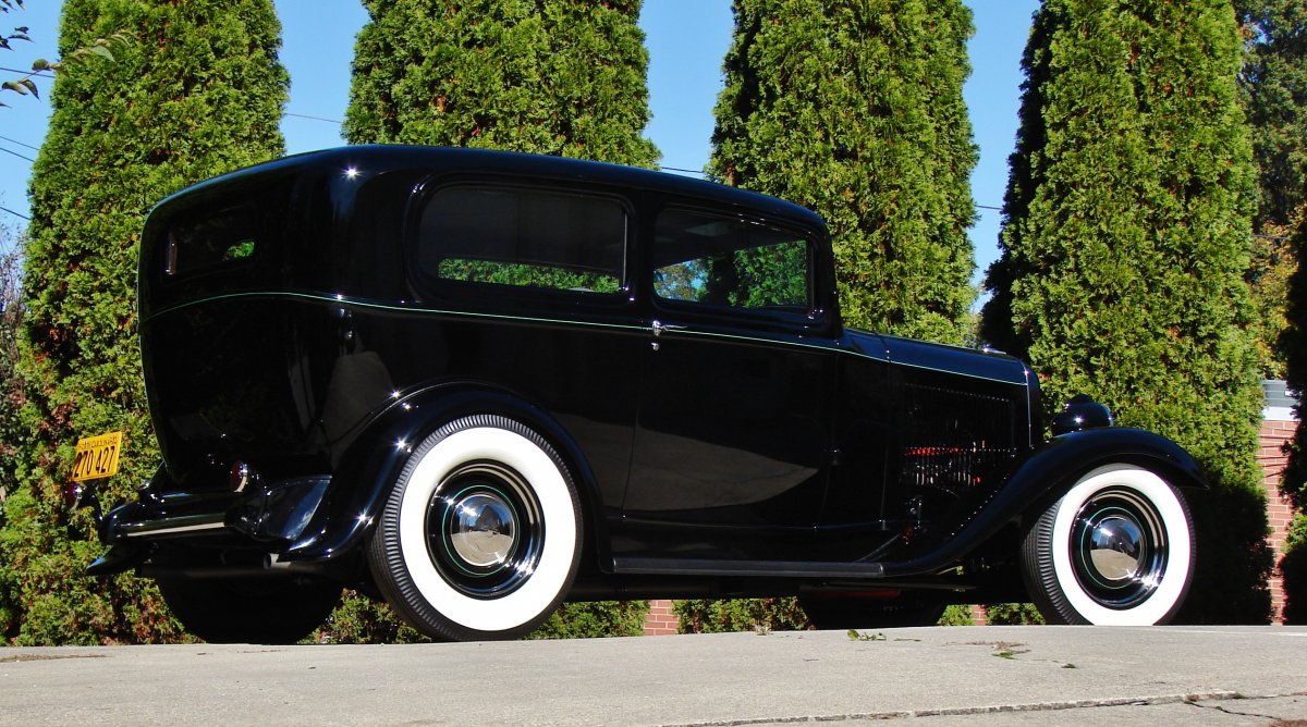

    Things sometimes move slowly around here but the car is finally roadworthy and has been driven some to shake out the bugs. Here are a few pictures of the `32 as it is now. We were moving things around the shop this morning so I took a couple of pictures. The videos were taken in January. Steve`s working in the fenders and hopes to have the car completed soon. Mooving Day 011 - Copy.JPG

    Very very nice. I see the gl*** has a blueish/ greenish hue. can you fill me in on what gl*** you have used?

    I think it`s just the way the camera recorded it. It`s automotive flat laminated gl*** that was cut to the patterns Steve made. The gl*** has a green tint.

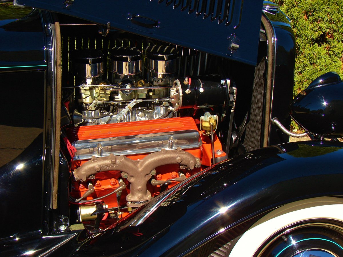

  18. Very, very nice. I'm curious, what was the donor car for the 3 speed overdrive?

    It was a `51 Ford. We used a transmission adapter, but what a pain in the *** it was to make the clutch work with this set-up. Ford disc, chevy pressure plate, and we put in the wrong release bearing the first time. Pulled the transmission, replaced the bearing, still wouldn`t release. Pulled the transmission, saw that the hub on the Ford disc was too long to let the release bearing push the pressure plate down far enough to release. Had to cut the hub down. Re installed everything, still wouldn`t release, ****! Then we played a little with the clutch linkage ratios, made another arm for the cross shaft, still wouldn`t release. Then I decided to put some very thin washers between the pressure plate and flywheel. This would reduce the pressure plate spring pressure a little, but not enough to cause a problem. It also moved the contact point between the release bearing and the pressure plate spring back and gave enough travel to work. SUCCESS! And then we moved on to the next problem. The car would go into low gear once and reverse once, but then it would lock up. What the hell is wrong now? It seems that when the used shifter was taken apart the last time, some dumb-*** (ME) put the spring that pushes the shifter into 2nd gear when shifting from first to second, on the wrong side of the shift arms. Now the shifter worked, but the transmission still locked up when shifting from first to reverse. After another sleepless night, I pulled the shift plate off of the transmission and realized that when I built the transmission, I had re ***embled the low and reverse arm on the wrong side of the slot in the reverse gear. This also engages the part of the overdrive that allows the car to back up. Finally everything works , should have used a 5 speed, but this is a traditional hot rod and we wanted it to be period correct.

    That sounds good, like a small-block should! Outstanding. Love all the vintage corvette parts, like the engine mount and nine fins, really nice. I think the chop is right on the money. What a nice car, beautiful work.

    Really like the aqua pinstriping...I'm guessing the cam is an 097?
