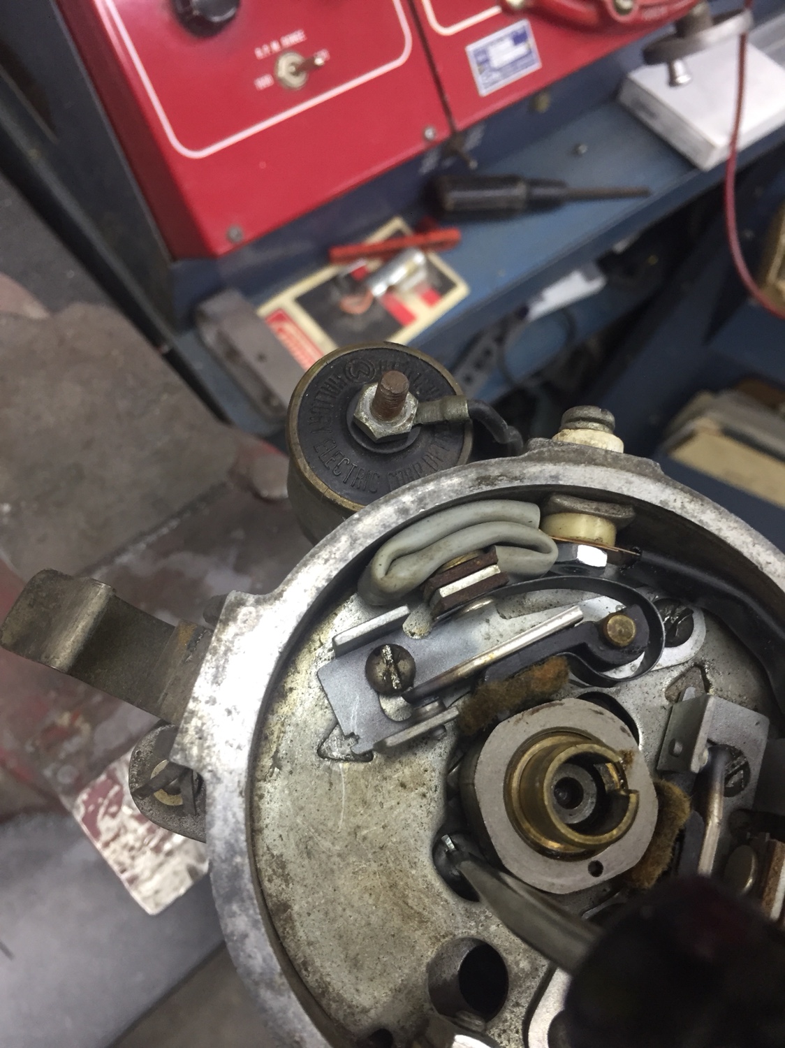

    I am not familiar with the model a version but I bet it is the same as the later ones. Rotate until a screw is visible in the opening on the breaker plate[​IMG][​IMG]
    Loosen the screw (don’t take it out) and then put the rotor on and use it to turn the cam in to position. Then tighten the screw. The next pics are with the breaker plate removed just to show the screw and clamp. You won’t need to remove yours. I just wanted to show you. Hope this helps[​IMG]

    Moriarity has it correct. To add : Place engine on tdc #1 cylinder using cover pin on engine, Install distributor in engine using the detent hole. Loosen rotor like above and turn rotor until its pointing at number one with both sets of contacts open.
    (by the way rotor to cap index or rotor phase is not effected by turning housing )

    image.jpeg image.jpeg Well the rotor can't be re-phased it seems, it has a clamp but the clamp has a flat portion and a corresponding land on the base of the rotor.
    Only on one side, there is a screw hole 180 from the land but I can't get the rotor to turn in the top plate for the centrifugal advance mechanism.
    I can turn it 180 and Daren it down but the rotor is still 140-150 degrees instead of 180, as such I just swapped the leads 180 and put it in but it won't run, close but no cigar.
    So the drive shaft is fixed, the dist body is fixed and so is the rotor, what gets me is that it's a model A distributor but will not work in a model A.
    All I can think of is maybe the driveshaft can be moved to line up the rotor correctly but that's for another day.
    I bought a "Nu-Rex" point plate and it will be here in a few days, it'll run just fine after that's in and I'll save the Mallory for another day.
