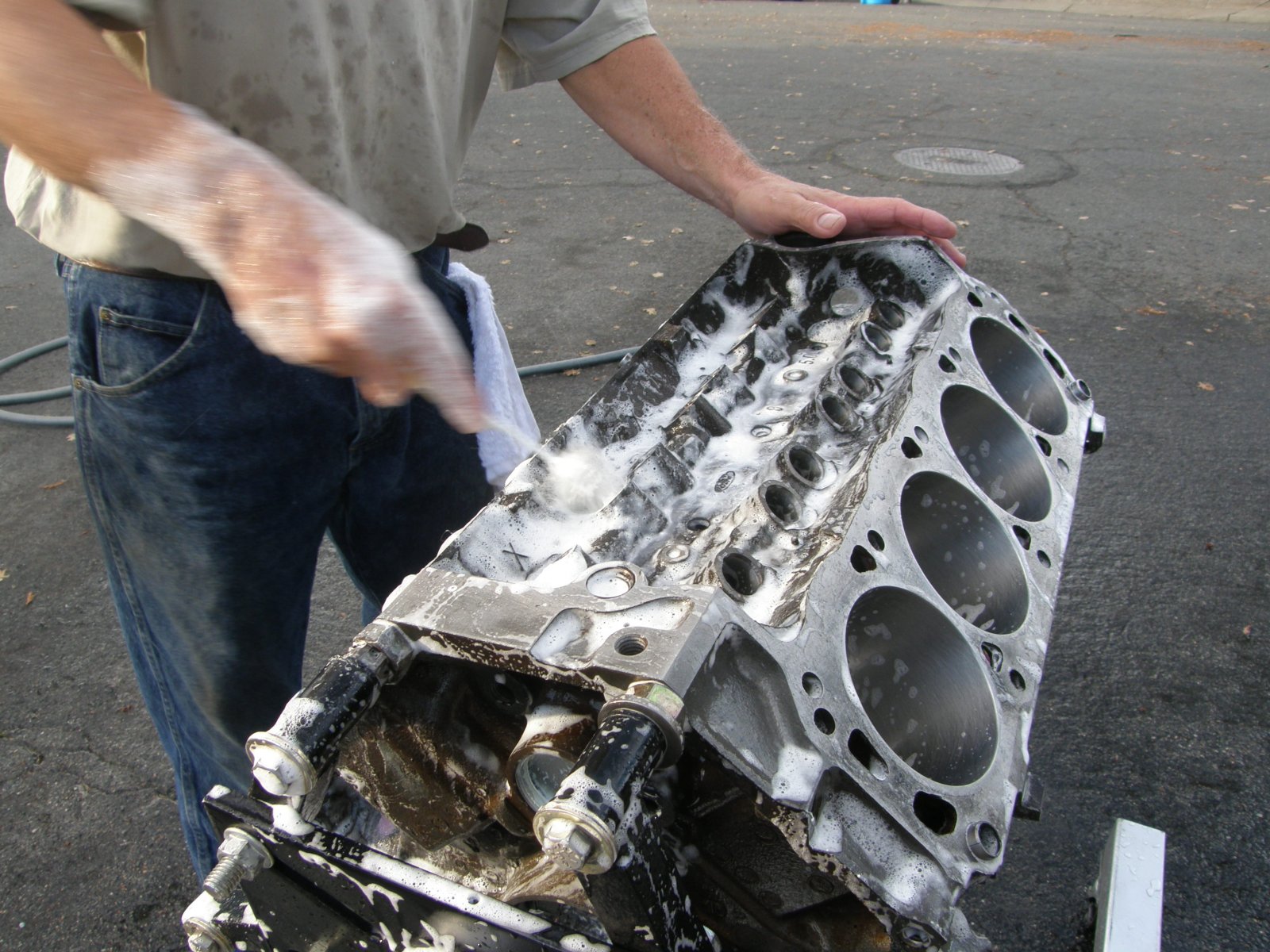

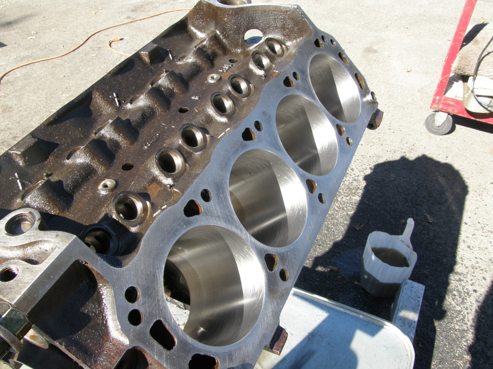

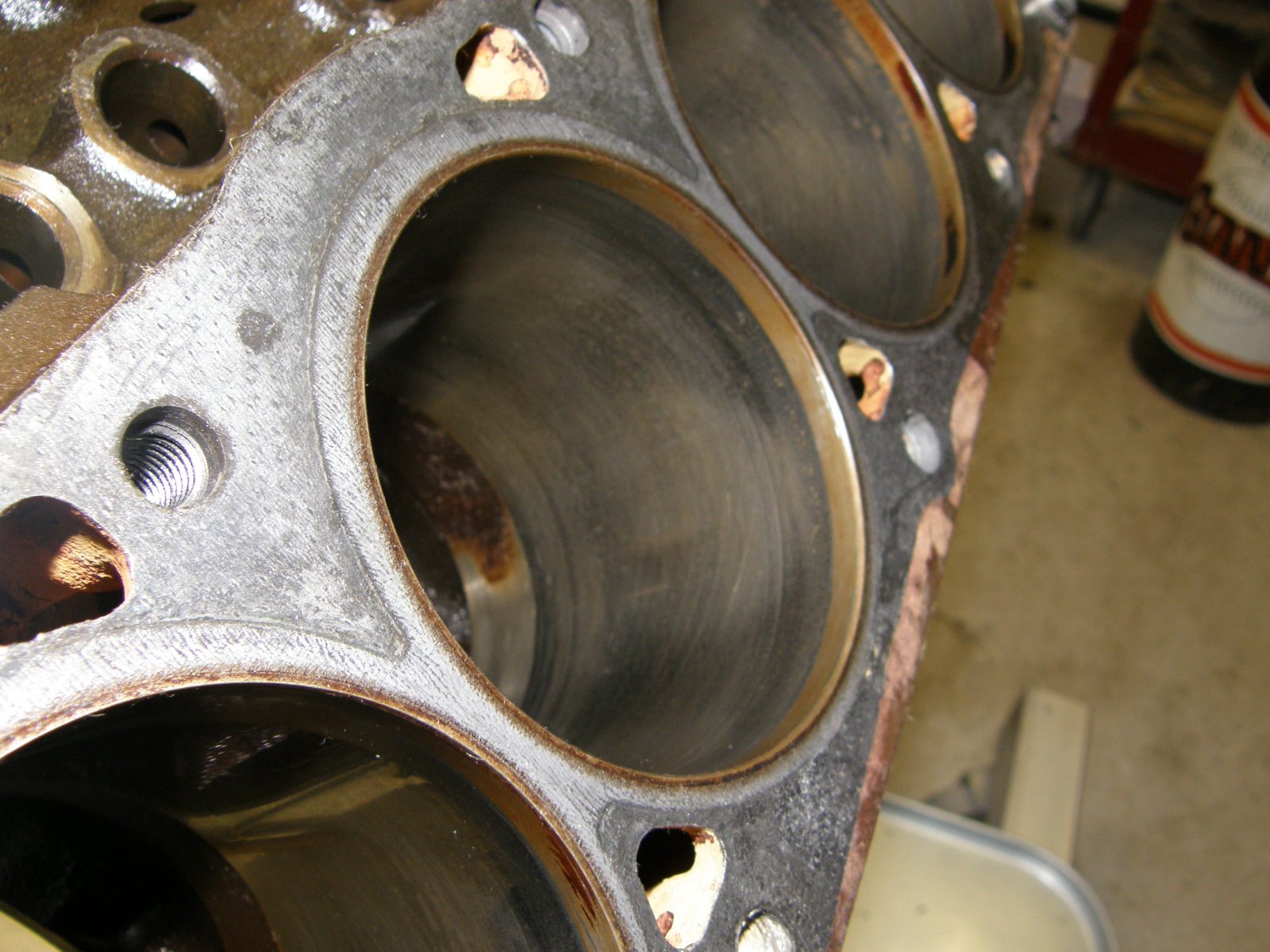

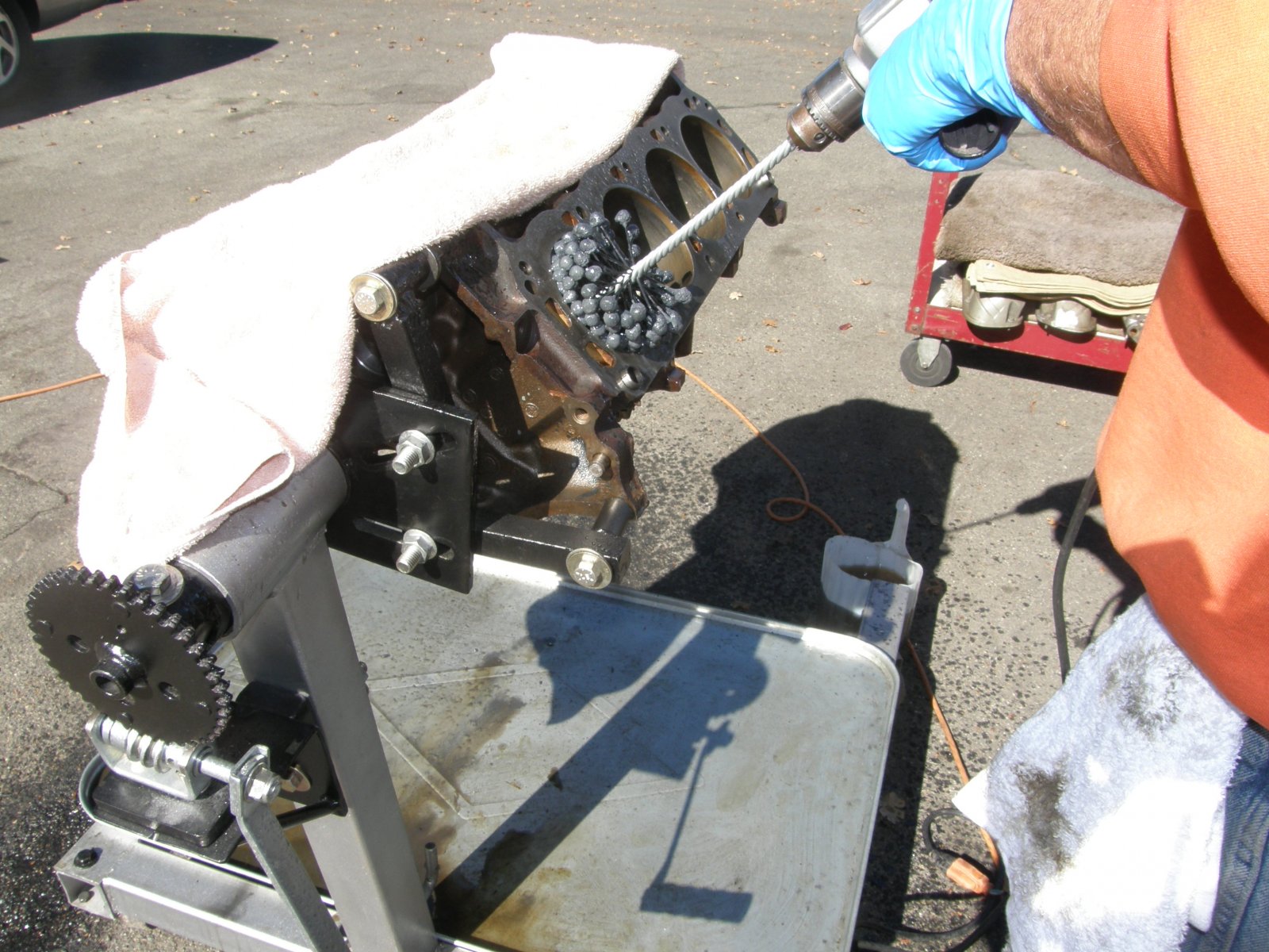

    Just did a re-ring on my 100k 5.0. The worst cylinder measured .005 out. Ridges weren't bad at all. I s****ed them down with a razor knife then used a 240g ball hone on the cylinders. Make sure to wash the block real good with soap and water. Real world results remain to be seen.

    You will not have any problem with what you have done. After the carbon ball hone you can’t see any evidence of a taper.
