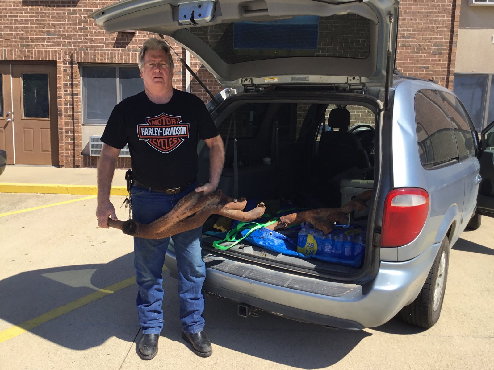

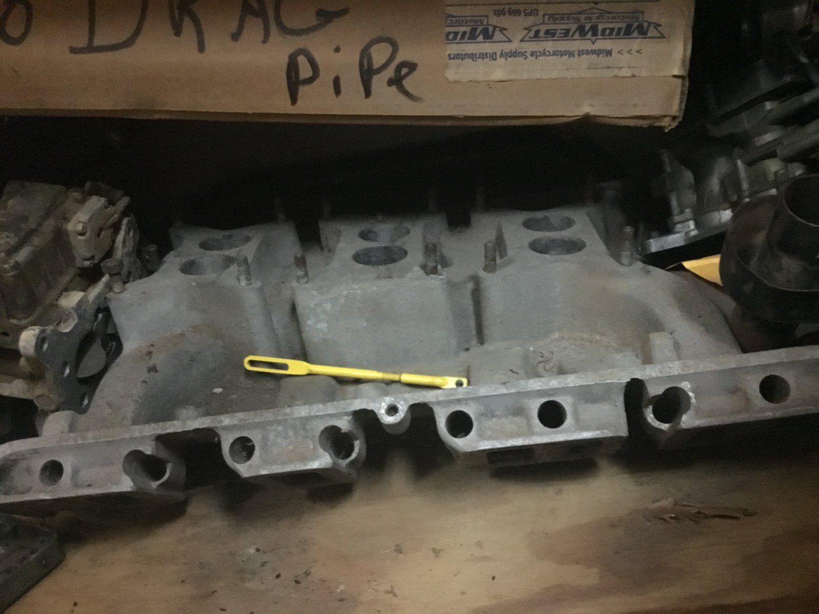

    The exotic FE stuff is very pricey! Even the quasi exotic stuff is expensive. I am in the slow process of building a 462 FE with 3X2s and 1965 factory cast iron long tube headers. I bought them several years ago and now they have doubled in price! But this project is coming along S L O W L Y! Lol Still saving up for my 4.25 crank kit.
    See what you can do on that 428 trade, they are bringing good money , now!
