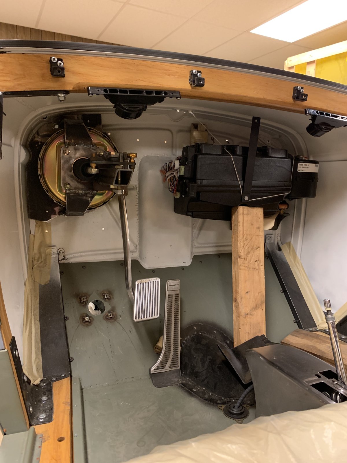

    Has anybody thought about a design to put the brake booster behind the dash rather than in the engine compartment? I'm not talking about those bellcrank arrangments where both the booster and master are there, I don't like those because of the difficulty of monitoring fluid level. Yeah, you can do a remote reservoir but cramming all that plumbing and whatnot under there is not repair friendly. Under the floor has most of the same problems plus you have a lot more parts all competing for the same space (exhaust, clutch linkage). This is aimed at the pre-49 cars, the later cars have much more space and in the case of OEM installs that's where they go. But they look out-of-place on the early cars.
    Hanging pedal conversions are traditional on the older cars but didn't have boosters 'back in the day'. I'm thinking of mounting the booster-only behind the dash, sandwiching the firewall between the booster and the master. This would require offsetting the booster to one side, also moving the master towards the outside of the car. This can reduce poor access/interference with the engine install. My avatar has a power booster, it limits the size of the air cleaner I can fit a**** other issues. You'd need some sort of linkage to do this but in the end you'd have a much more traditional looking install.
    Anybody done this? Comments, opinions?

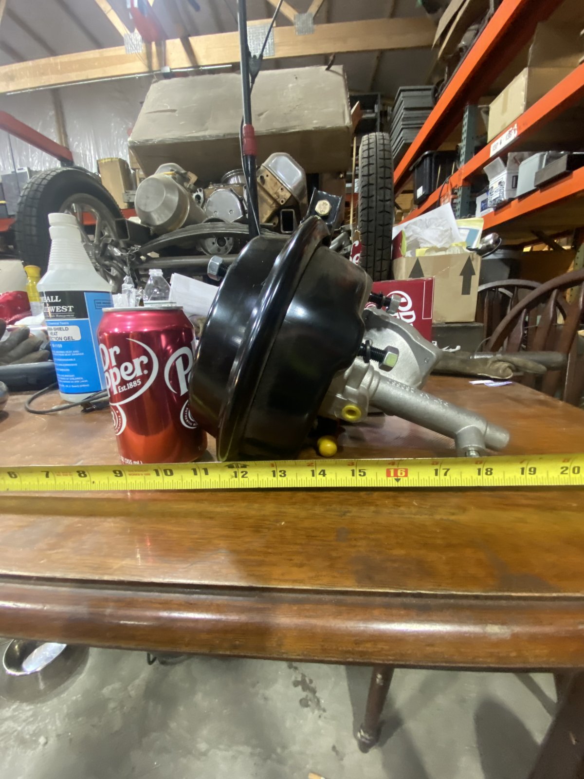

  3. Brake booster from a Geo metro is the smallest one ever and I have crammed them in a lot of places. Nothing else will fit. Available from parts chain.
    I’ve got this little gizmo I’ll be playing with. Its relatively small unit as well. upload_2023-4-22_14-41-9.png

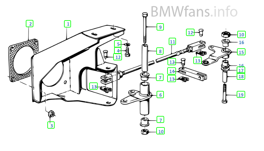

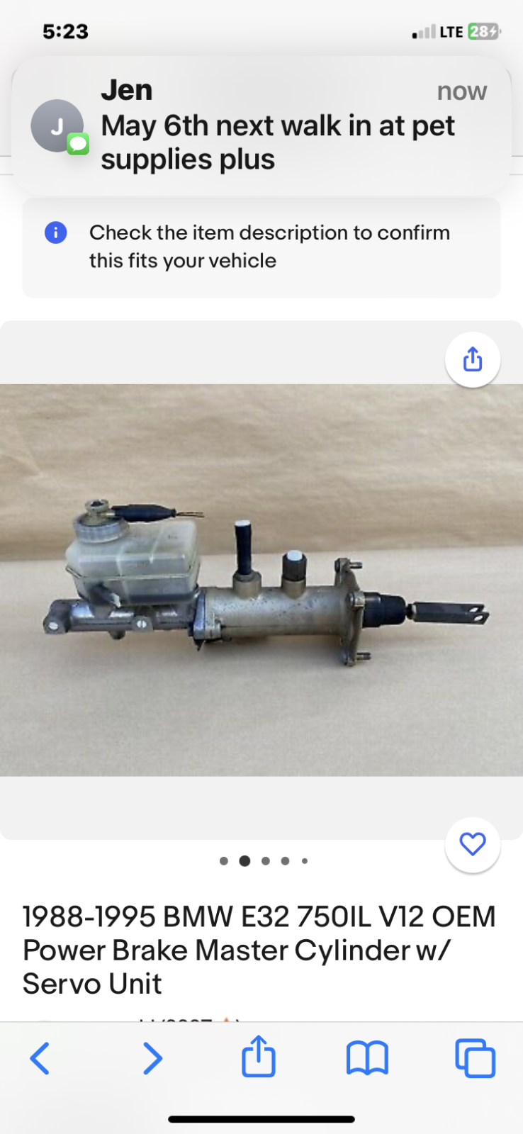

    You could do similar to what BMW did at the factory on RHD BMW E30's [325i etc]
    They had a slant 4 or slant 6 engine and there was no room for the brake booster and M/C in front of the drivers pedals [the steering column just cleared under the engine]
    BMW simply left the booster M/C in the LHD position and used a bellcrank and a pullrod system behind the dash to the RH side pedals.
    here is the BMW booster /bellcrank ***embly
    All you need to do is similar but instead mount the booster inside and M/C outside the firewall, on the opposite side of the dash to provide room [or even slightly offset]

  8. The remote unit I haven’t played with yet.
    My buddy has a 34 roaster with a remote system on it. I think it’s 50s Tbird unit. Very nice built car. He’s got a little jelly jar on the firewall, hanging pedal and the remote is back by the rear tire. That one stops great except the footwell is so small. A while back I posted up a ID request thread on it. There’s some decent pics.
    For the geo metro unit
    The most extreme tightness one I did was a 1959 Mercedes 190sl. Stuffed a big V8 in there.
    Fought like hell to get pedal ratio up to 3.99”:1 with the metro booster and master. 4 wheel disc and it stops great. Nice pedal feel to it good foot ergonomics too.
    Others I’ve done have better pedal ratio and stop good too. Seems it’s the hot ticket for the falcon crowd, that’s kinda where I got the idea from.

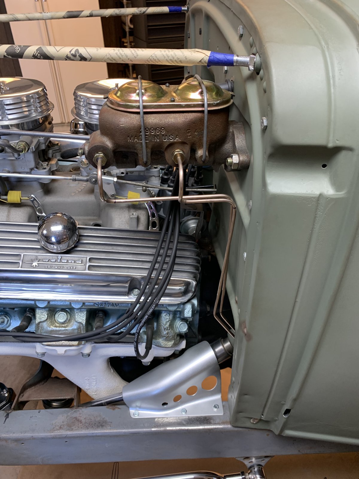

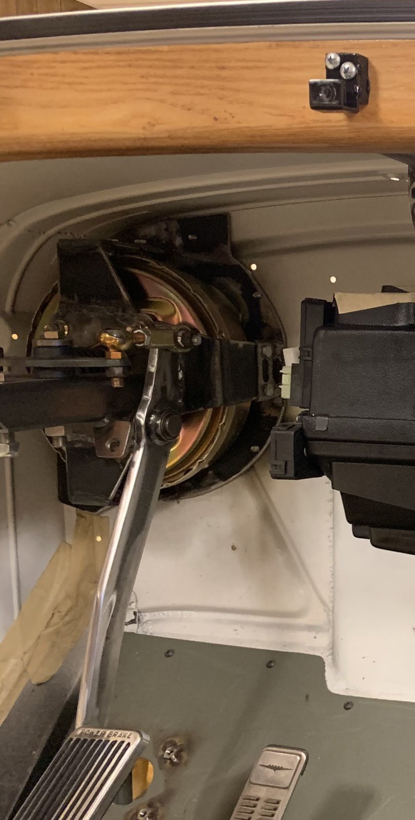

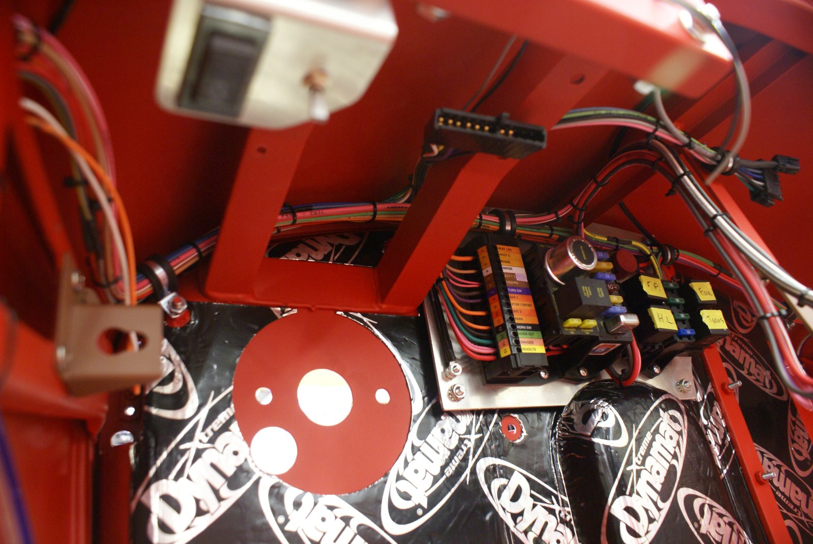

    I did exactly what the OP was inquiring about. I bought the ECI offset swinging brake pedal setup with 9” booster. I also didn’t want to look at the MC and booster hiding most of my engine, so I built a bracket to place the booster inside of the firewall behind the dash, and sandwiched the firewall between the booster and MC. I don’t mind the MC there and it is more accessible there than under the dashboard or floor. 0A02E8C4-F124-4B15-86FA-10DFB0C2D8EB.jpeg 20809299-F899-4CB3-8F80-EBB5ACFDD6DC.jpeg 177C59F5-1570-4503-B785-4B86AD2E509A.jpeg 7DC733D2-2DB0-49F7-BC64-2BE2E95FEE26.jpeg
