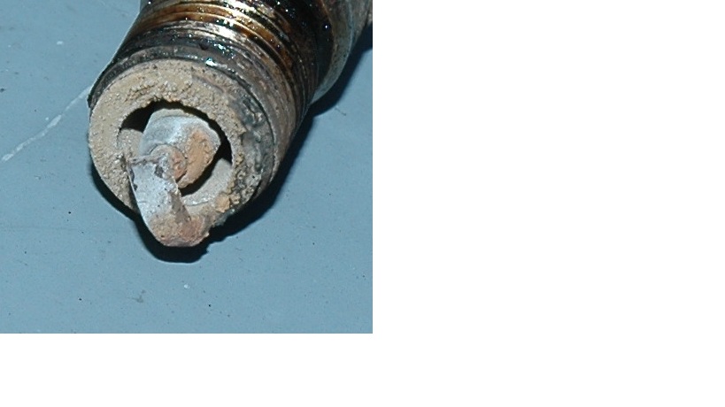

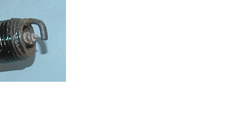

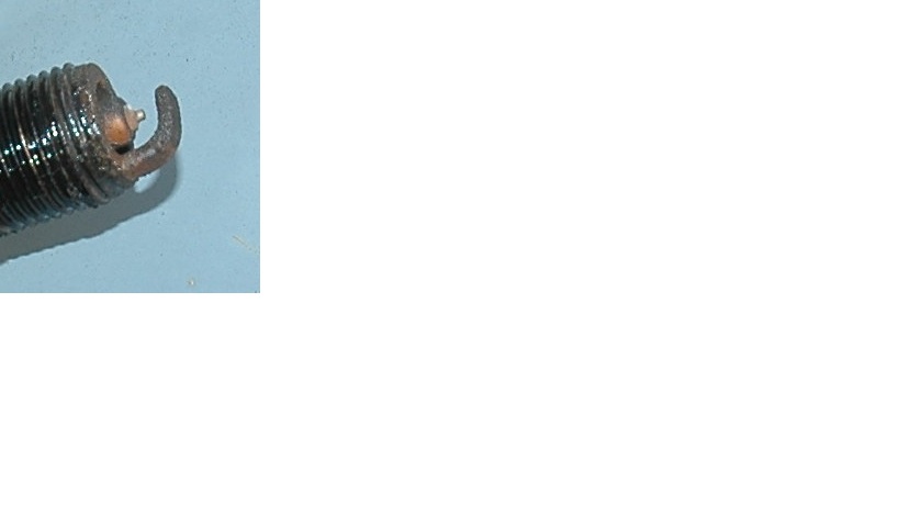

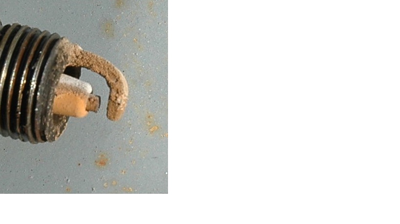

    I have a suspicion concerning my engine in my '54. I'm looking for confirmation or otherwise.
    Here are the pics from the driver's side of the "8".
    See that the discolouration is half-and-half?
    What say you?
    r
  2. are those really out of the same engine? from the same bank?
    wow
    the bottom pic plug looks like its not firing
    first and third look like too many aditives
    second plug is cooked
  3. It also looks liek two different types of plugs. Two have the little Iridium looking tips, two don't. And how many miles are on those things!
  4. Very short sentance they say "You are sooo screwed"
    What did you find out since we spoke? head gasket?

    Nothing bubbling in the radiator cranking it over.
    Haven't got it to light off out in the cold. I will put it in the garage and try again to start it, then check what's happening in the radiator if anything. There are about 3000 miles on the engine...

    First plug looks like your cooking anti-freez.. :eek:

    Two different plug types,not good on any engine,one running shitty fuel,2nd looks like fouling from oil. You got more problems than just the mismatched plugs.

    "First plug looks like your cooking anti-freez"
    My thoughts exactly.
