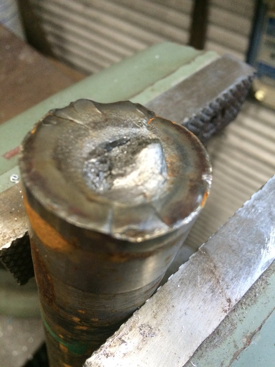

    IMG_5807[1].JPG IMG_5819[1].JPG View attachment 3293199 IMG_5819[1].JPG IMG_5817[1].JPG IMG_5814[1].JPG View attachment 3293199 View attachment 3293201 Hi all,
    I hope you guys will read this.
    NOTE!!!!!!
    The axle shaft in the vise is the Right side which is the first one to break. It has been out in the weather until today when I took it in and took the pictures.
    Also the next picture is the hub end of the axle which also has some rust on it from sitting outside in the weather.
    Sorry for the confusion.
    I need some help,
    A few weeks ago I broke the Right rear axle shaft on my 1946 Ford Kustom with a 1971 Nova 10 bolt rear axle.
    My fault...... I killed the engine and this car being new to me while coasting down the road I was attempting to find neutral and re start the engine. Well I shifted it in to Park! BOOM axle shaft broke....4 hours and two rookies tow truck drivers and then a great guy from another company got me home.
    Tonight I broke the Right axle shaft!! Not my fault!!
    I was turning Left and lightly hit the gas and another BOOM, axle broke and down to riding on the U Bolts. Having skirts saved the axle shaft and tire from rolling down the road.
    What is going on with the Left axle shaft breaking??
    Don
  2. Ill guess it broke at the same time as the other
    The trans parrking pin is Not going to break An axle either
    Have a look in there

    I think it may have started when the right broke but didn't completely break.

    Good thing is that it didn't eat up the fender. or cause other damage. Part of that axle is somewhat discolored and then there is that gob of metal in the upper left corner of the photo. I'm not sure how long you had that rear and if you changed bearings in it when you put it in but there's a chance that someone burned up a bearing on that side at sometime in it's life and didn't chew up the axle enough to have to replace it appearance wise.
    It may just be that you stressed it when you broke the other one and today it decided to **** out too.
    At least you posted a high rez high quality photo that someone with more knowledge about broken axles might be able to tell more after they save it and expand the photo.

    I am going to fathom a guess that the axles were already twisted and you stressed them with your panic stop. Luckily you had weak axles and they broke instead of the parking pawl. When you **** up the weakest link always breaks.
    my conjecture is that you bought a car that that was seriously abused or that the rear end was seriously abused before it ever found a home in that car. The old mare was rode hard and put up wet.
    I would do two things, one is replace the axles and make sure that the housing is straight.

    I posted some new pictures of the first axle shaft that broke this morning. The axle in the vise is the Right side and the first to break. It is RUSTY from sitting outside in the weather. Just took it in today from the pictures.

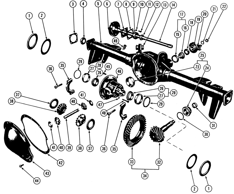

  23. Normally if the housing is off it will be a ****** to slide the axle in. I would probably be inclined go back in with new or different clips the ones that were on those axles are pretty seriously stressed. I am not normally a parts replacer, but, for me it would be cheap piece of mind. Or if I wanted to spend money I could use a clip remover kit.
    I would also take a pretty serious look at the cross shaft. Make sure that it is not galled or bent.

    What is the "cross shaft"? Do you mean the Drive Shaft? Propeller shaft?

    Why is the axle in the vice photo dry and rusty? Did it come out that way?

    The cross shaft is the steel shaft that has the other two spider gears in the differential on it, the ones that are not splined to the axle shaft ends. When you remove the axles you have to remove the cross shaft so that you can push the axles in just a bit to remove the C clips from the axle.

    Looking at the top photos it the broken axle is part way into the bearing but the outer part still has over an inch of axle. Maybe the axle was already riding out before it broke.

    The new picture of the broke one, by the rust in the break it was broke long before you had a problem.
