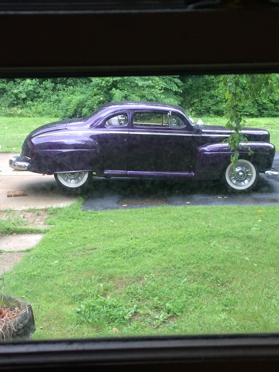

    OK Mr. Newton, I am getting very tired of your condescending remarks.
    I posted how the car was on a Jack Stand on the Right side and the Left tire on the blacktop driveway. No not sunk in to the blacktop.
    This was the first time I have any experience with a C clip axle.
    I am a AMC and Chevrolet guy.
    Retired production manager from American Motors.
    See the pictures, if you must, of how the car was sitting.
    The next day the C clip was on then bottom of the center housing, pumkin.
    My thoughts were that the car, BODY, shifted on the rear axle. It is tied, bolted, to the rear axle.
    Now remember the center pin is out of it's position, removed to remove the broken Right side axle shaft, leaving the
    side axle shaft free to move. Leaving the body free to slide to the Left and expose the C clip groove in the axle shaft.
    That's what I think!!
