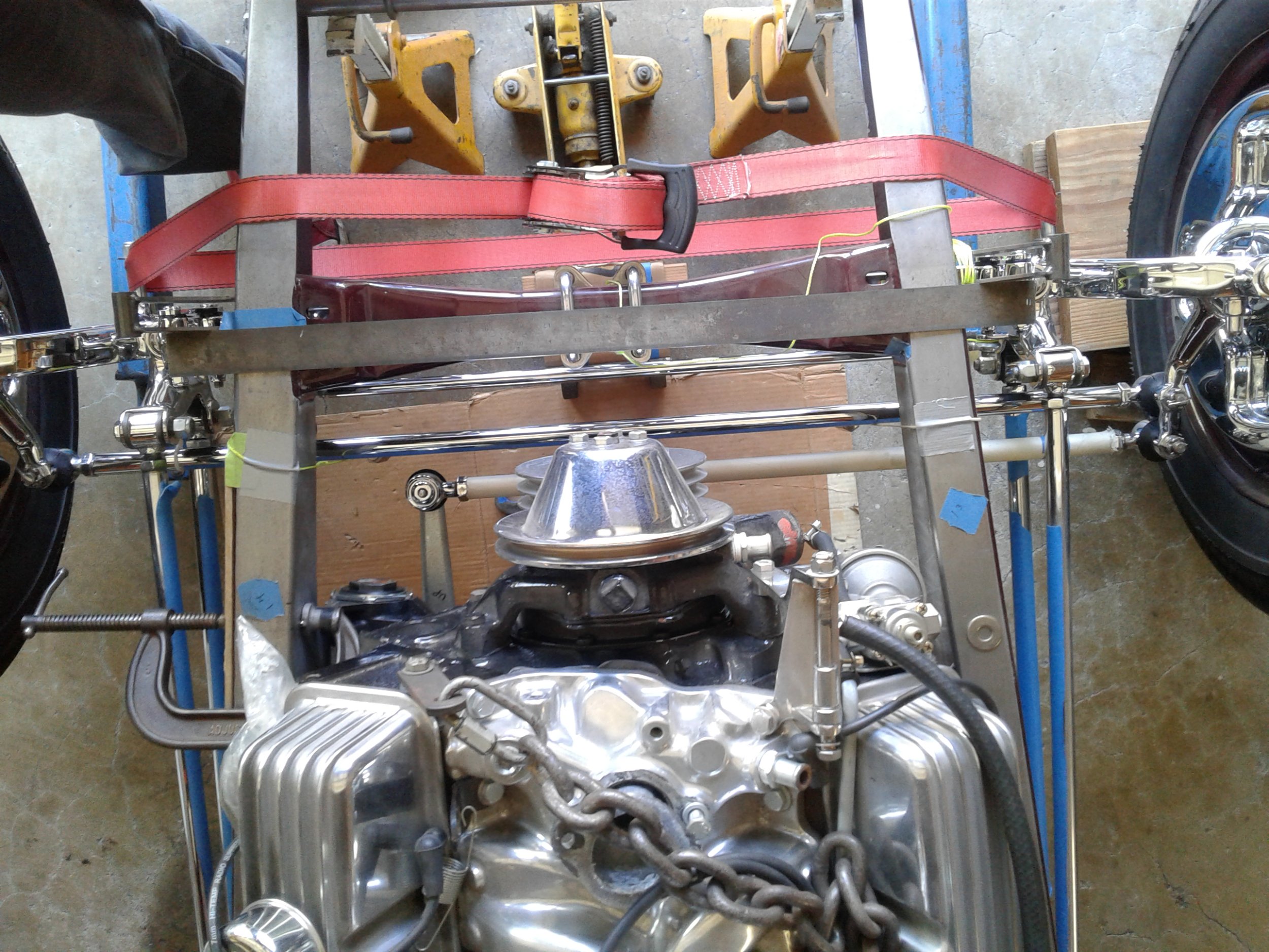

    I am at the point that the steering box needs to be mounted. I have read a lot of threads and read and re-read instructions from Pete & Jakes. Pete & Jakes says the drag link needs to be 1/2" to 1" above the tie rod. In other words at a slight angle to the right steering arm. Most of what others say is to keep the drag link on the same plane as the tie rod. Also, that there needs to be a minimum of 1/2" to 6" maximum clearance from the Pitman arm to the tie rod.
    I looked at a lot of 1930-34 Ford coupes at Lone Star Roundup a couple of weeks ago and many had the drag link on the same plane as the tie rod. Clearance from the pitman arm was almost the same as the drag link all the way to the steering arm. Some were just as described by Pete and Jakes.
    Those of you that have done several of these, what do you think?
    Thanks

  9. Crew Chief
    Joined: Jan 28, 2020
    Posts: 144
    Crew Chief

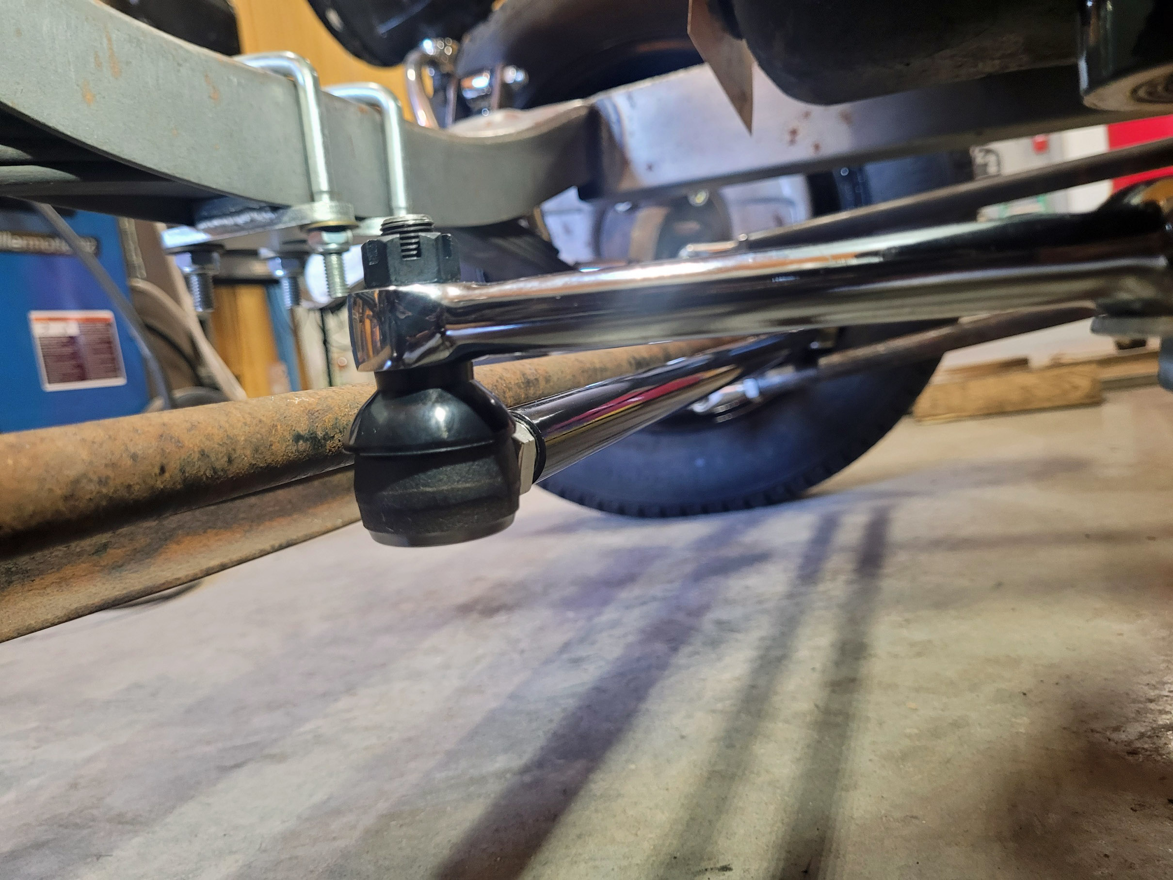

    What do you all think? Too low? I have the steering box tack welded just in case I need to make another adjustment.
  10. alchemy
    Joined: Sep 27, 2002
    Posts: 23,043
    alchemy
    Yes, too low. The car will settle a bit more as you drive it, and the drag link will be even farther below the tie rod.
    Crew Chief and panhead_pete like this.

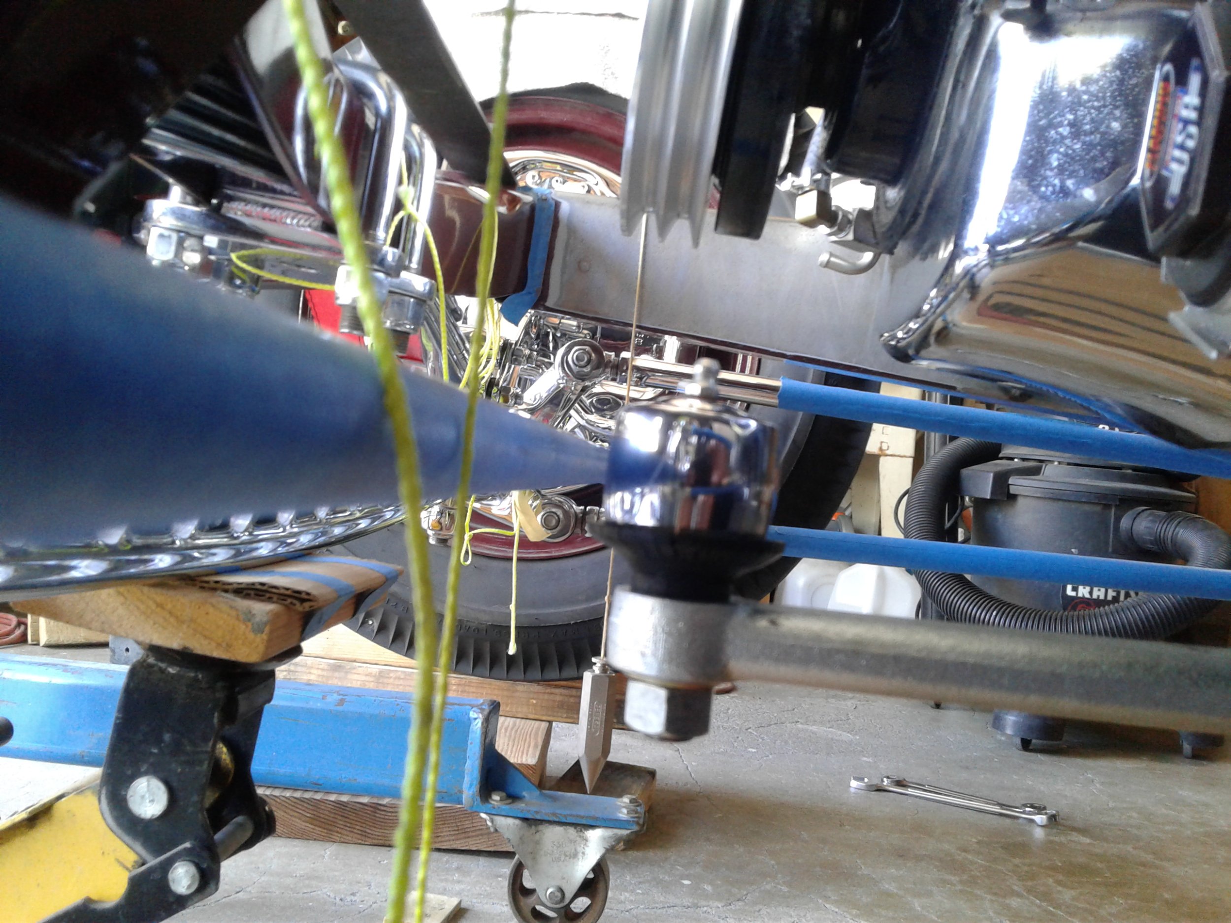

    Mount your box so the drag link starts out about 1.5 inches above the tie rod. on the left side with no load. It should be just about right with the engine & trans installed.

    Did you flip the tie rod on the pitman arm to go on top and leave the one on the steering arm on the bottom of the arm? If you did, does this effect anything? I have mocked it up that way and it is much easier to line up instead of having both tie rods on the bottom. I have notched the mounting bracket on the box and slightly knotched the motor mount bracket and can barely get the pitman arm side lined up where it needs to go. Going this direction makes the mounting bracket stick up above the frame about an inch. It don't look right. I have a Boling Brothers aftermarket frame for a SBC. I am afraid to make the knotches deeper for fear of losing structural integrity.
  17. tomcat11
    Joined: Mar 31, 2010
    Posts: 1,186
    tomcat11
    Yep. Drag link end is on the top side of the pitman arm and on the bottom side of the steering arm. The tie rod ends are also on the bottom of the steering arms. I don't see any issues with it. The only issue I found was at nearly full lock my tie rod hits the Panhard bar mounting bolt (left side) just before it is supposed to hit the stop in the axle. I'm going to countersink that bolt head.
    Crew Chief likes this.

  19. Crew Chief
    Posts: 144
    Crew Chief
    My steering box can go up another 1/2 inch but not necessary because the lowest point of the car is the front axle and the oil pan. I think I will leave mine like TomcatII.
