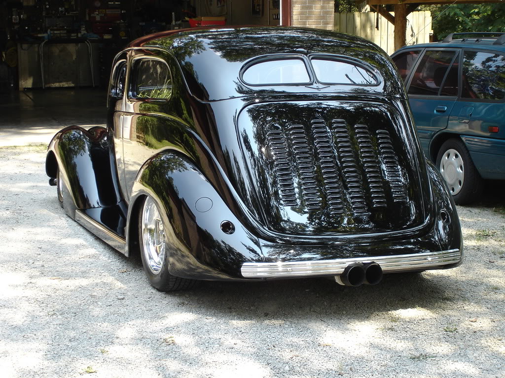

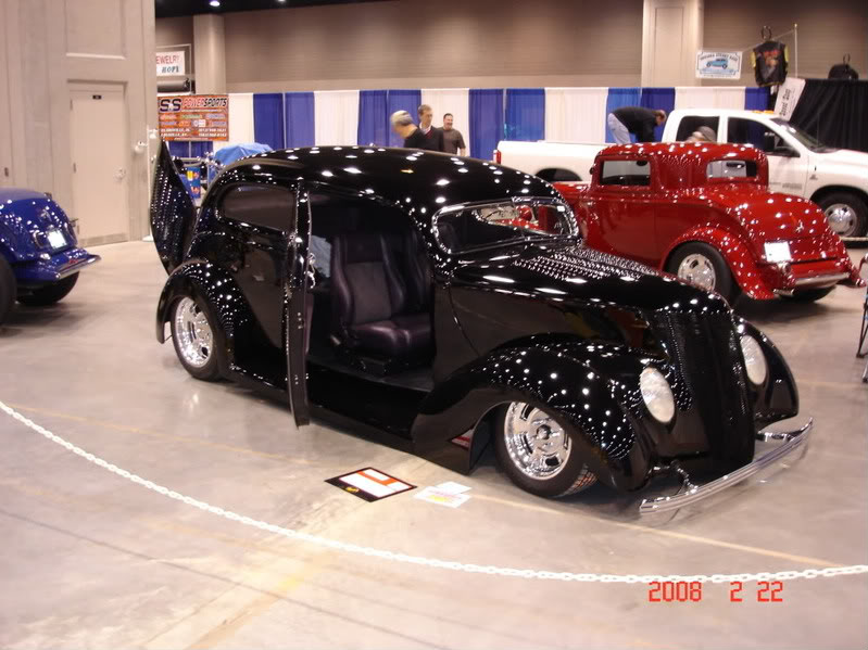

  5. My car pictures and two post back. Thanks
  6. Got to love the club, LOL .. thanks for the 2 cents worth there Jeremy..great ideas, and I have been kicking that around also. I spoke to Pat at Real Rodder (nice guy)today.. I received some good info, 15 x 5.5 out front, and he recommends a 15x8 in the rear.. Right now running 3" back spacing up front and the rear are 4" back spacing.. He said to go 15 x 8 with a 4 5/8" back space.. Tires, Firestones for sure... Cheater slick maybe not... I want to drive the snot out of it and have fun !!

    Here's the pics.

    Thank you man! I remember your car in Street Rodder.....totally bitchin'
