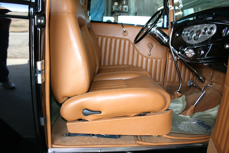

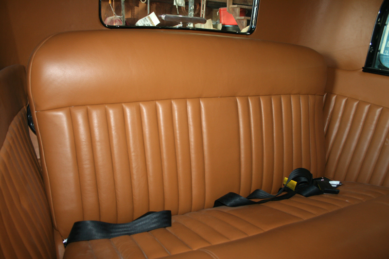

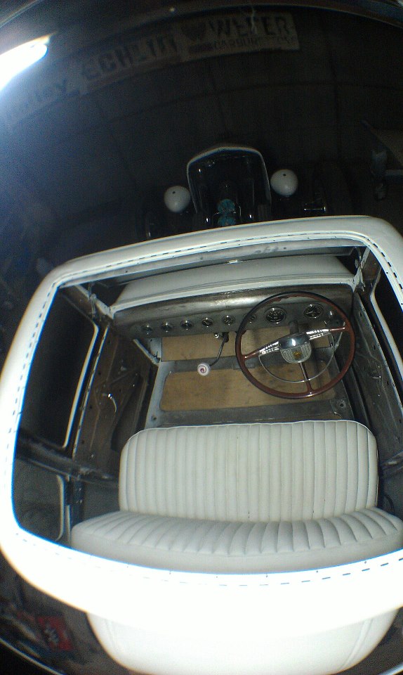

    Hand stuffed by the MR's. The coupe will get the full treatment when i am done with the house.

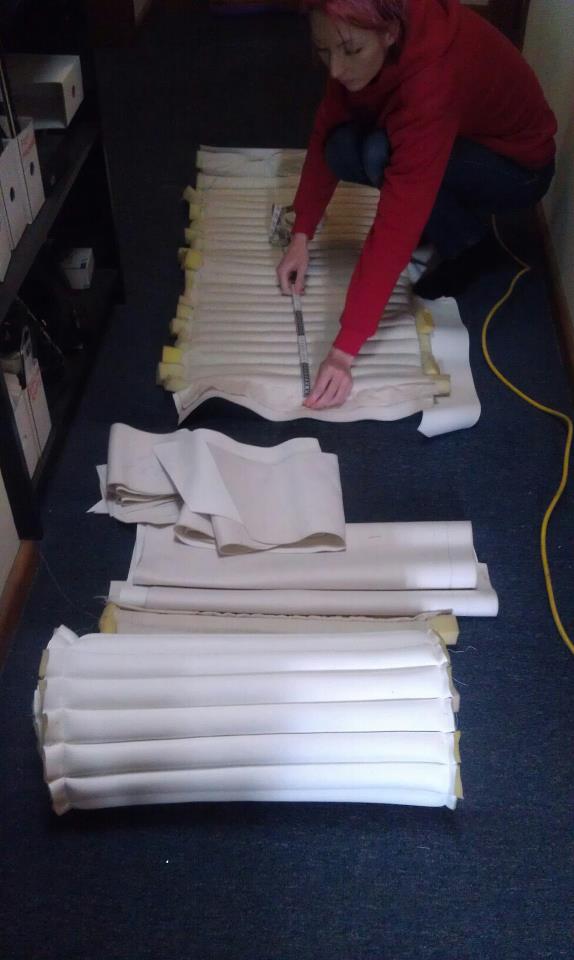

    Falcongeorge, you can see on Humanfly's excellent last photo the rolls with the stuffing sticking out both ends. Looks like the ends have been sewn closed afterwards in the photo.

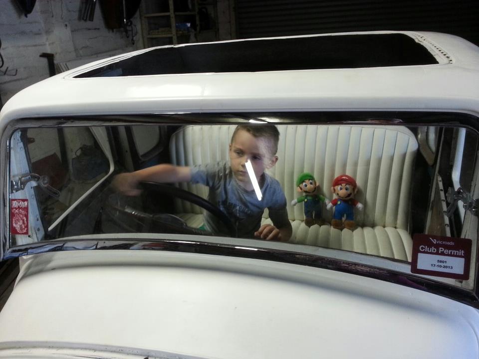

    I did make note of that. Human Fly, what kind of sewing machine did you use?

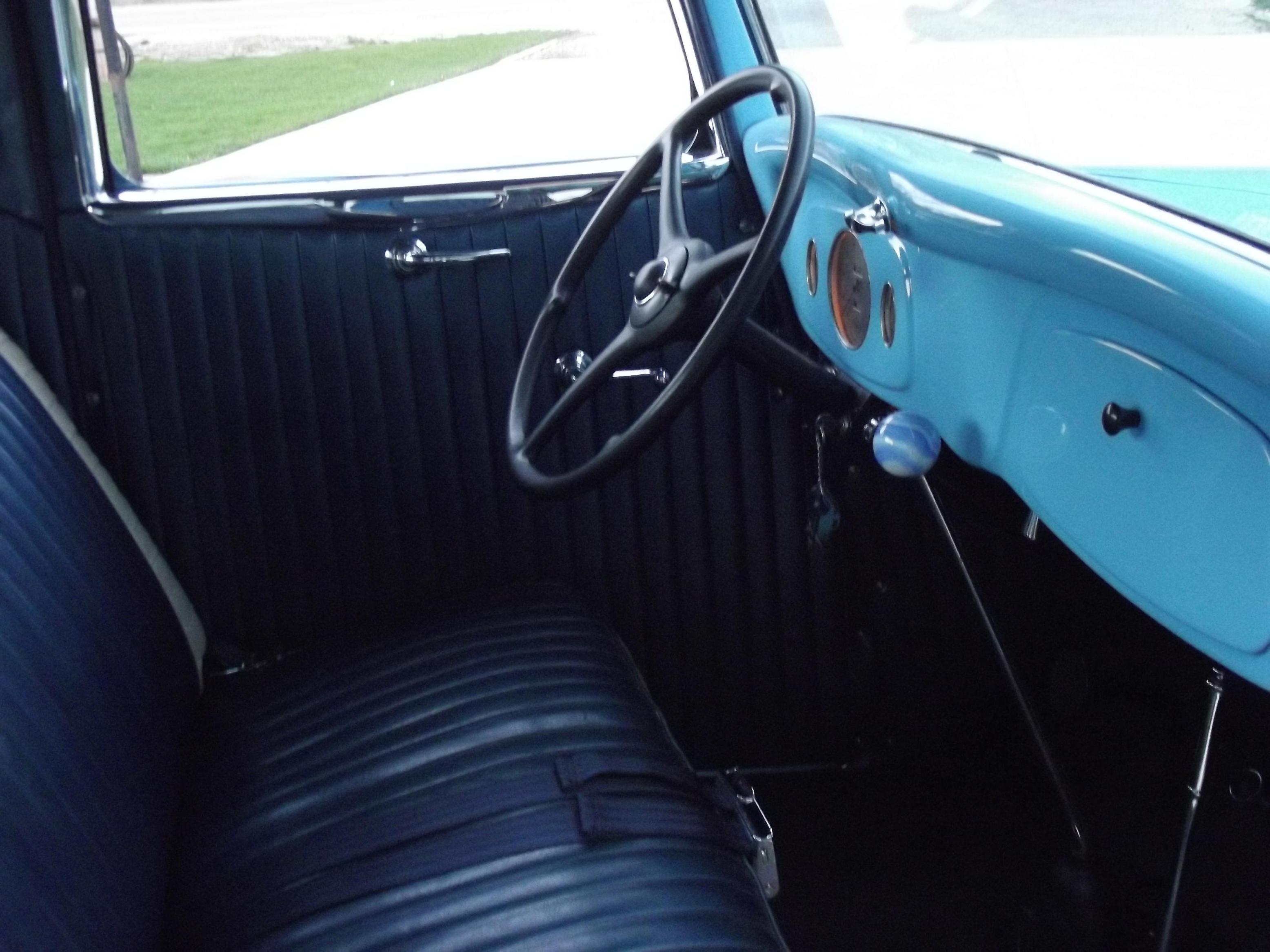

  25. When I built Little T for parades and car shows I s***ched up diamond pleats.
    Someone asked about what machine someone used. I purchased my Consew forty one years ago so that I could upholster the sidecars that I manufactured. Still have it and use it on whatever project I'm working on. I don't confess to be a professional upholsterer but it saves me thousands of dollars being able to do my own work.
    This shows the french seam in the lapel.
    I had planned on using a red welting but the material that I had didn't have enough pull or stretch to it and I couldn't get it to work so I went with blue.
    This shows the s***ching using a backer and foam.

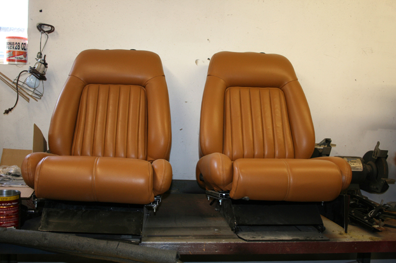

    Here's some pix of a recent '50 Olds project. The package shelf and door panels are the "fold and sew" variety while the seats are individually stuffed pleats. This gives a higher crown to the pleat and hides the s***ch line deeply into the pleat.
    Sorry about the quality of the pictures; it's my ****py cell phone... :eek:
