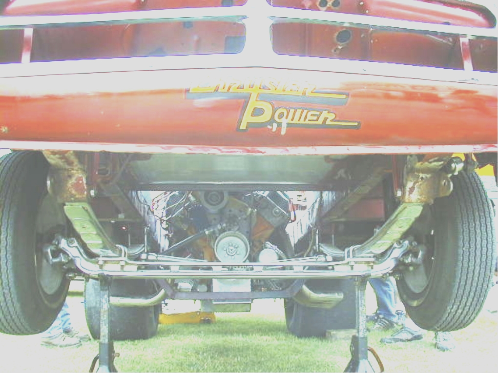

    However, they are also a weak point on the build. I've seen many wheelstanders and not all the runs are picture perfect. Please learn the ropes with some strong front wheels before or instead of hanging those in front. I doubt they will like repeated drops with the weight you have going and the height you are planning on.
    Kinda wonder about the drilled axle too. Pretty as heck, but when dropping at least a thousand pounds from 5-6 feet, it will be experiencing some big twisting forces, especially when it's not coming down straight.

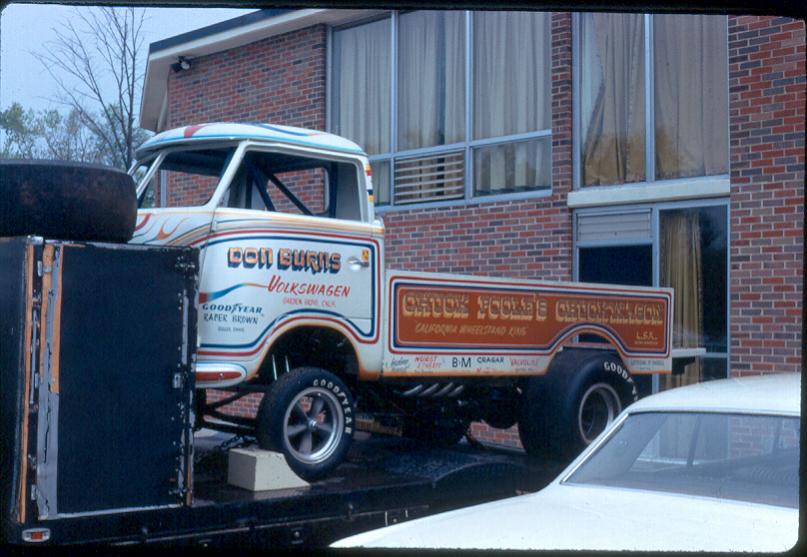

    Hello again.I read some consern over my choice of wheels up front.And I will inform you that I have none.I have looked for years to find those mags and will use them as intended RACING.Many wheelstanders have used over the years, Chuck Poole (Chuckwagon) comes to mind see photo he used them for a decade or more.And actually eliminating the heavy steel factory hub and hanging a wheel and tire will be better for the spindle and king pins.
    The axle is of no concern either,Maverick and BoB Riggle(Hemi under gl***) have always used Dodge axles with the centers cut out with slots holes, or otherwise.Over 4 decades of testing I think I can trust an a100 axle with a few holes in it SEE photo

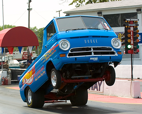

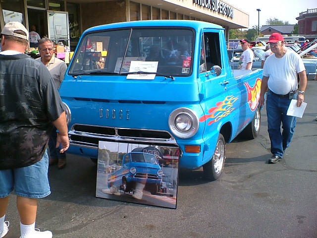

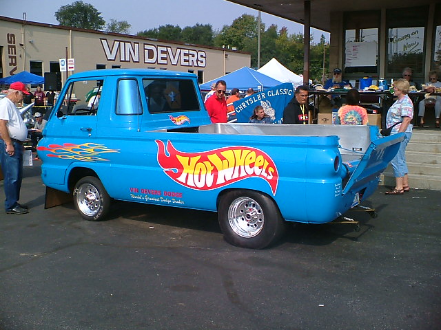

    I really like the look of your truck! Here are some photos of my friends Hotwheels Truck. Done much in the style of the Little Red Wagon but running a 440 instead of a Hemi. The photos show the motor when it ran a older Hiborn ijection system, it nows runs a 8-71 blower. The wheelstand picture is from Milan Dragway at the Pinks all out TV taping. He made the show but just a very quick shot. Mel:D

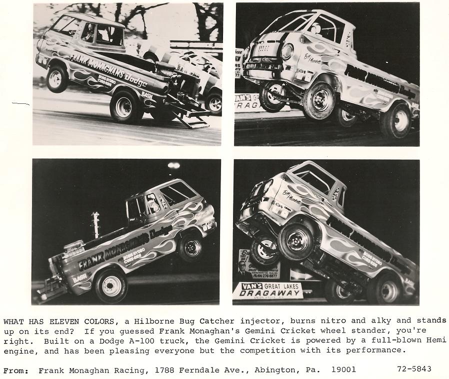

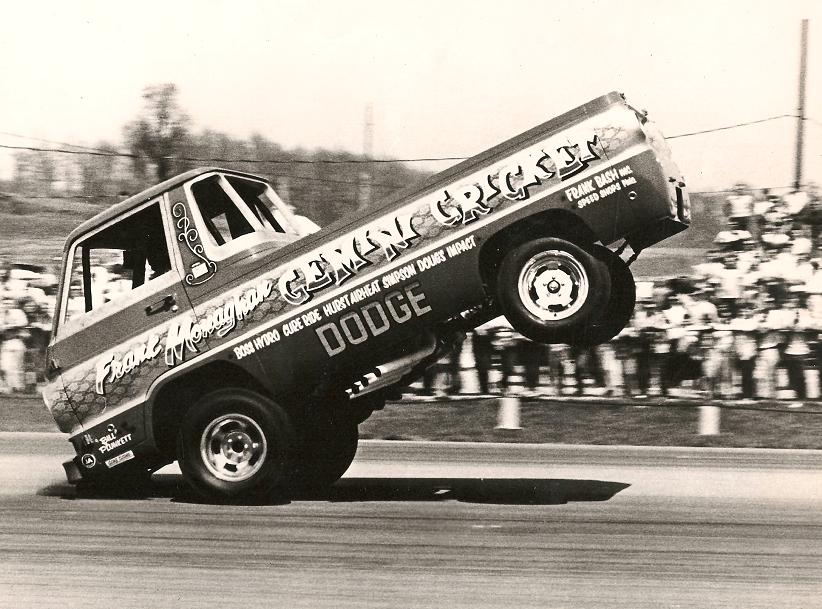

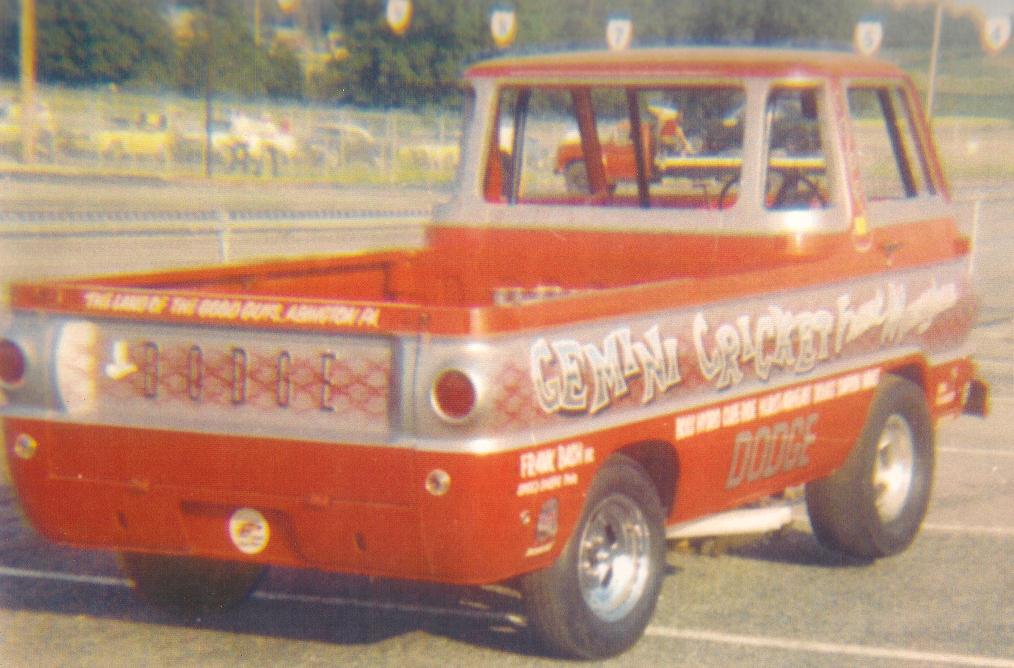

    where in PA are you located? Two of my best friends **** Belfatti (trick truck) and Fran Monaghan (Gemini cricket) were a**** the wheelstand legends, both are still around and would most likely love to give you some tips or tricks or just to talk BS! I will put a few pics up from my collection of hand outs that they gave me for some inspiration! some of the stories they tell are almost un-imaginable but true, they were nuts, lots of rivalries back then with who could run the longest wheely.
    there are pics of Frans ride with a blown hemi and forward facing wheely truck and with the injected hemi when he spun the truck backwards. the last incarnation of his truck was the blown one and he put the seat/steering & cage in the middle of the truck like you have yours. **** ran a injected 402 chevy. I found the trick truck for **** back in 2001 but it had been cut up over a brotherly dispute over ownership?
