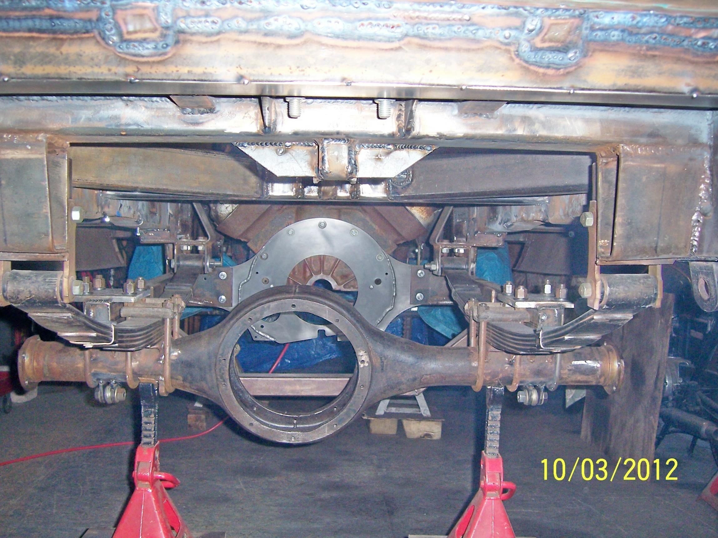

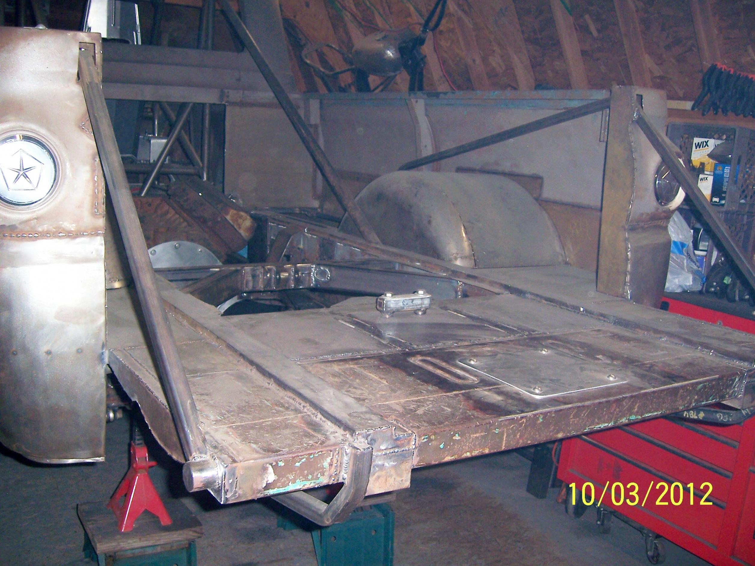

    Hello once again,I have some new pics as of tonite.Progress is slow but steady,but progress one the less.actually some big additions sine the first photos I posted.Pics should show finished tail gate supports on the ends,parachute mount(can pic whole truck up with that mount)lots more 1/2 inch plate installed gate to rear crossmember,wheelie bar bellcrank mount more steel and gusets, tubing from wheelie bar shock mounts to frame,finished end of gate.
    Big additions of anti rotation/traction bars to subframe and you shold be able to see how big the rear end actually is( empty motor sitting in truck is mock up/spare block and heads
    Good Day Chris

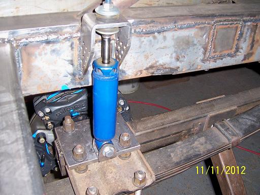

    Hello fellow hot rodders,it has been a while,as real life has been kicking my a##.Alas we soldier on as the English say.Here is more progress.
    Anybody here like disc brakes?The front and rear calipers are for steering and the top caliper is the separate foot operated brake system.All calipers are 4 pistion 1 3/8th bore,6 calipers in all rotors are 12inch vented cast iron,all brackets are custom.
    Rear shocks are front shocks are mustangII and as per application all brackets are hand built and started life as flat 1/4 inch steel.The rear half of the spring is the only part of the sping that works.Questions feel free

    Very interesting thread, Seen these things run a bunch of times never relized the thought that has to go into it,, When you say only the rear of the spring works what do you mean? Might be a dumb question but that never stopped me before, Tim Jones

    Hello,I am still on line so I will answer your question.The rear susp. consists of a left and right leaf spring,the engine and drivetrain sit in a subframe.The trans, is direct coupled to the rear via a single u-joint.
    The sub frame is suspended under the frame of the truck with 2 one inch bolts that pivot as the susp. moves up and down,but since the rear of the subframe is bolted to the rearend at the same point where the leafs are u bolted to the rear and the shackle is on the rear of the spring the front half of the spring can not compress or rebound just move in an arc.
    Leaving the rear half of the spring with the shackle live to move freelly as a normal spring about 3/4 to 1 inch up and down.It is not as confusing as I made it sound.
    Chris

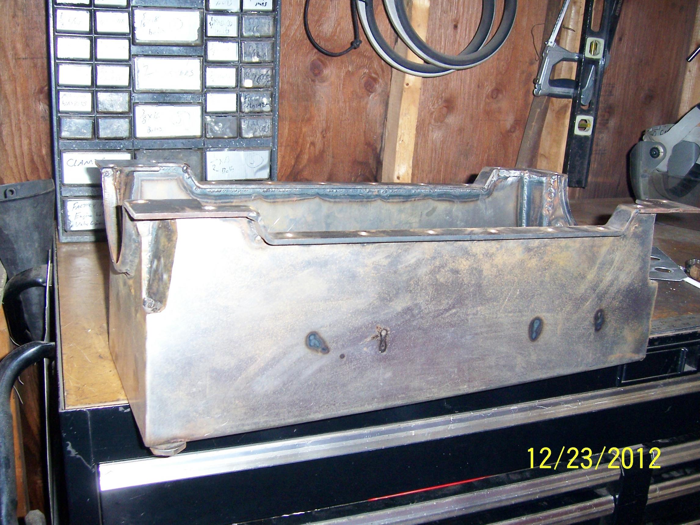

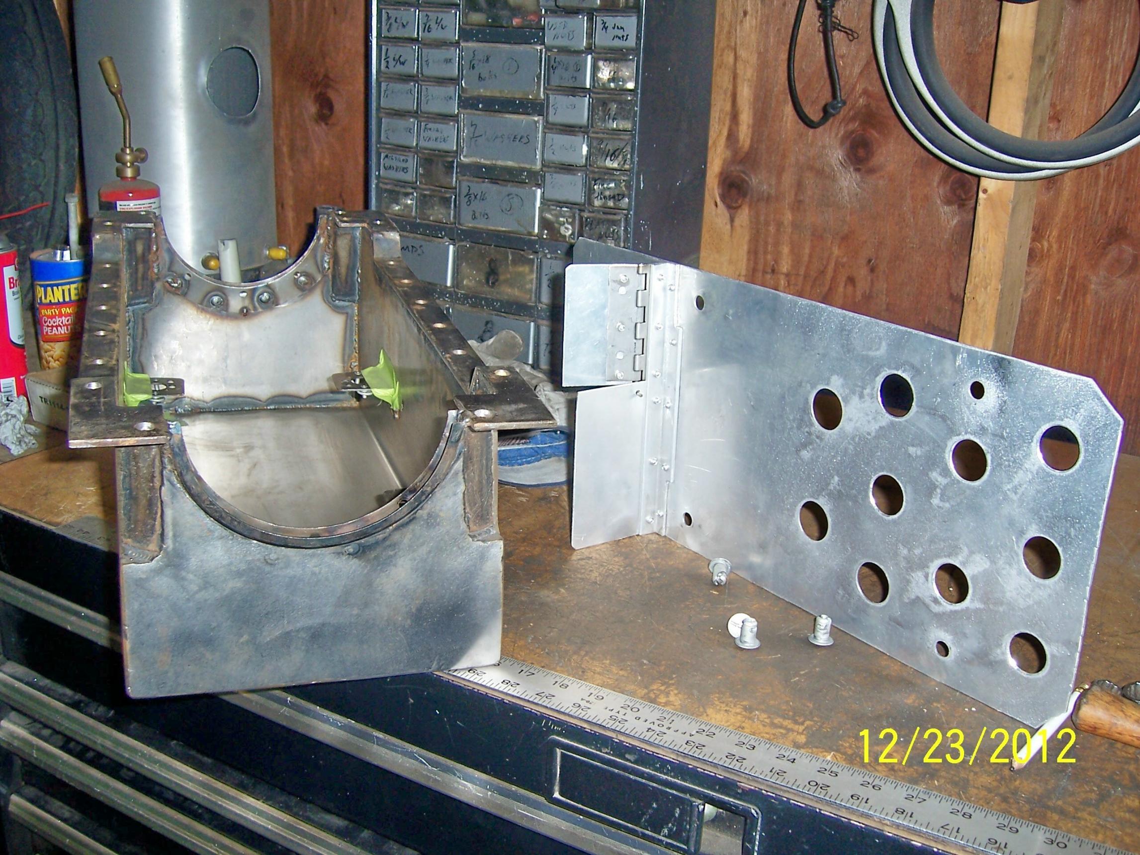

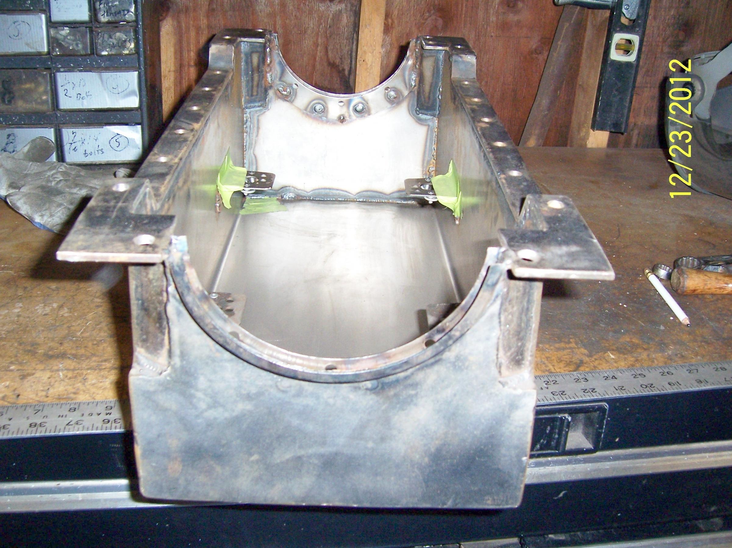

    Hello fellow hot rodders,it has been a while since last posting.As since I have started a new job and have been adjusting to it,but all is well and I am now getting started back to working on the dodge.
    Past 3 weeks building and finishing my oil pan,from ****ch. Pan is 16 gauge steel with 3/16 rails and 7/8 drain plug.It holds 10 quarts ,It also has a removable aluminum windage tray with built in trap door to shield pump. cutouts on the sides of the pan are for the milodon main gurdle.
