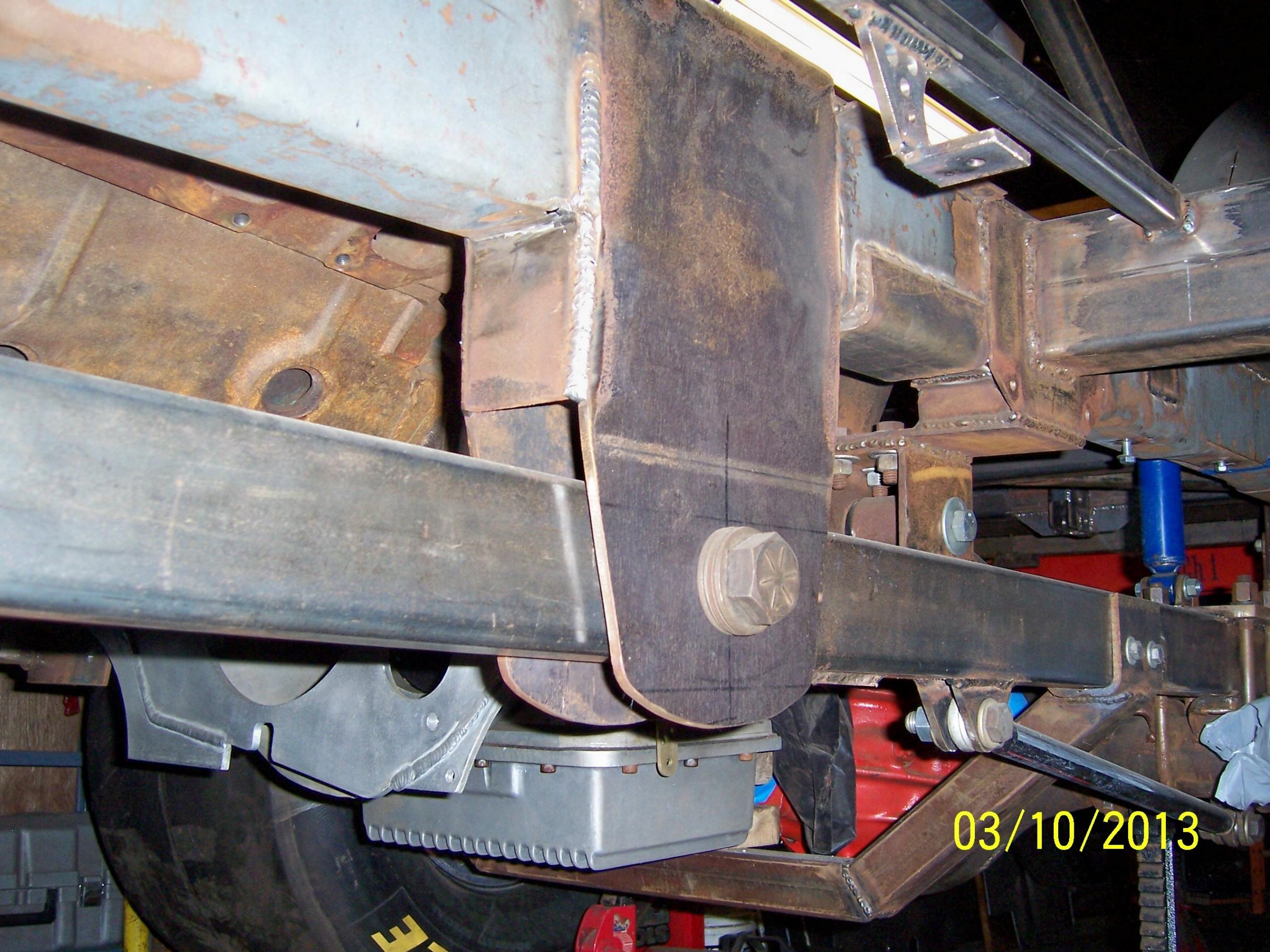

    Could you by chance take a picture of the pivot for the swing arm the drive train rides on?

    As for the bed floor I made a decision and bought two 24''x51'' replacemet bed panels for a 70s blazer,cut it to size and welded down the middle.Looks like it was always there.And yes I hope to get out there and take a few pics and to the gentlman who would like a pic of the subframe mount I will take one of that also.

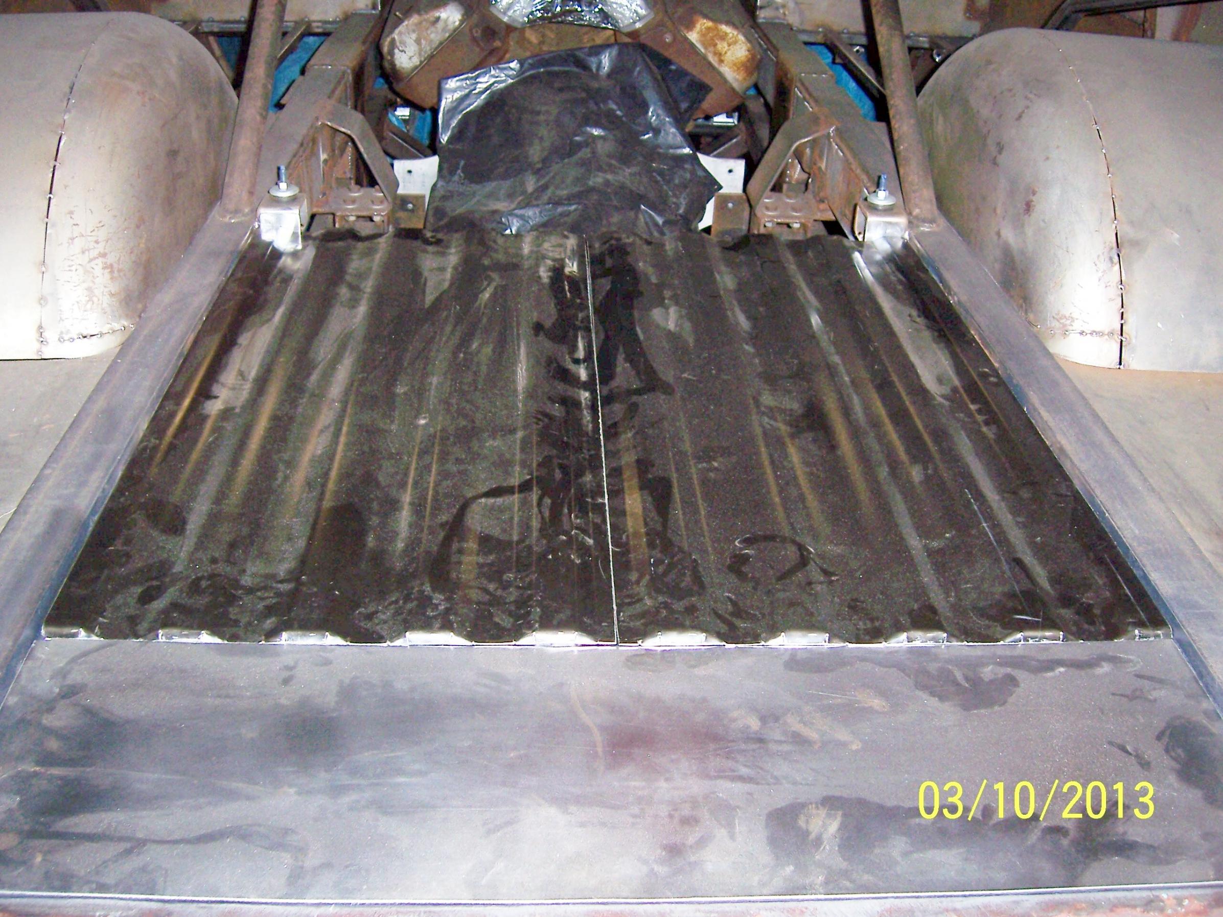

    Hello once again, here are 2 pics since I did nothing to it this weekend as I am really feeling better and do not want ruin that.
    First is the bed floor, the seem in the middle will be welded and smoothed and still have to drill holes for the chute mount,spacers welded underneath under center 2 ribs. The second is of the subframe mount on the left side, all brackets are of 1/4 inch steel,pivot bolts are 1 inch dia. Subframe is 1/8'' wall 2x3 steel tubing,pivot holes are 1'' ,sleeved and have 1/4'' plates welded to each side and on top.

    awesome build, thanks for educating us on the way these thing are designed. I for one, love the close up pics of the rear suspension/ motor set up and never new they had a pivot point.
