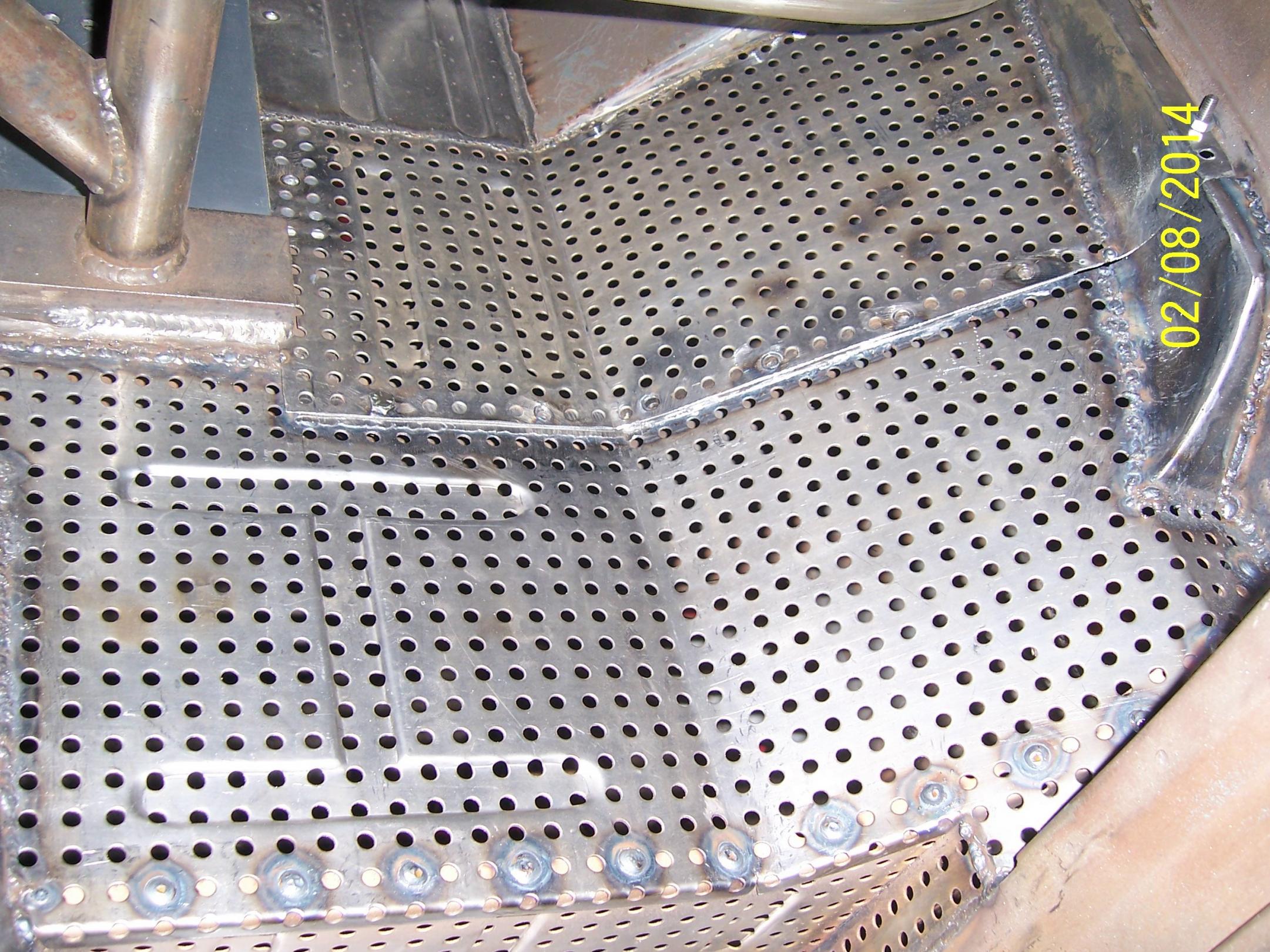

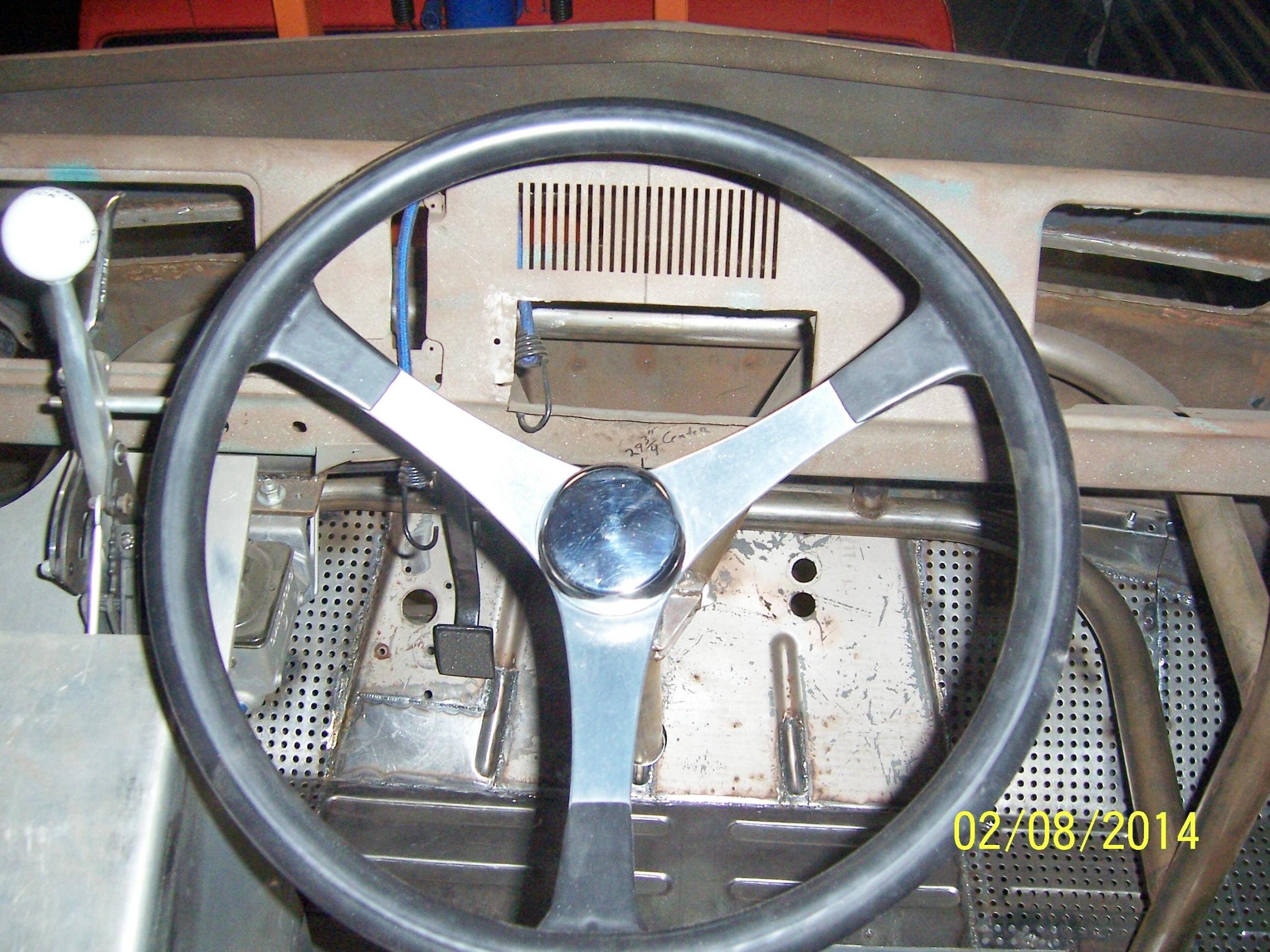

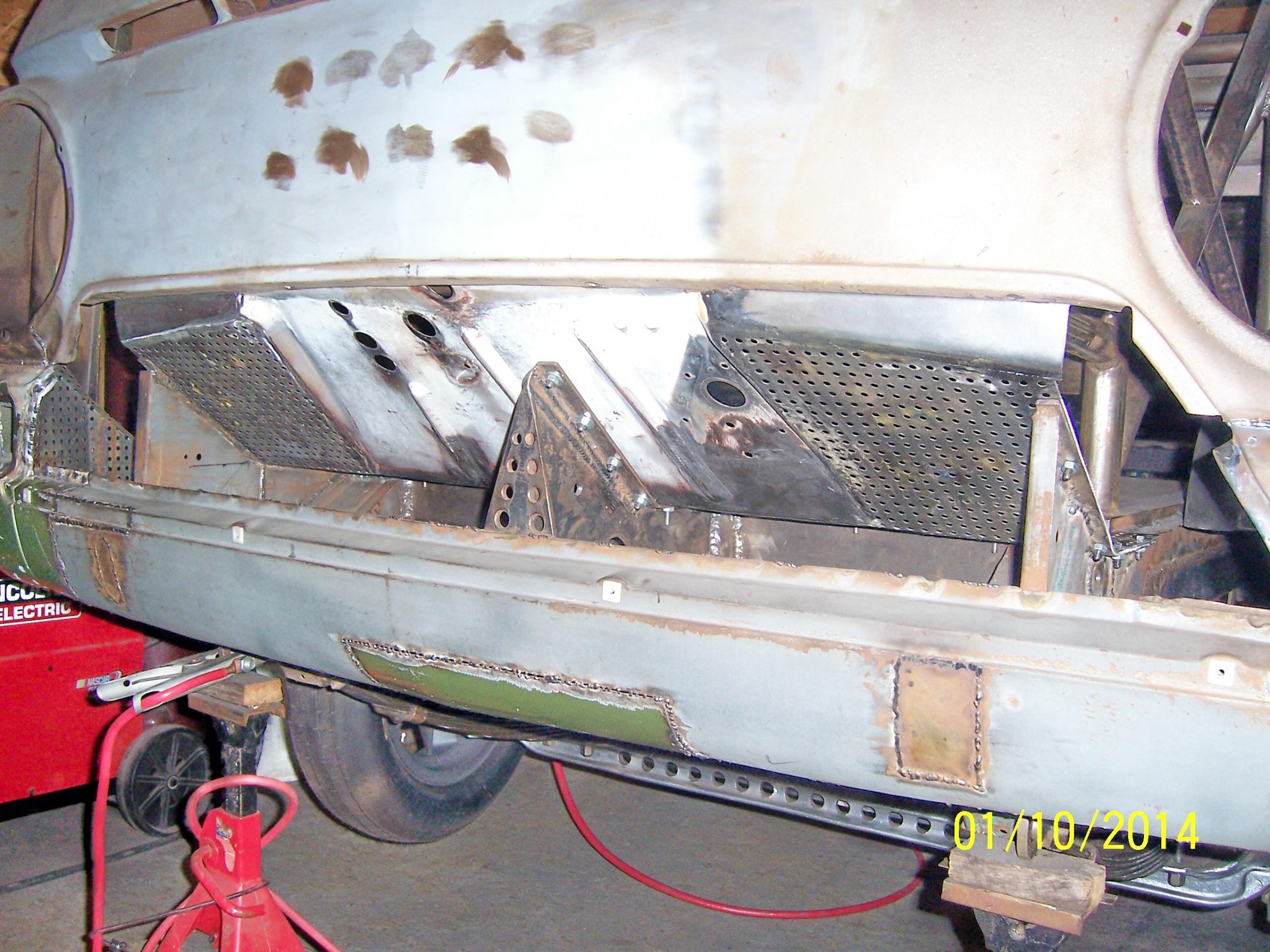

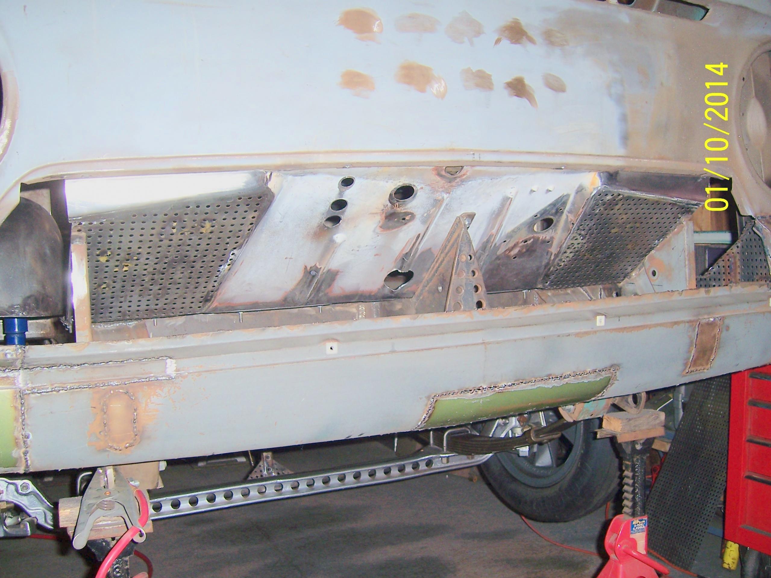

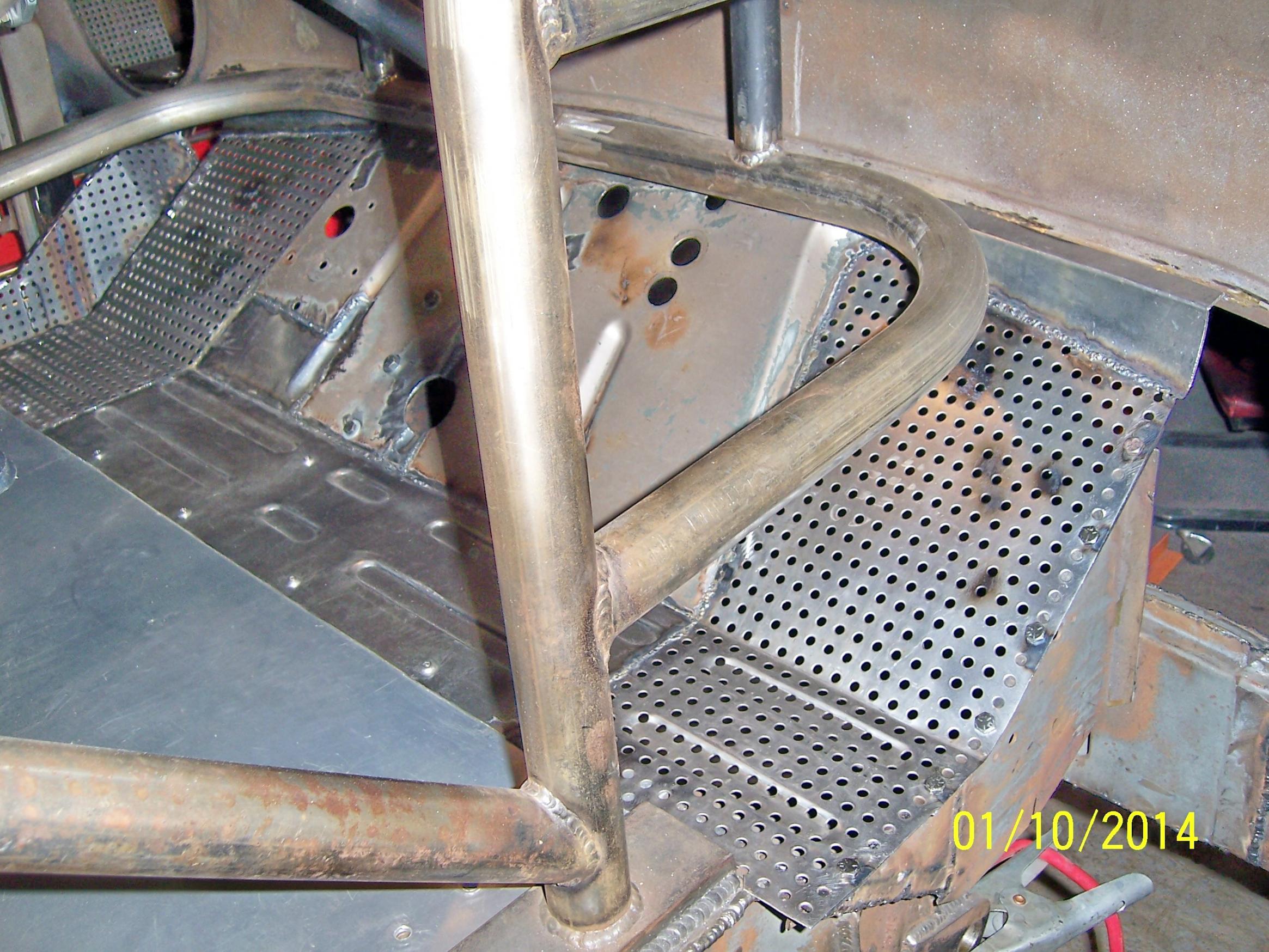

    Evening all,I just figured I would post a new picture or so of my very slow,but very good progress.A while ago I put up a pic of the aluminm front floor(toe board)and will post it again for comparison,to my new front floor.A fair amount of work went into to the first floor and at the time I thought it is was brillant,now the more I looked at it, the more I despised it's very exsistance.
    So I built in my eyes the best floor that more fits the aesthetic of the truck.the center is original A100,more like 80% of A100,sourced from another van,reshaped,and fitted,and having to replace the 3 ribs,(rotted).The floor panel is 16g with my own stamping done like the factory,and the perf. is 18g stamped.Floor is bolted in at all 4 sides ,comes out through grill.Dark spots on perf. is from oil can removal.Also had to cut and change the angle of the top of steering box mt to accomodate the rise in the center,toe board is actually 5 inches farther farword than factory for more leg room.
    Chris

    The front floor is now finished less some finish weld grinding and sanding.I think it turned out very well and looks like how I invisioned it,strong,light,looks factory and all the holes make it faster:D
    Also I have included a pic of my new wheel,17 inch Howe aluminum ,now will be moving on to finsh welding in the panels behind the front wheel wells.
