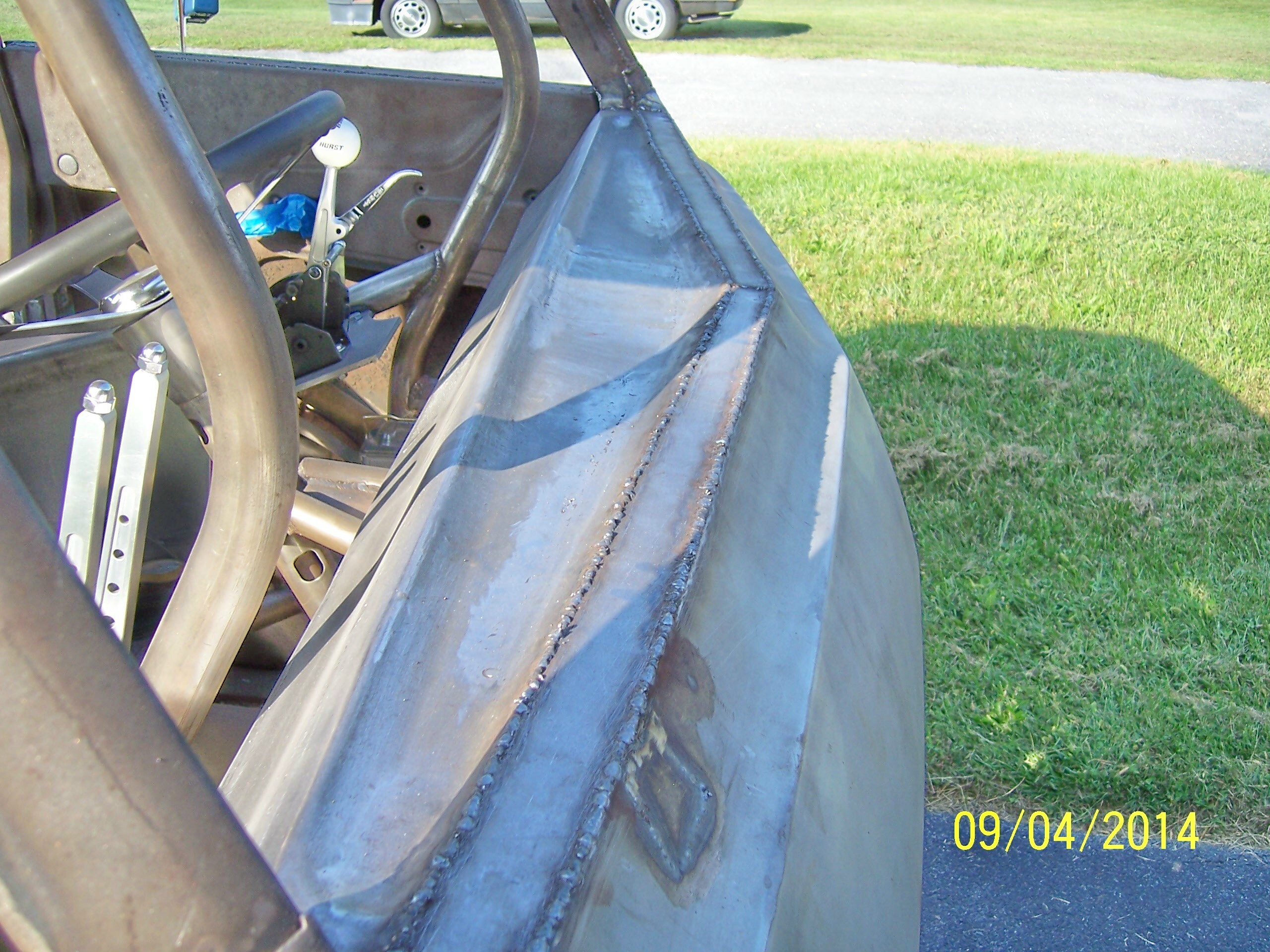

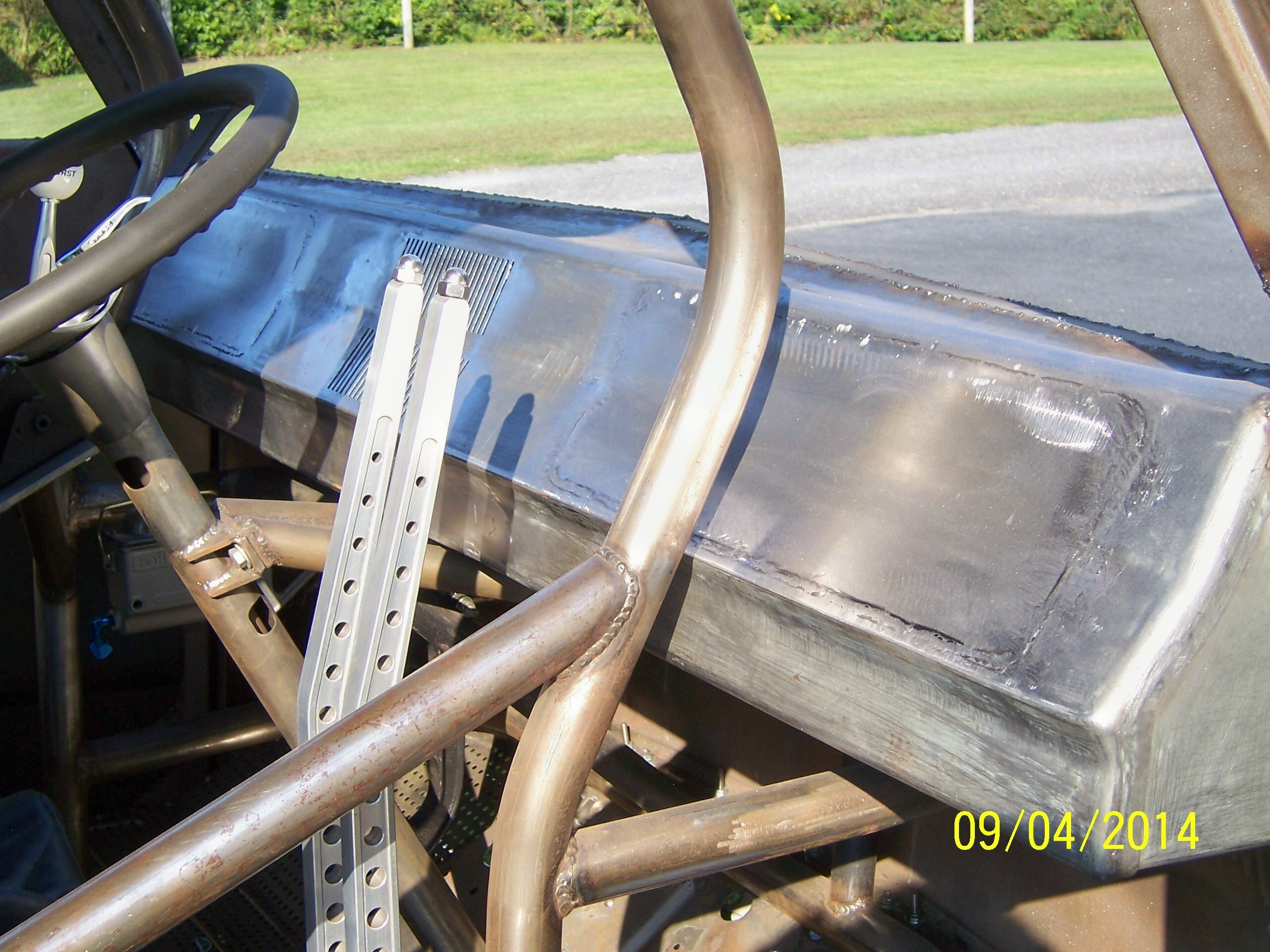

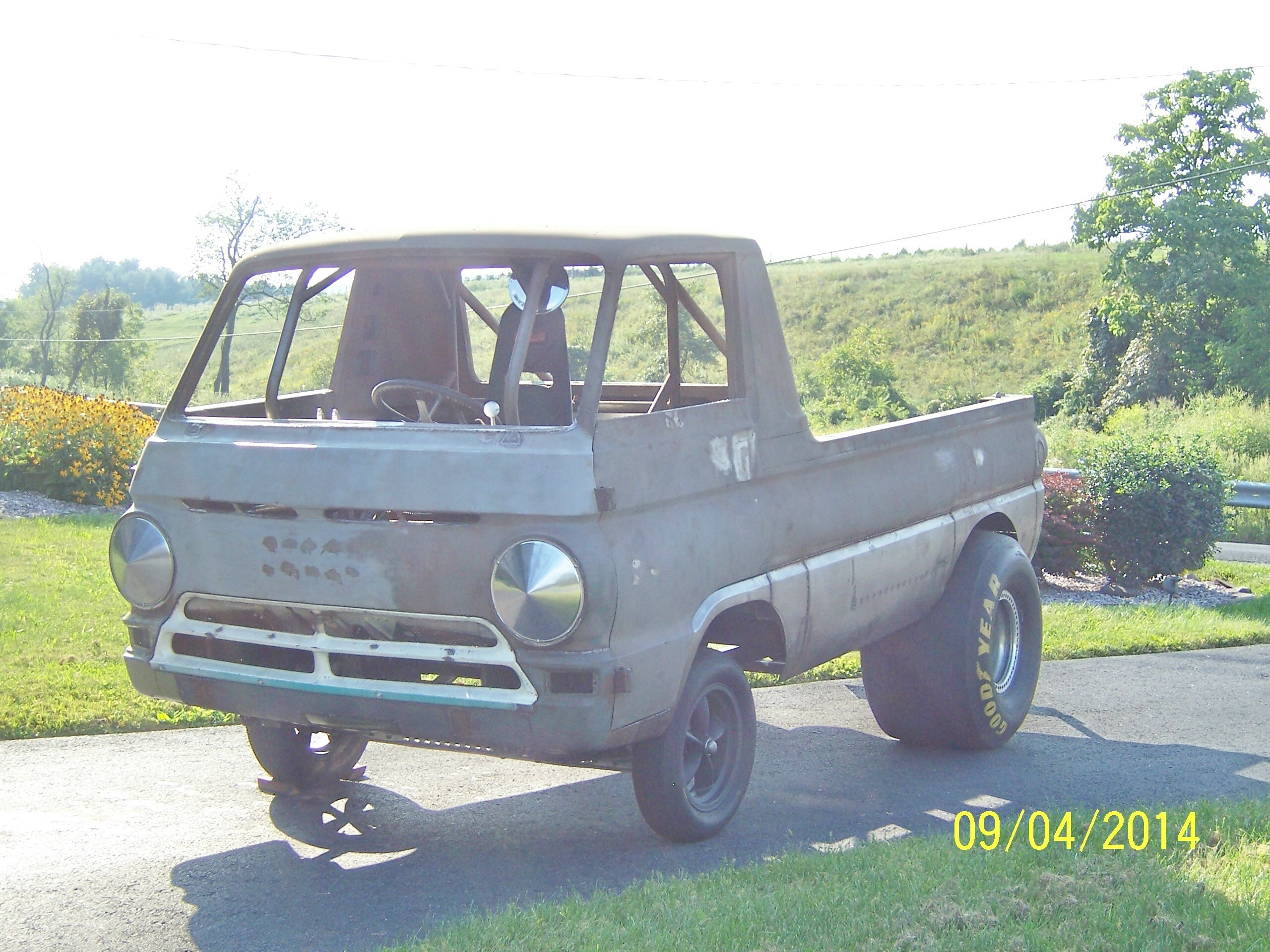

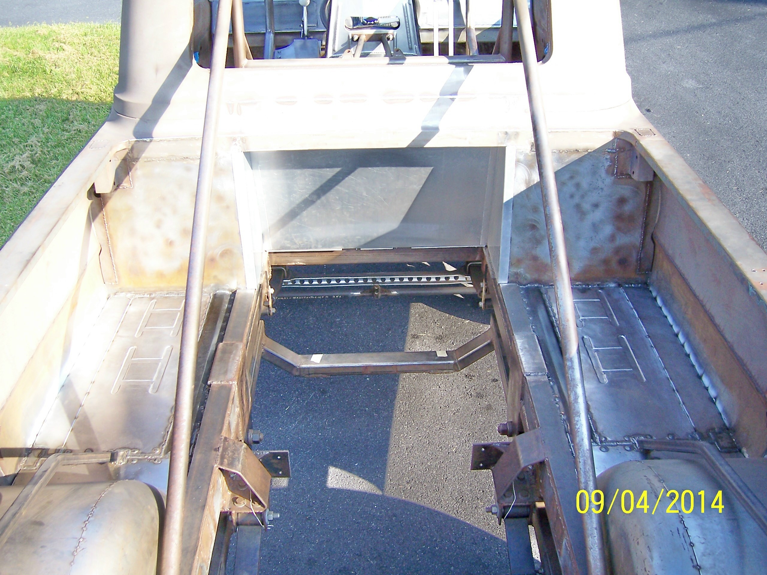

    Hello,it has been a great while since I last posted.On July 3rd I lost my mother and have been trying to get my life back together.
    As a result I have doubled down on my resolve to finish both of my projects and wash my hands of building/fixing cars, be it professionally or for a hobby.Too long to much work/money and I am having no fun, not for a long time.That being said I have been working on the truck every day for a month a have quite a bit of progress that I would like to share.
    I had to rebuild the tops of both L/R door pillers where the dash the dash attaches,rust and old bad repairs. Find another dash,cut out ,strip remove all rust behind with navel jelly and sand blasting,thank you Harbor Freight.Filled all of the holes in the dash,make filler panels,weld and the straighten the top,curled from welding,then install into truck,make fillers from front of dash to front of truck..
    Installed hydraulic throttle, I was going to use aluminum for the floors in the bed behind the cab,but changed my mind and took out all of the 1x1'' framing to support that,cleaned and smoothed all of that area. I decided to install steel flooring just like Dodge did,but know one repos it and I am done with rusty junk so I stamped and bent panels just like the factory.I don't think anybody will be able to tell.And lastly I got the rear wheel houses tacked in one of which I will have to untack and move farword 1/2 inch because it is to far back.How it happened I do not know and know one will care but I will know and care so I will move it.Here are some pics of it outside.I was switching vehicle positions to get my o/t 71 Mach1 closer to my big welder so I can replace the floors,full quarter,tail light panel,ect......so I will be taking a brake from the truck to work on my mustang,going to be my daily car and the last car that I will "fix".
