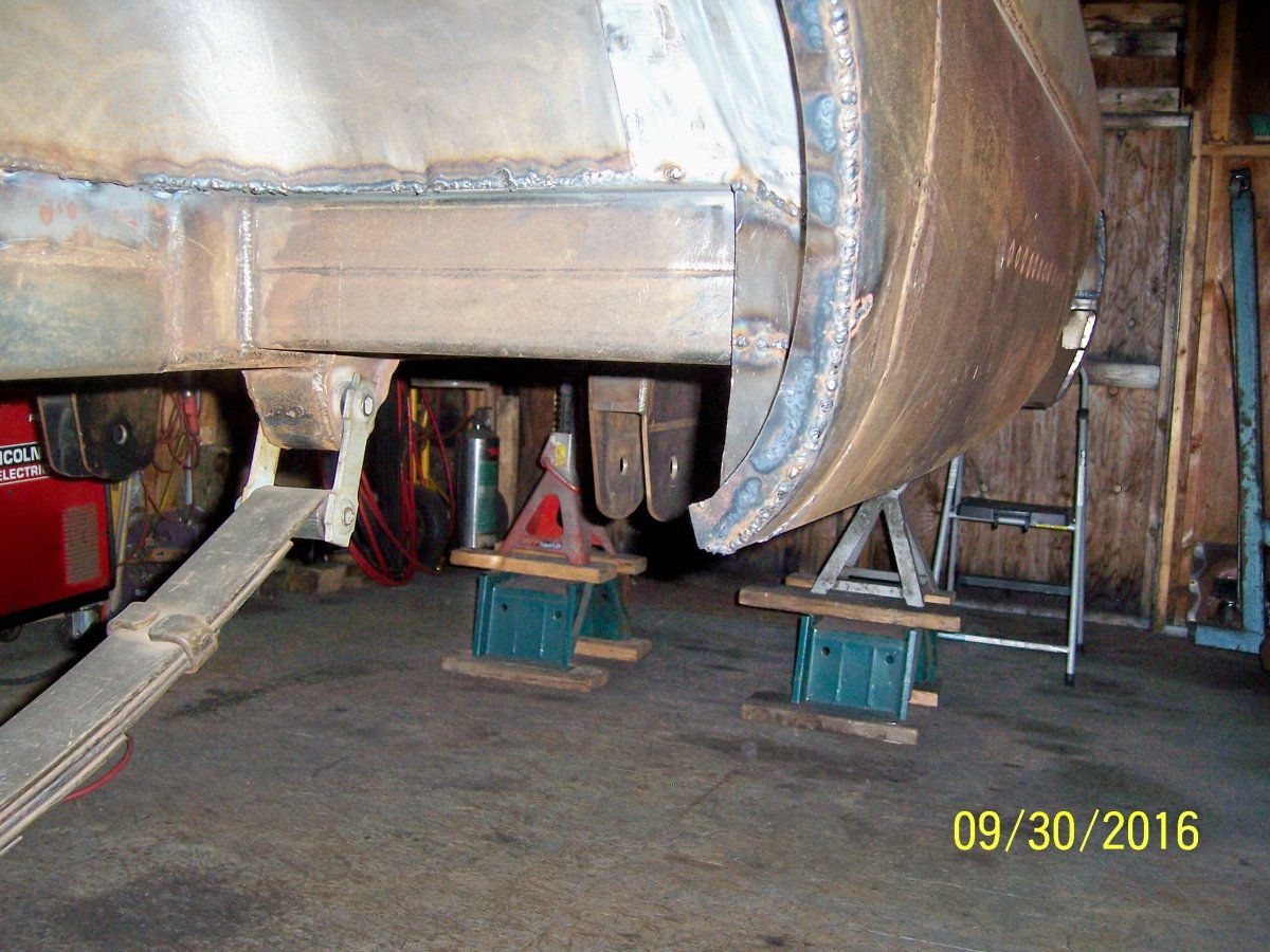

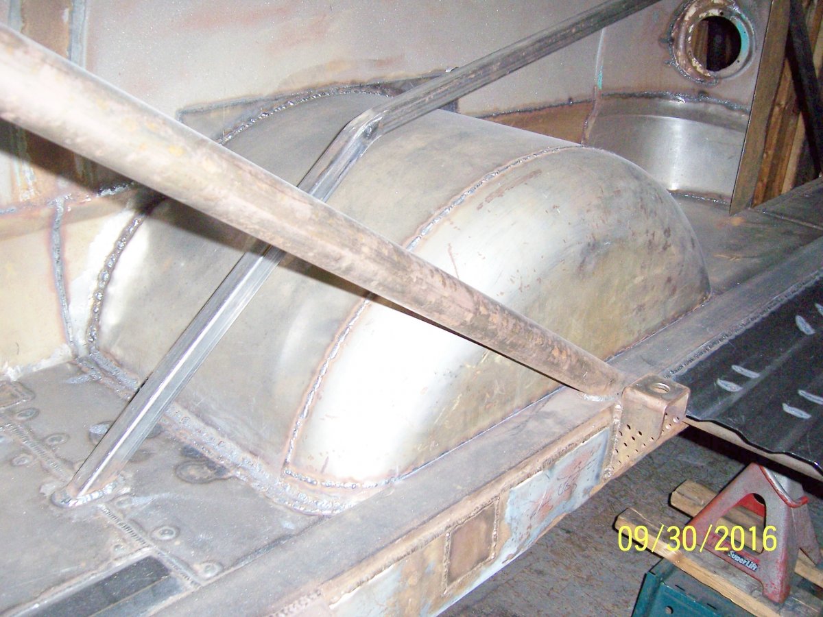

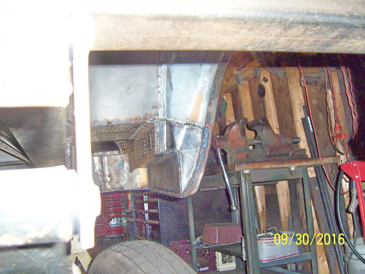

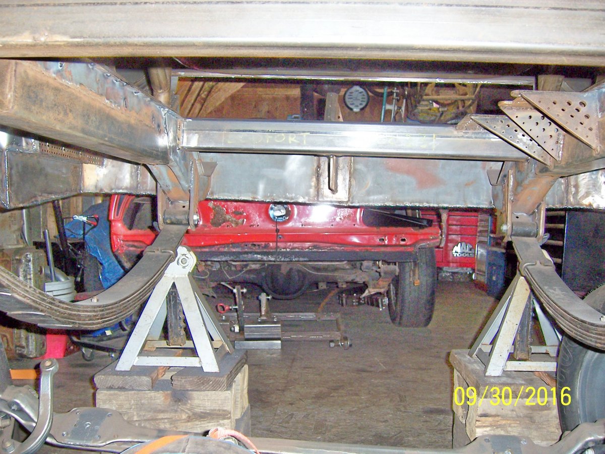

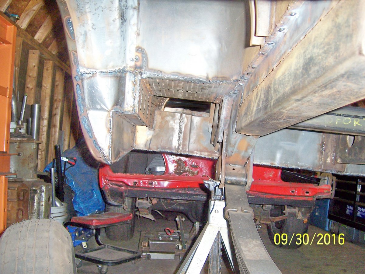

    Good evening to all.I have some progress to post.May not look like much but believe me this was dozens of hours of welding,cutting,refitting and rewelding..I took both of the wheel wells back out ,because I hated the fit and they were not even from side to side buy 1/2 inch(don't know how it happened but it did) Now they are in as even as can be,better than dodge ever did,fully welded.
    All of the bed floor is in and welded 100% just need s lots of finish grinding. The front end is fully welded and DONE(just needs grinding). Steps to wheel houses and inner wheel house to the bottom of the wheel arches.
    Next onto finishing the bottom of the tailgate and making the roll pan that goes under the gate,then to the inner rockers(bottom of bed sides)
    A chance meeting of a friend that I don't see all that to often at the local diner I go to is going to paint the truck in the spring time.He is very good and not scared of the a crazy flake paint job. He also lives about 12 or so miles from me .We are going to get together more the closer I get to the end of metal work to talk about body work,paint, ect..... So more metal and more welding,no stopping till it's DONE.

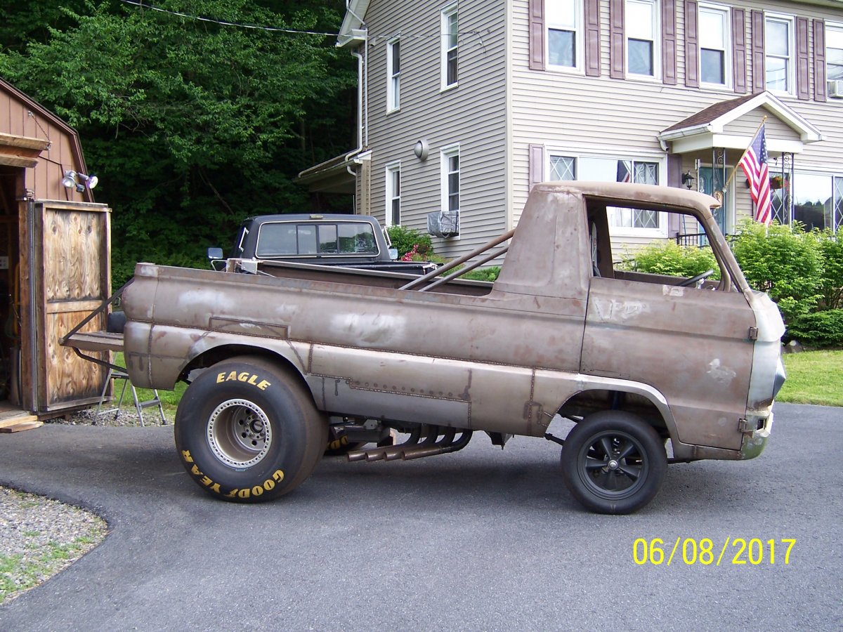

    Good evening, fellow hotrodders.This is a picture worthy post as I have finally made ,fit and installed the last major body panel that was missing that I cut off and threw out years ago.It is the roll pan that is below the tail gate. I now have a complete A100 again.It hides all of the rear spring mounts,tie down mounts and wheelie bar shock mts. The little notch in the middle on the bottom is for the link that attaches the wheelie bar to the bell crank that extends the shocks when the bar goes up.

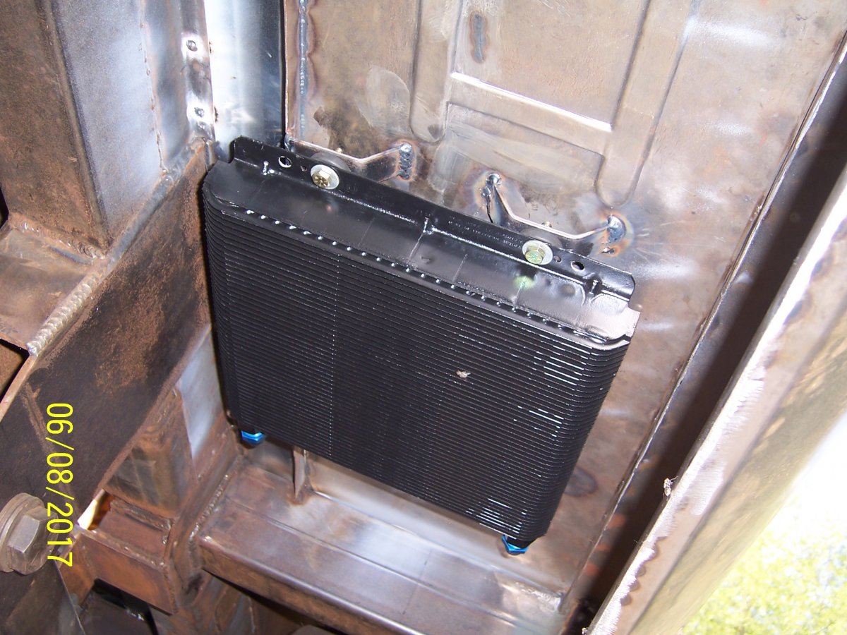

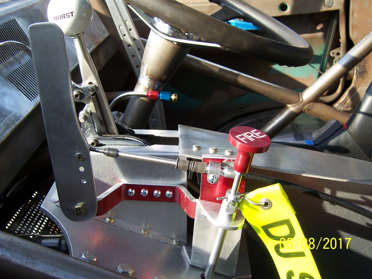

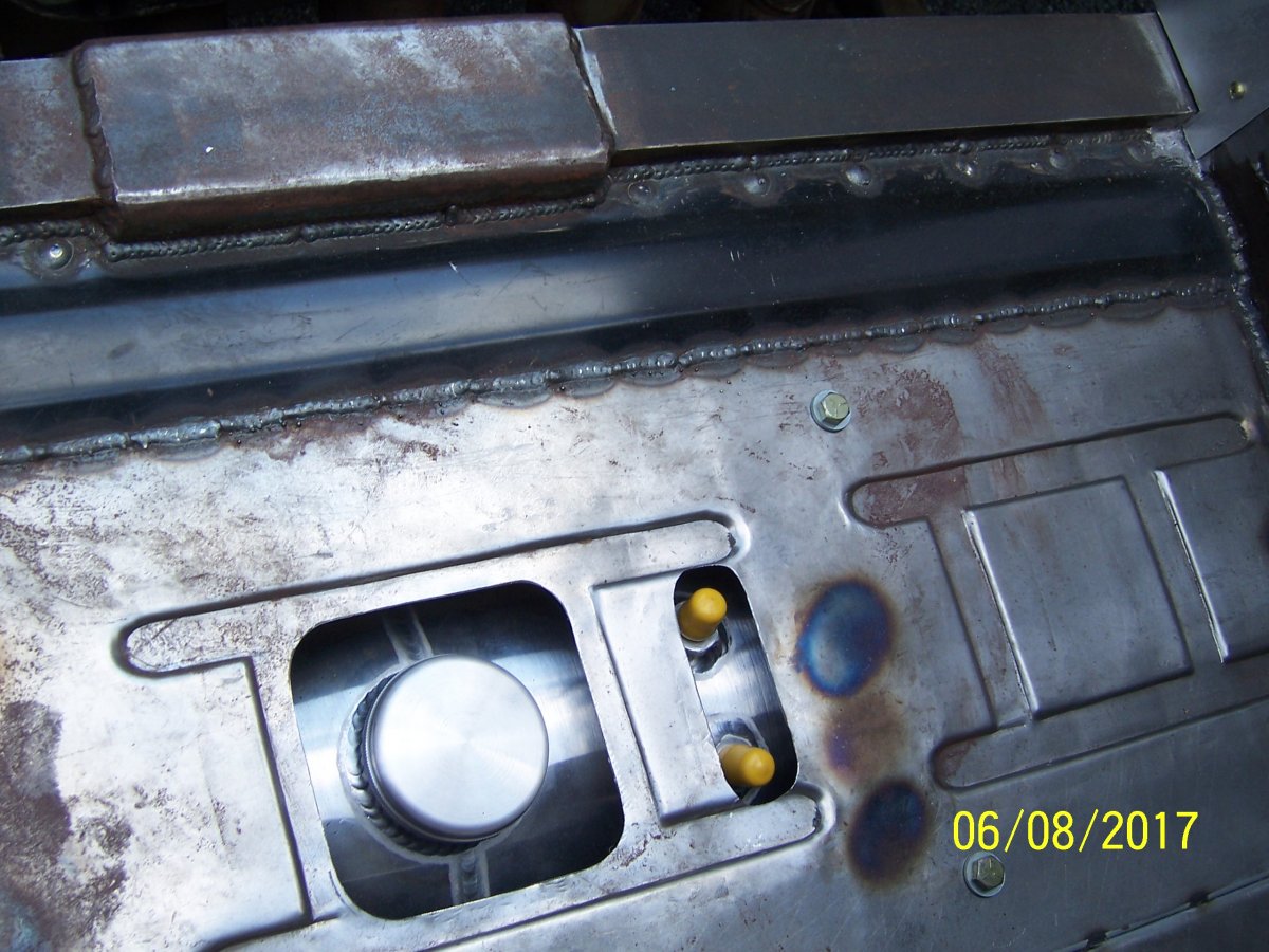

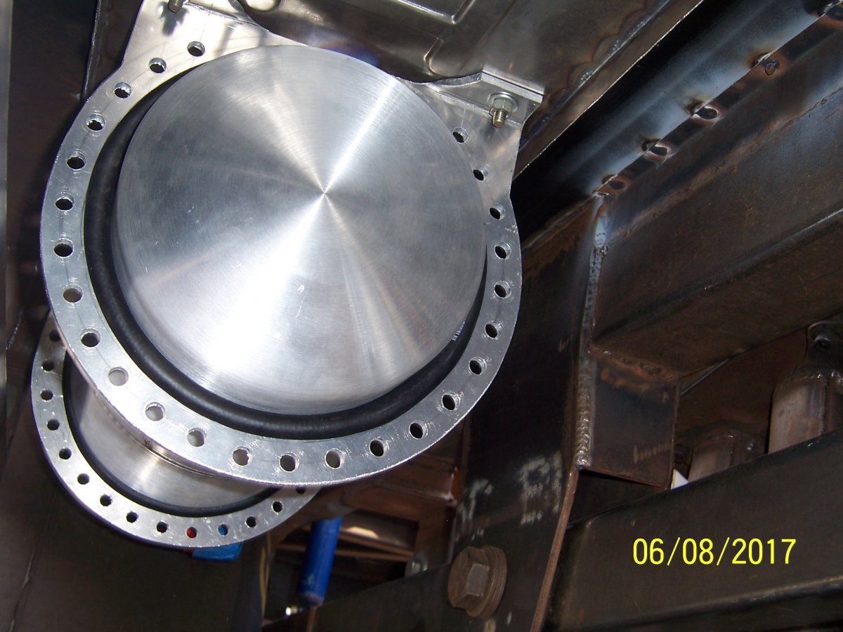

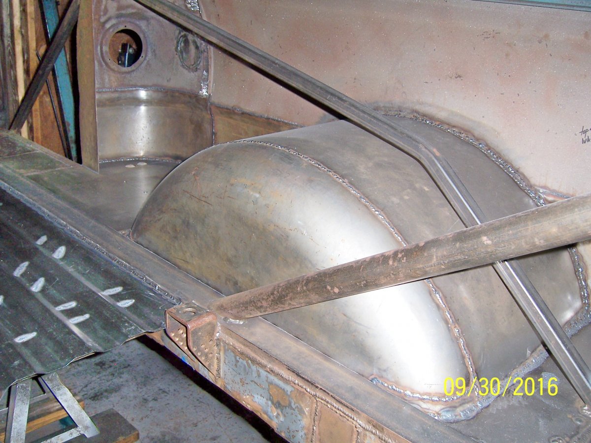

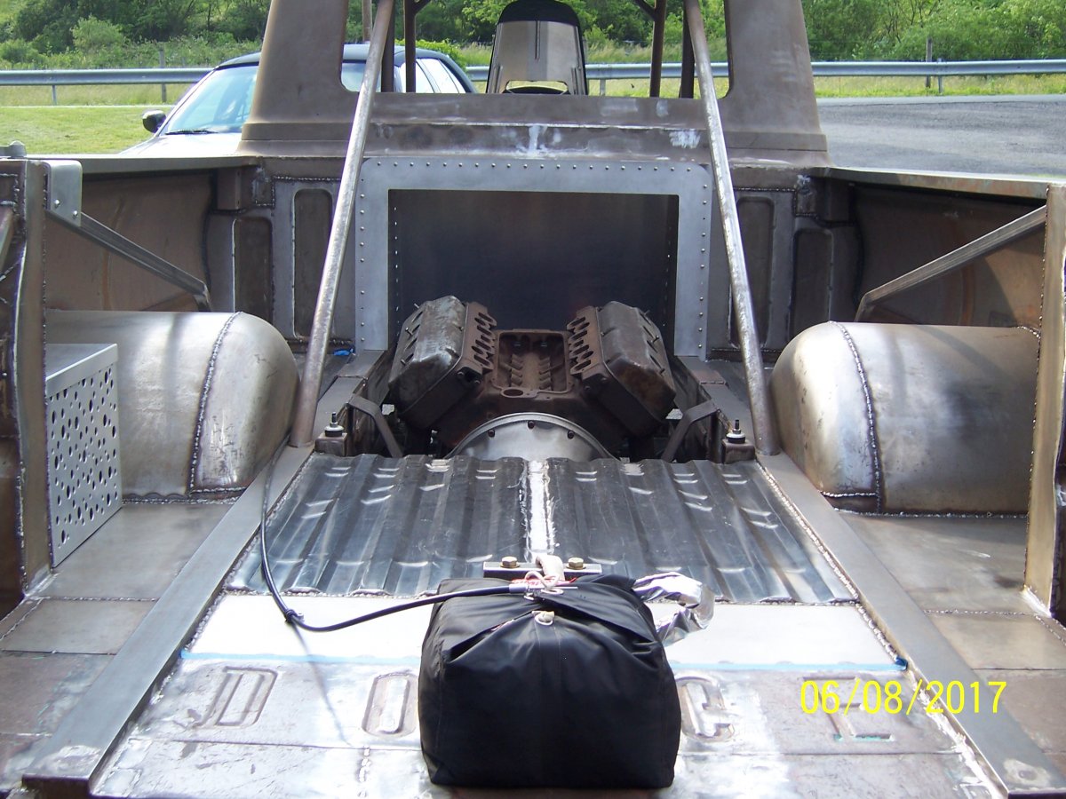

    Hello again, it has been awhile. And of course progress is slow but it is all important.I am marching toward the end though. Fuel tank is mounted,yes that is a new moon tank,the brackets I wanted moon didn't have, so I made my own 1/4 5052. Trans cooler mounted, shifter cover made ,parachute done mounted and functional, and the fire system,lines and cable and brackets and installed.Also a ton of welding you can't see ,finish weld on the subframe and remount the engine again,after all the subframe final welding the u-joint was down by almost a full degree, now it is within 1/2 a tenth of a degree.
    Now on to 3 miles of stainless brake lines and a overly complicated bell crank heim joint shifter cable bracket on the trans.

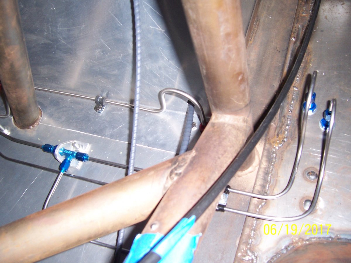

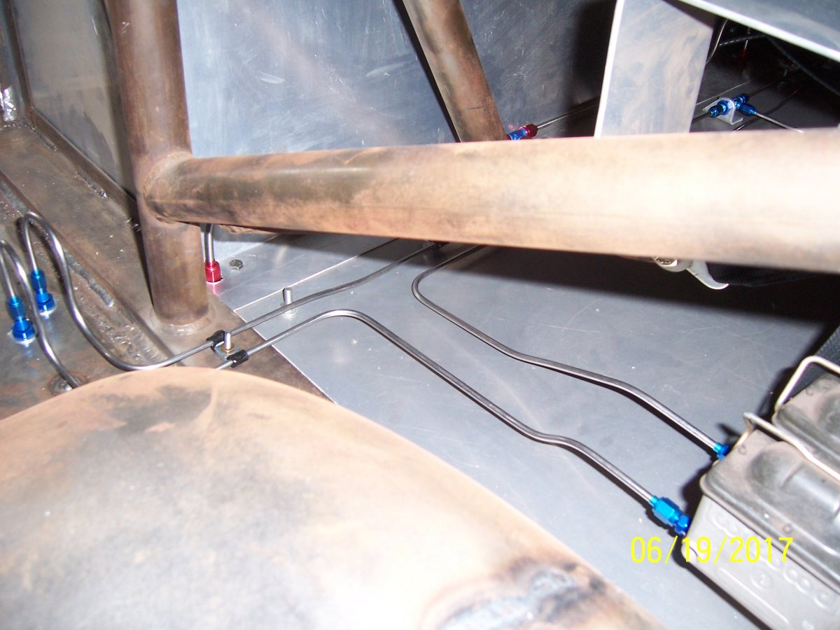

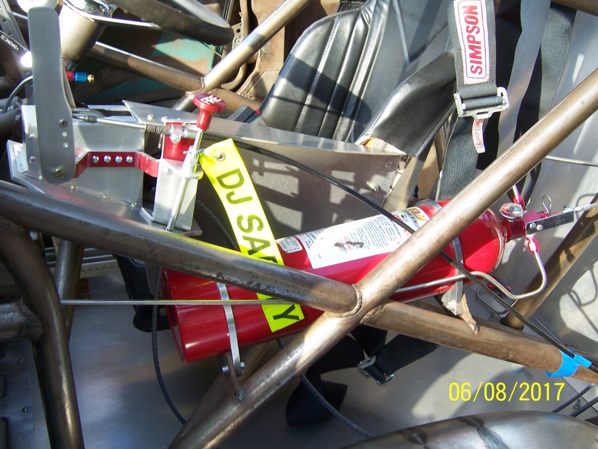

    Good evening once again,lots done,shifter linkage on the trans is finished.It's complicated, functional,and pretty,I should do this stuff for a living ;)I did cheat a little bit,I used a combination of parts from Areospace Componets and I made some brackets and spacers of my own.I also cut the back off of the Hurst Quarter stick and modified it for a B&M style shifter cable.
    Just for good measure I took some pics of the brake lines I ran in the cab. They are all stainless with AN fittings (Ridged flaring tool,same brake line bender I have had forever General is cast in the handle).Made my own line straightener for 20$ from hardware store pulleys and bolts.
    Next is brake lines to the rear and flex hoses to the calipers...........still looking for more info about the southwest too..............

    You going to have two separate systems for the back brakes so you can steer while the fronts are in the air?
  23. I'm in Chandler AZ , stinking hot, 117 today, but the evenings are great, no bugs, temp in the 80's. Cost of living is low, lots of car related activities, jobs are out there but not same $ as the northeast. PM me if you want more, what do you want for work ?
  24. hemiwheelstand
    Joined: Sep 29, 2012
    Posts: 101
    hemiwheelstand
    Hello, Yes it has two separate brake systems(3 actually) you can't see in the pics but there is a master cylinder under the dash that operates the the stopping brakes with a foot pedal and that it has a tee on the floor to the left and right calipers on top of the rotor.
    The steering brakes are hand operated independent left and right each with it's own master. Left has 2 calipers as well as the right,so that makes 3 calipers on each wheel.
    Also as per the NHRA rule book MUST have separate steer and stop systems.
