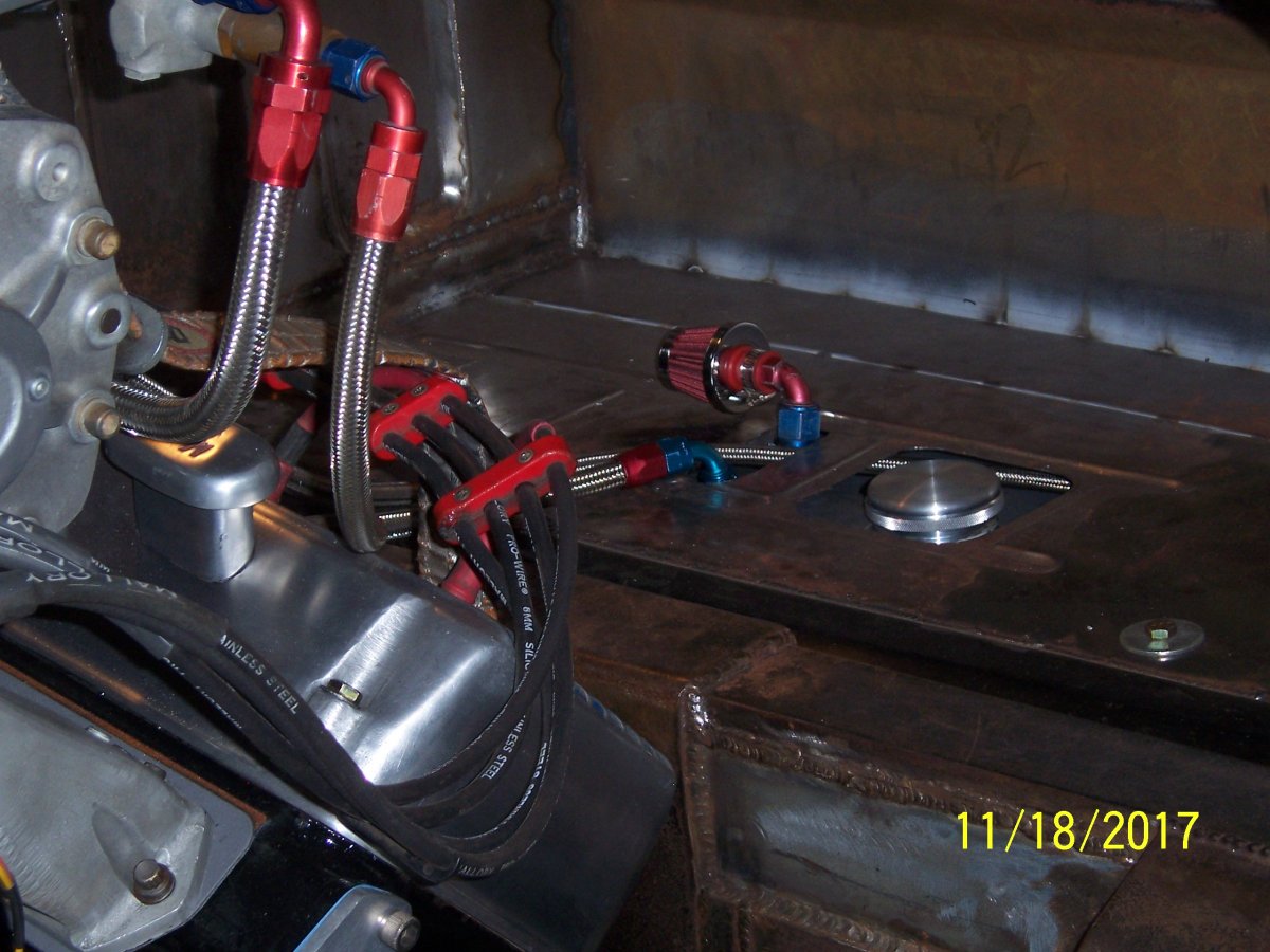

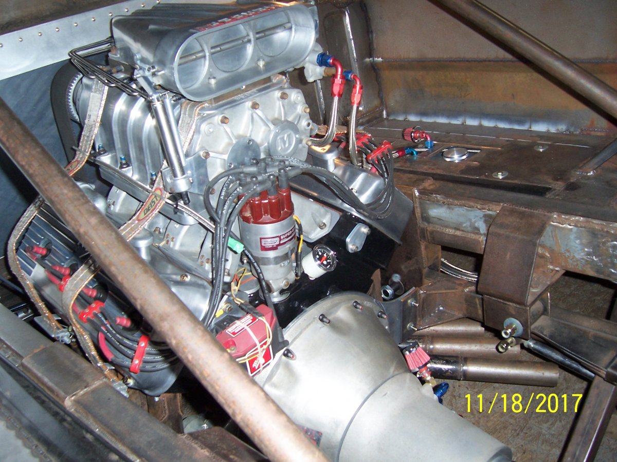

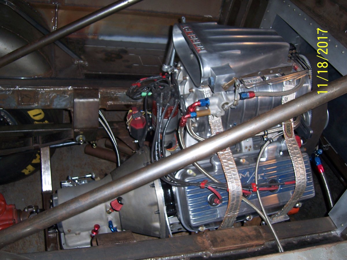

    Hello everyone again. I have some pics and progress. She is all plumbed and dressed ,less the fuel shut off cable,and nowhere to go.I have all the fluids,brake,trans,engine,throttle but think I might leave it all dry for now since it is to damn cold and not enough day light to even think of trying to get it to run=no fun.I still have to figure out the best way to fill and bleed the throttle,not a big deal.As it is now is how it gets pushed into the trailer and will be finished once I am settled somewhere else( where it is sunny and warm,not in the northeast)
    So one more hurtle in that department as I will be converting my crew cab to a 7.3 diesel.I don't want to,but if I intend to move to a very heavily regulated smog state and keep it as my tow truck I have to install a pre 97 diesel in it.Buying a new truck is NOT an option,actually nothing I own could be legally tested anywhere.So I am also looking for a ranchero/el camino to use a daily driver.

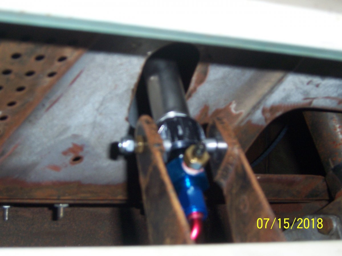

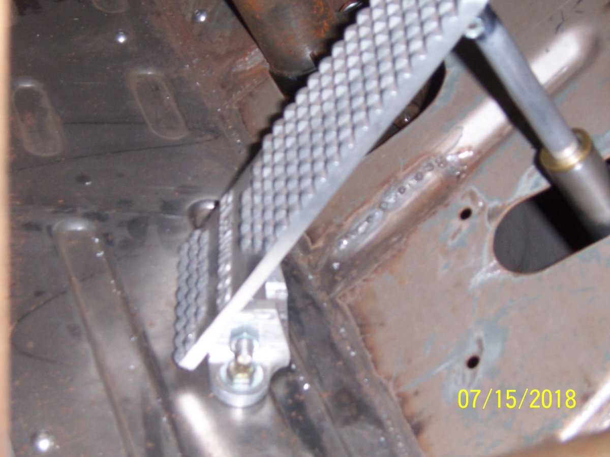

    Hello again, its been a while.I have been working to rid my life of unnecessary things in my life like my other truck and car,junk and stuff I will never use.Throwing stuff out is a great feeling I must say.
    I just wanted to drop a line on the wheelstander.I have been working on it since I finished getting my Chevelle ready and waiting for my Capri and F150 to sell.Car is gone and sold truck on Saturday.
    Wheelstander,I filled the rear with oil. Filled the engine will oil(8 qts VR1)no leaks.Found out the center shaft that drives the pump was too short and needed a 392 shaft(HH 340 pump).Changed the battery ,wired the whole truck,mag,shifter ,starter and ****on.I now have 65 lbs of oil pressure while cranking.Filled trans,will be full while running.Lastly I sorted out the thottle and modified so that The hydraulic set up can be filled and bleed with the whole thing ***embled in the truck.She will have to wait to be started as now I will be getting on a plane soon to go scope out CA.
