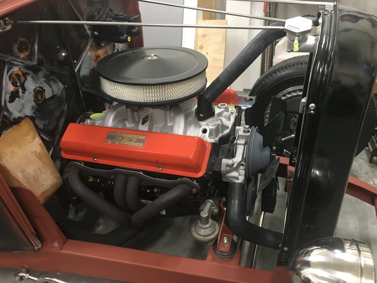

    3D7E34F7-53B8-4D3A-B09A-83D8B7C3C71D.jpeg Here’s my two cents! I started my 32’ a couple years ago. I had found a decent 265, not super but would do! Anyway guess my wife could sense my lack of enthusiasm for the tiny Chevy. She’s quite a shopper. Around my birthday a crate 350 shows up. I think it came from Summit. It’s the truck version rated at 195 horse with the TBI or 260 with a four barrel. Bottom line she purchased it on special, $1395, with free delivery. It has a 3 year warranty. I plan on a cam change and a 600 Holley double pumper, my ride is stick and a quick change. Even found some rare 62 Chevy valve covers. Anyway check it out. Don’t forget how much your old motor will get if you sell it! Plus all things considered the prices might start to fall as time goes by!
