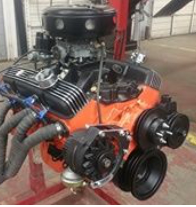

    The ***embled $1500 350. (I rounded up)
    The 1100-1200 short block plus the pull a part idlebrick intake and jet carb. The rebuilt $15 carb, the freebie alternator +$25 rebuild kit, the Craig’s list $40 headers, the $75 Mallory unit (new in the box) and freebie valve covers both items from guys doing LS swaps. The autozone fuel and water pumps.
    The alt and PS brackets are the only luxury items at $90
    The orange paint was free mismatched paint from the paint store.
    The air cleaner is the original one cleaned up with holes added.

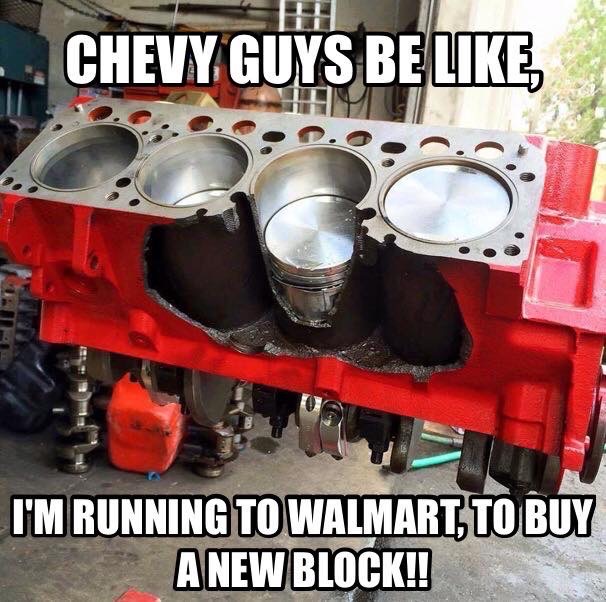

    SEAAIRE354
    And this pic makes me cringe every time it comes up. Tommy I hope it’s not one of yours.

  26. Oh no,,,,not mine Seaair ,
    One thing about it,,,,,it was a catastrophic failure,,,must have been using a lot of boost or nitrous,,,,,always hurts me looking at it .
    At least it looked like it had some thick cylinder walls there .
    It might be hydraulic fail,,,,a lot of force to blow that apart .

    I have never seen a Chevrolet manufactured block that looks like that Obviously a race block. That's racing !

    That's cause it's not. Wrong head bolt pattern, motor mount bosses, and the big lump sticking up on the back. Mopar?
    Blues4U and Truckdoctor Andy like this.
  29. I agree with X-cpe, that’s a Mopar block. The motor mount bosses give it away.
