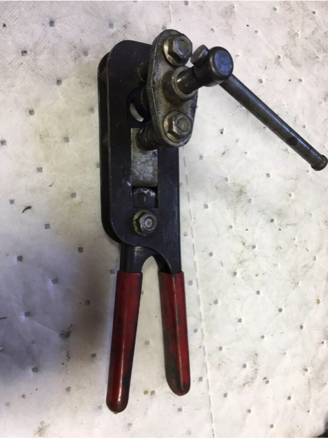

    I was always hit or miss with old fashioned flare tools. First flare went perfect but I could never get good enough leverage when making my second flare. I found a Papco 400 and have been making good double flares ever since. [​IMG]

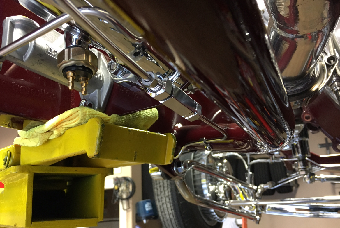

    I try another old fashioned bar tool of better quality. I rented/purchased it from Auto zone. I can get my money back if I wish. It does much much better.
    Another thing too is this Cunifer/Ni-Cop line is unforgiving on the second step. It's real easy to go too far with it smash the second flare. It takes a firm but somewhat gentle touch. This bar tool makes straight flares while the other one would make crooked ones.
    While not absolutely perfect, I tested these flares on a master I had on the bench and I have full contact on the flare and the cone in the fitting.

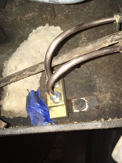

    The good thing about this ni cop line is I can go back and tweak the runs to better follow the factory route You can see I still have some tweaking to do on the crossmember. It looks way better now.

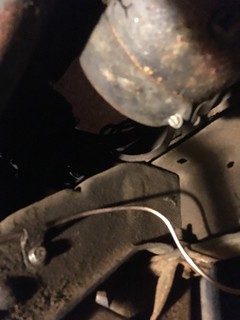

    On a historical note, notice the red oxide prime on the underside of the bed. Most of the time It rains rust under a old one. This truck rains undercoat. I wonder if the red oxide was a prep for under coat or if all of them were painted on the underside with red oxide in the early 60s?
    If you notice the rubber has come out of the Parking brake cable mount. While it may be a little unfair to blame this as substandard work on PO's part it did have somewhat dire consequences.o_O

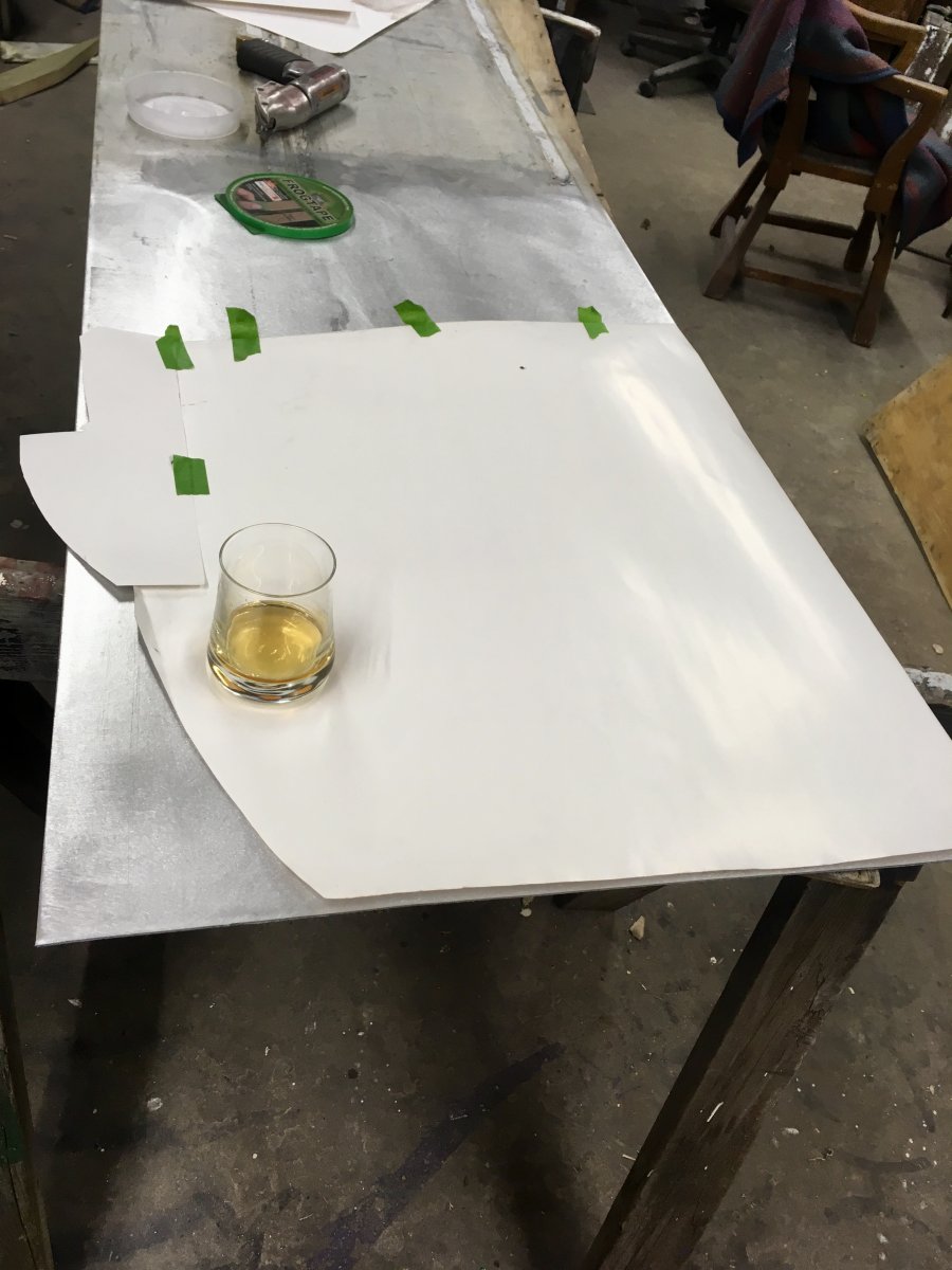

    487B513F-927D-4392-B6F9-D62E279CB1F6.jpeg I have adapted well to my substandard work. My guesstimate was a bit off but I can deal with it. Tin for OT (boat)project I’m tinkering with
