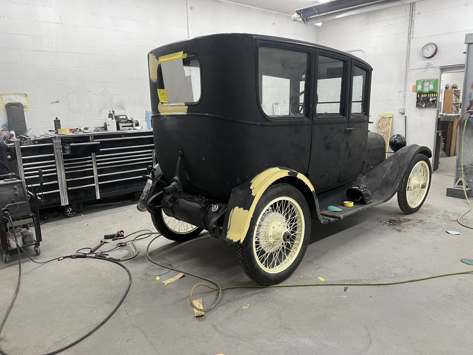

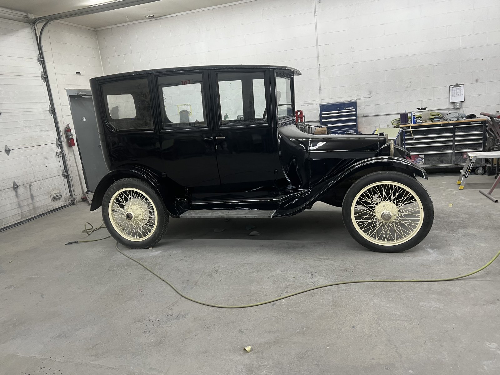

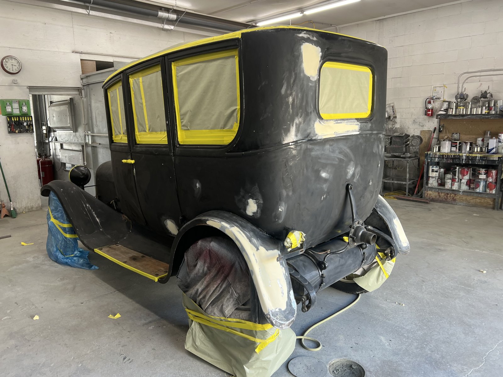

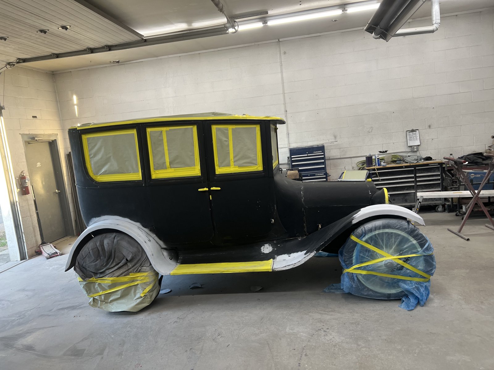

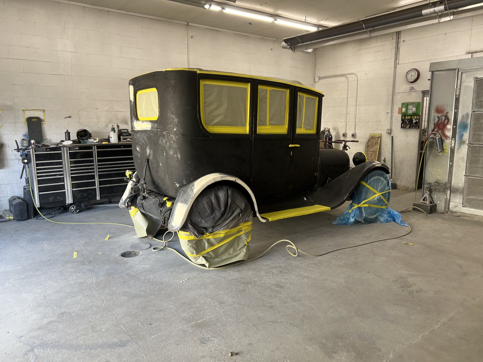

    I painted a 1920 dodge for a friend. He uses his cars for movie props, and just needed it to be presentable.My friend suggested I use vansicle, tractor paint. I bought a gallon with reducer and hardener for $70. It turned out amazing, no orange peel and super shinny. Not bad for a days work and less than 100$. IMG_2129.jpeg IMG_2140.jpeg
    clem, scotts52, harpo1313 and 54 others like this.
  2. That looks great !!

  4. JimSibley
    Joined: Jan 21, 2004
    Posts: 4,250
    JimSibley
    I un-masked it, ready to go. On a side note, this car was found in a barn, with original interior, without a rip in it. With a little work it runs like new, and this is only its second paint job in its 100 years of service. IMG_2141.jpeg

    Yes, the first pic is an old brushed on paint job. This is after I sanded the car in 220 grit to get rid of the brush marks. The yellow is filer, where I fixed the 15 biggest dents and cracks I could find. I then spot primered the car and sanded it in 320 again, before laying down 2 coats of tractor paint. IMG_2132.jpeg IMG_2133.jpeg IMG_2134.jpeg IMG_2138.jpeg

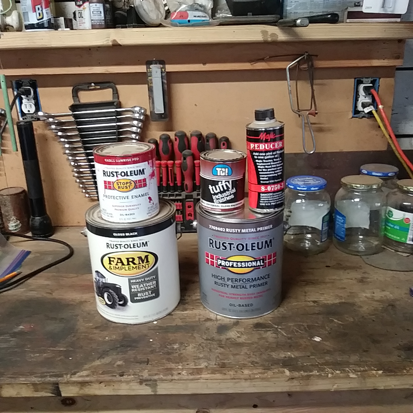

    I did pay up and go to napa and get a universal hardener, I also used tractor supply reducer to go with the paint .... paint, $65. reducer & hardener was less then $100. The primer was another $60 but I needed it.
    I started to paint it gloss black, I put the brakes on that really quick .... My body just has way to many character marks in it ..... I went out and bought the low gloss paint ... I spent another $100 but am much more happy with it .... My care about body work just lacks.
    I painted this last October so several months old ... It is no garage queen .... never been washed.
    Heaven forbid I actually wash it and wax it ...... Never going to happen.
    Just saying our $100 paint job today is better then the paint it was born with ..... I want to drive the wheels off it .... no way I want to spend thousands $$ and be afraid to drive it to the hardware store for lumber

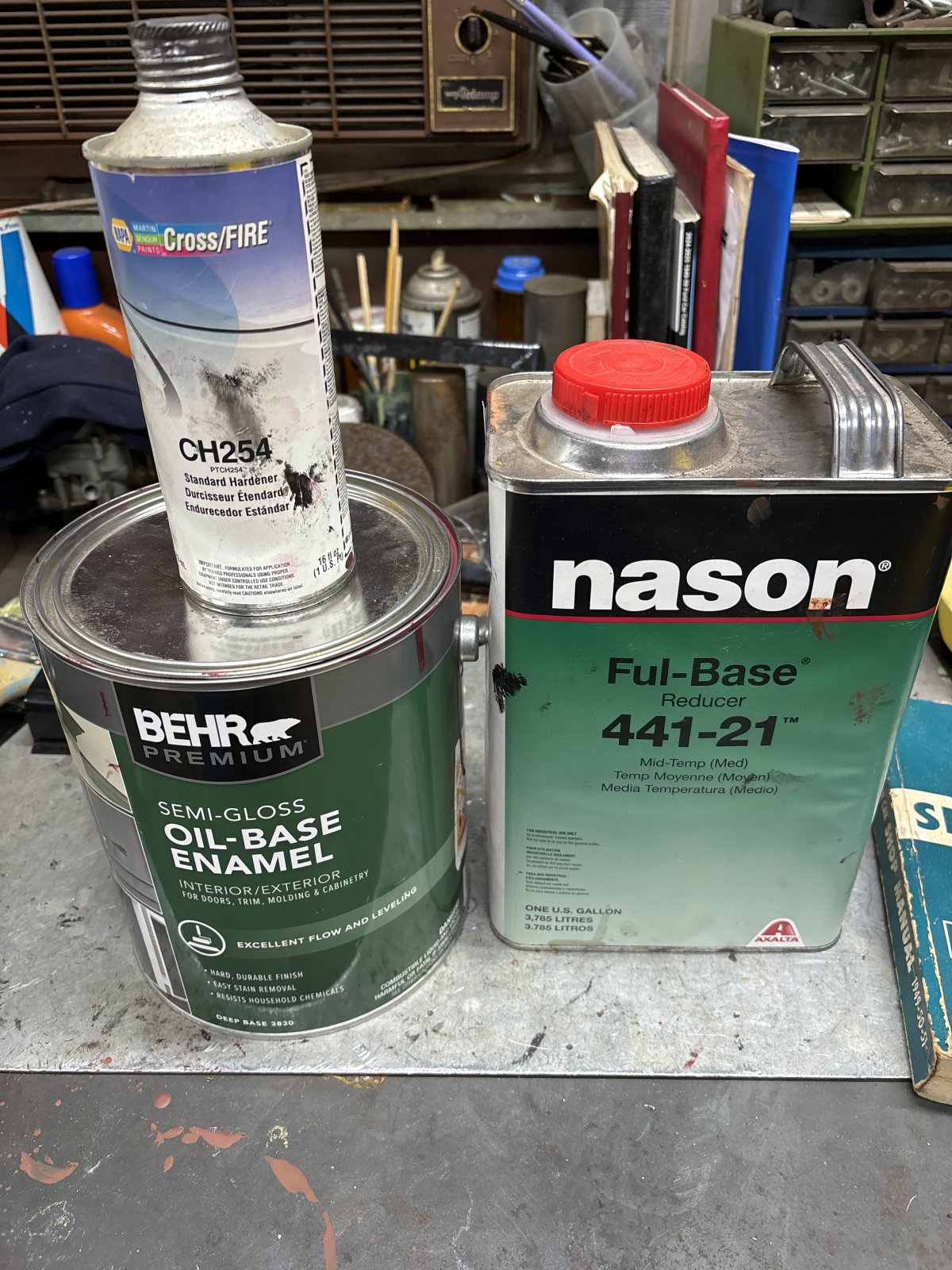

    Okay how’s this for a cheap paint job with more color options than you can shake a stick at. Now the jury is still out on this one but it looks great and I’ll have to see how it holds up but this might be an option for a daily or beater.
    I went to Home Depot and got their exterior oil base enamel (semi gloss) mixed to match what my wife wanted for our other patio furniture and I used Nason Ful-Base 441-21 reducer with an old can of NAPA crossfire standard hardener CH254 that’s at least 15 years old. I shot the TSC enamel primer after scuffing the rust and loose paint off and after 24 hours I sprayed the color @7:30 this morning and we are going to be eating off of it tonight around 7:30 tonight and it’s completely dry.
    Only time will tell if it’s worth a shot but it was way cheaper than single stage paint a gallon. And it came out super wet looking with the hardener I used. But yeah if you want cheap with more options this might do the trick…… image.jpg image.jpg

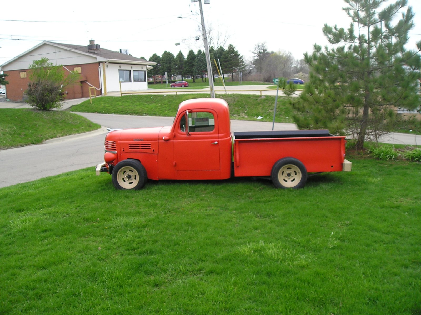

    OK, I'll play.

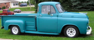

    Oil base red oxide primer. about 3 years old, the spots on the fender are bare metal, the blue around the edges was when the truck first got built, a future color choice around the gl*** and the edges.
    50 Dodge 4x4 029.jpg The same truck in its first blue oil base paint.

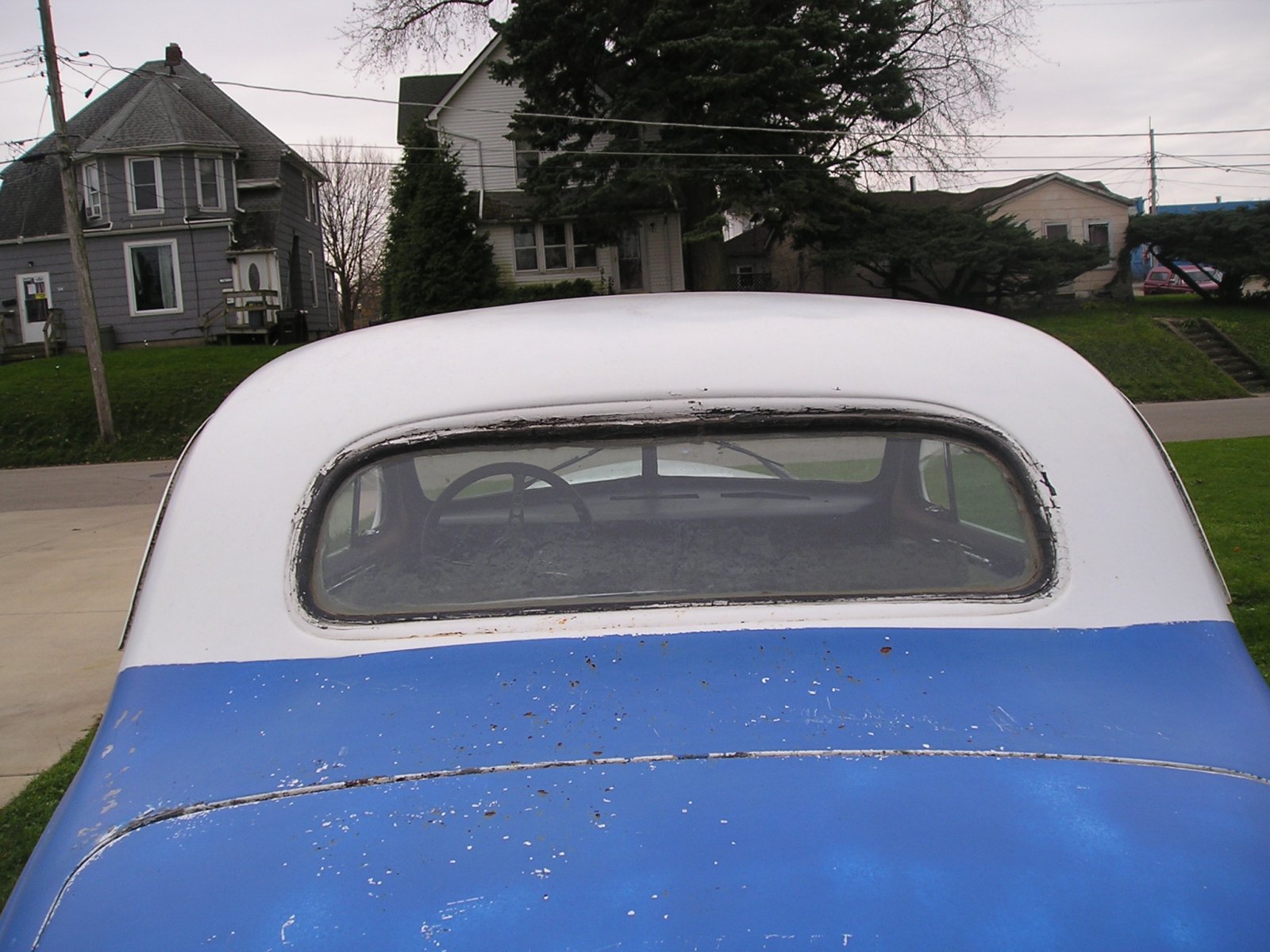

    50 Dodge 4x4 031.jpg 50 Dodge 4x4 033.jpg 50 Dodge 4x4 036.jpg That same oil based blue paint, now about 5 years old. The truck was a daily driver, sat outside and was also a snow plow. see the coupe in the background? after it sold, this truck got a makeover. New gl***, some more body work, new tires and new oil base paint (from the same can as the first blue paint job!)

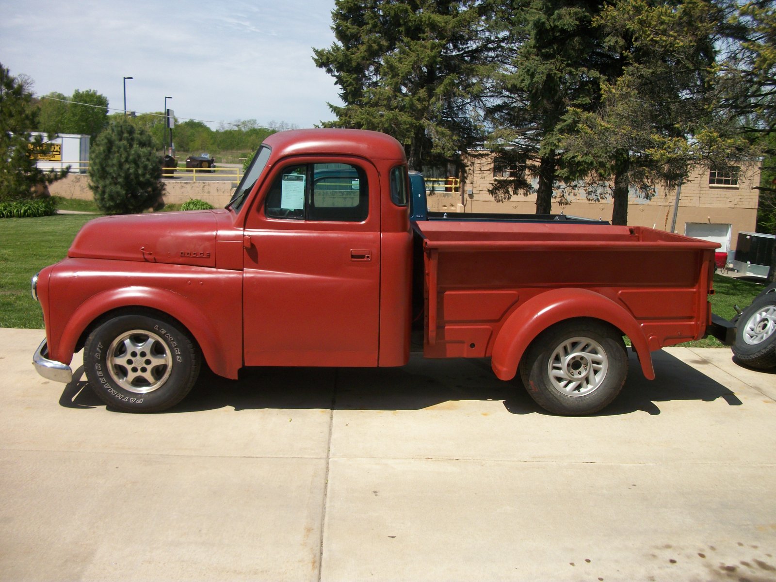

    Here it is with the new paint and the new tires. About a year later the truck was totaled. The white Dakota in the back ground was the donor truck for my 48 Plymouth coupe that got built from the proceeds of this trucks total.

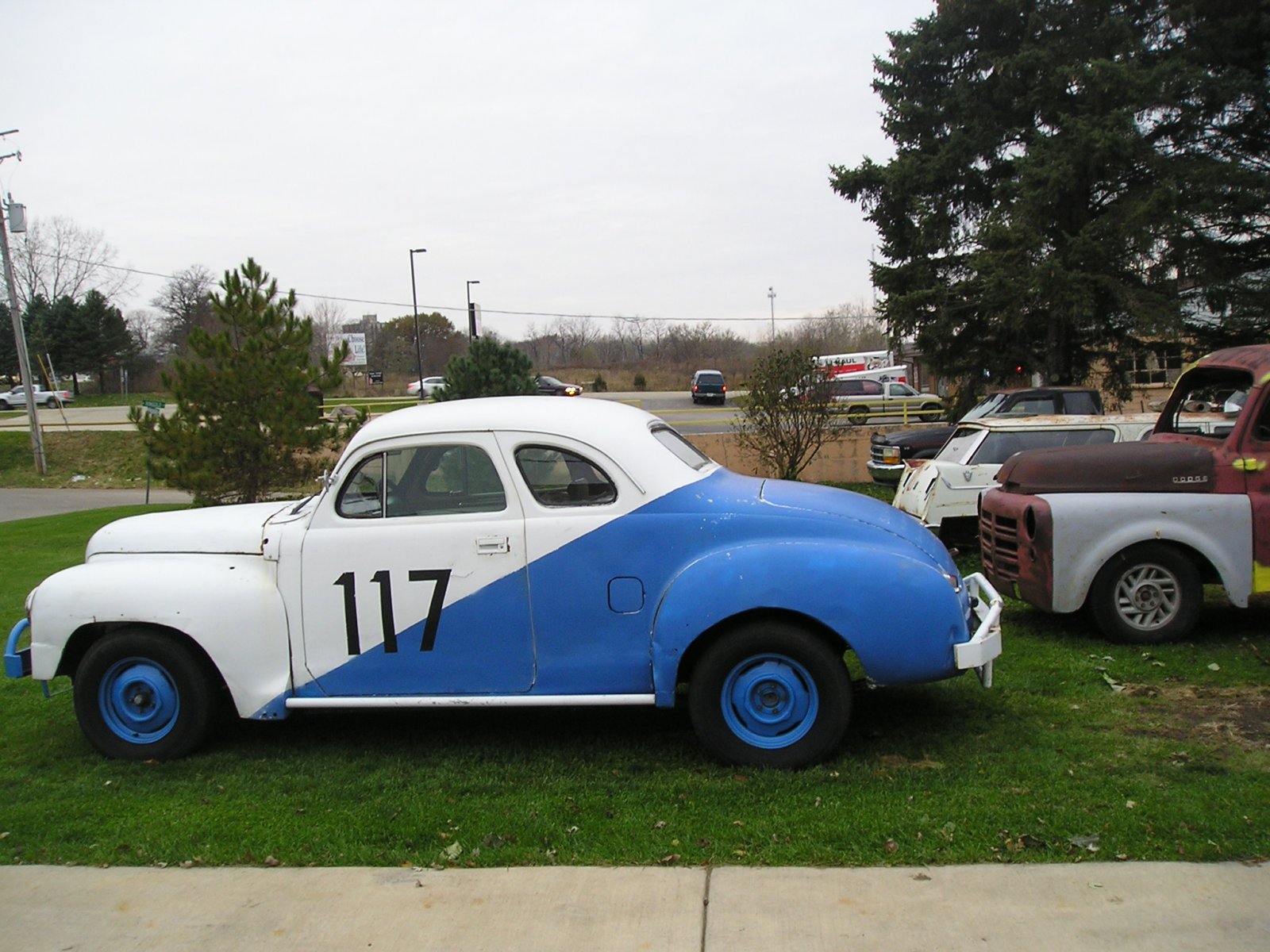

    This one proceeded the truck above. That white and gray were both oil base paint. The car has a for sale sign in the window, so that white and gray paint was about 5 years old and was getting pretty rough around the edges. The car sold the next summer in black primer with red/orange, and yellow flames (I don't have a picture if it then).
    Oil base paint, custom mixed. The paint here is pretty new (see the red primer earlier truck in the back ground?) This paint went about 4 years before it started getting paint chips on the front facing surfaces (just like all the others). It may have faded a bit, but not bad. But hitting bugs at 70 mph does chip the oil base paint, even with the hardener, and other scratches appear as well. That stuff starts showing up after about 4 years and gets worse every year afterwards. This truck got driven 44,000 miles before it sold.
    My 48 Plymouth coupe. This blue was the last that was left from the gallon that painted the blue truck twice (at this point that gallon was around 10 years old!) This was brushed on and in this picture the blue paint was on the car for about 4 years. even in this picture you can see the paint failing (though it may have been because of the age of the blue paint). Can't blame this one on bug chips, but the car did sit outside and it was driven probably around 60,000 miles at this point.
    A close up of the old, but failing oil base blue paint. The car got redone because that rear window started leaking water. it wasn't the old rubber seal, the sheet metal holding the rubber gasket had rust holes in it. When the car was repainted, I used automotive paint. I was tired of repainting everything every 4-5 years, even if the paint was cheap.

  27. JimSibley
    Posts: 4,250
    JimSibley
    They wanted this one shiney, it is a 1920, the movie takes place in 1923, so it is supposed to be a newer car.
