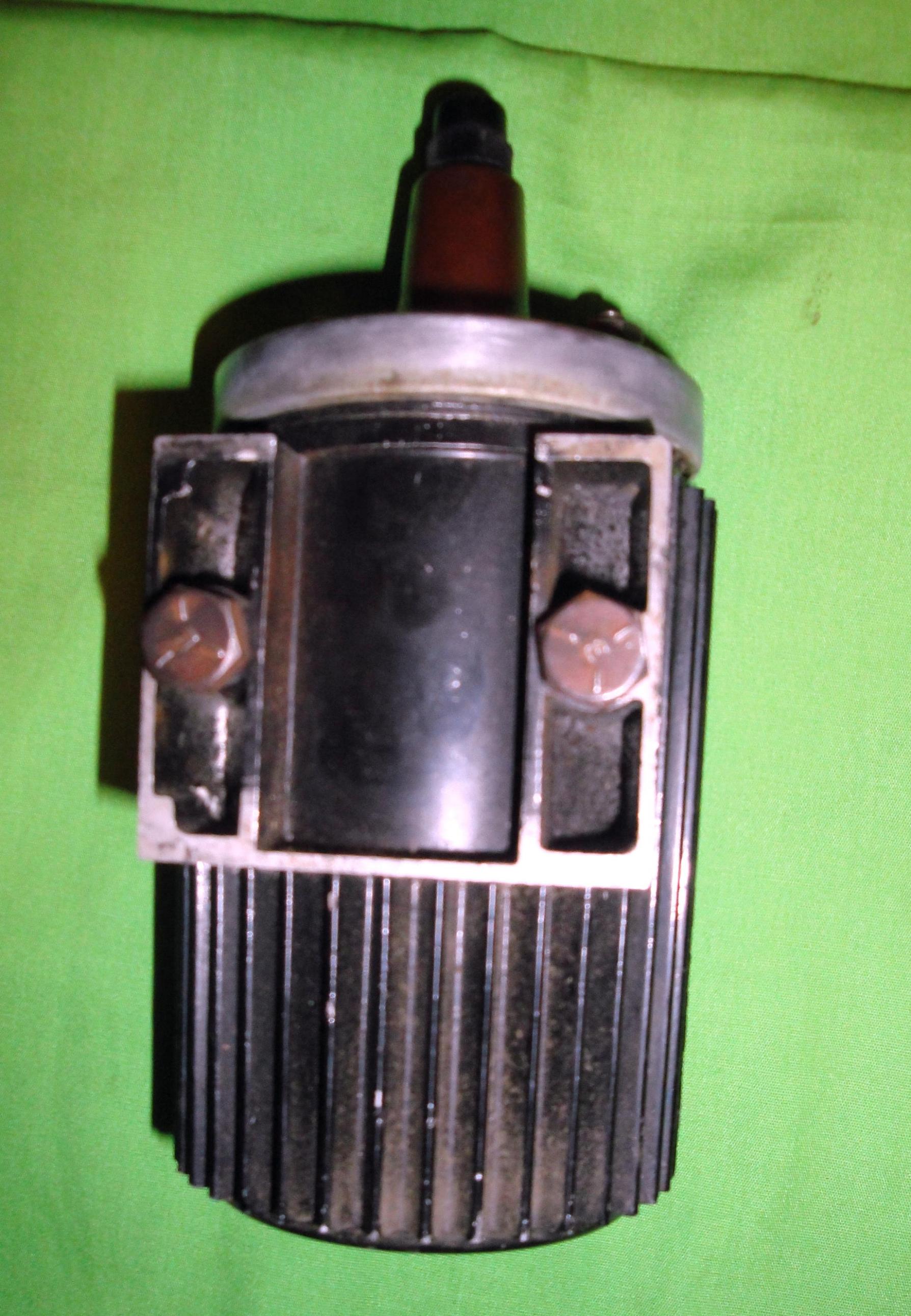

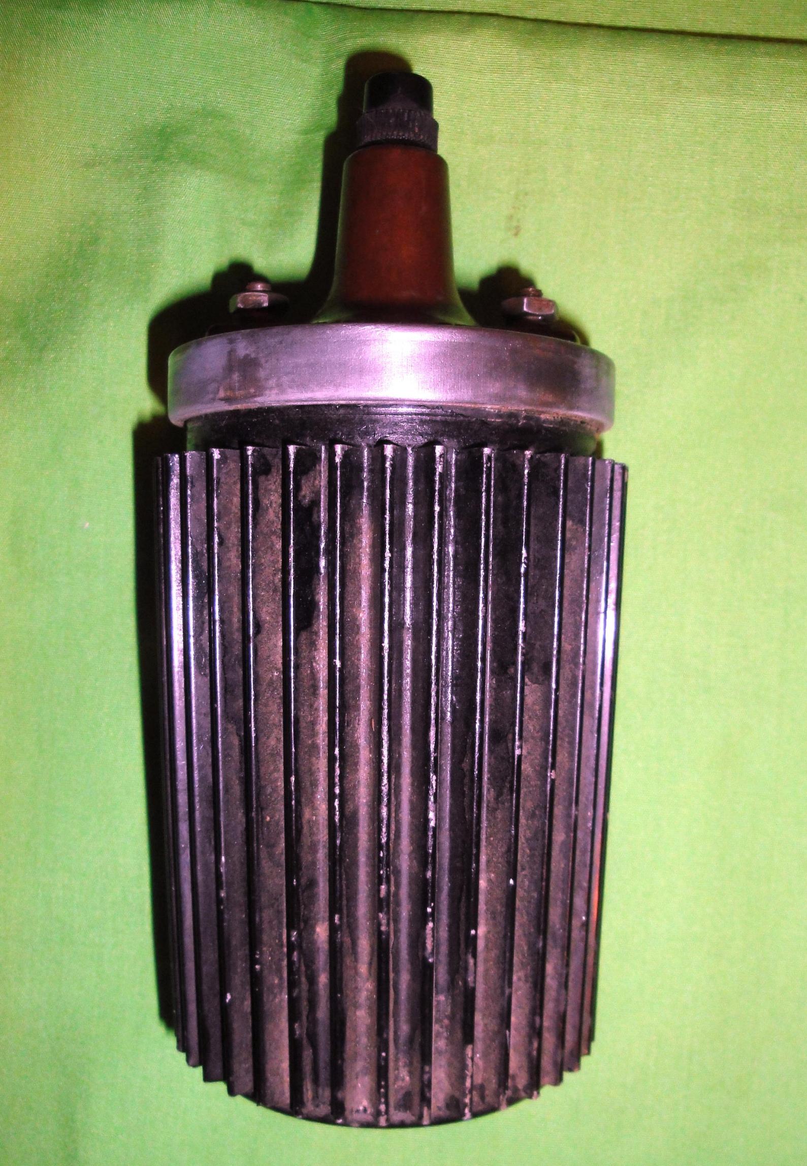

    I was hoping to see at least one of those old military finned coils. All over the place back in the 50s and 60s but I haven't seen one in forever. I think they were GMC

    You mean those big finned Delco coils,
    like this one?? They weren't just GMC
    or "military". Besides some heavy-duty
    GM trucks and various military apps,
    they were also used as OEM equipment
    on numerous other makes models and
    brands of medium and heavy-duty
    trucks and on numerous makes of
    industrial and heavy-duty marine
    engines - from sometime in the late
    1930's and early-'40's, right up through
    into at least the early 1960's. 'Back in
    the day', circa early and mid-'70's, I used
    to regularly scrounge a local "'big-truck"
    boneyard for them and I used them on
    several rods and hot 'street-strip' cars.
    Besides looking cool, they could throw
    one hell of a spark, yet they didn't draw
    so much current as to be excessively
    hard on the points. They still show up
    on epay and at swapmeets from time
    to time and they're a good deal all
    around if you can find one. :)

    I have one, but don't know if the coil is still good (just need to test it). If it IS bad, is it possible to remove the coil from the fins and replace with a newer one?

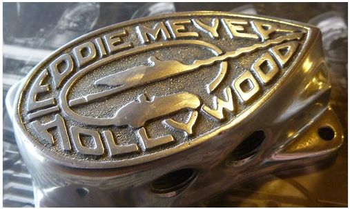

    HAMB experts:
    I don't know if this piece that I recently purchased is a bogus hunk or if it fits in this thread as a cool old vintage fuel block. I like it anyway since it reminds me of Meyers history, but I'd appreciate your experienced comments on this fuel block:

    I've read about some guys here
    doing that, but if the coil works, I'd try
    running it "as is". You'd be surprised at
    how much spark they can throw out. If
    the coil checks out, you might what to
    experiment with opening up the plug
    gap a bit to take advantage of the coil's
    output potential. I used to run the plug
    gap opened up to .040 with one of these
    coils on a built 283 and and it would pull
    hard right through 7000 rpm,. With the
    stock Chevy coil I could only run about
    a .028 or .030 plug or it would start to lose
    power above 6000 rpm.

    I've never done this brand but the ones I have gutted were very easy. Cut the shiny band around the top and remove it, hold the coil in a vise upside down over a trash can and warm it up with a torch until the guts fall out into the trash can.

    It is not a period piece if that matters to you. It was made in the last 20 years.

    Thanks for that info, tommy. I like it anyway but now I know where it stands.

    mart3406 - yep - that's it. Like you, we would scrounge around for those things - not only serious spark, but just cool looking as heck, especially if your car had other finned stuff - beehive, cylinder heads (or valve covers), regulator covers, etc.
    thanks for posting that picture

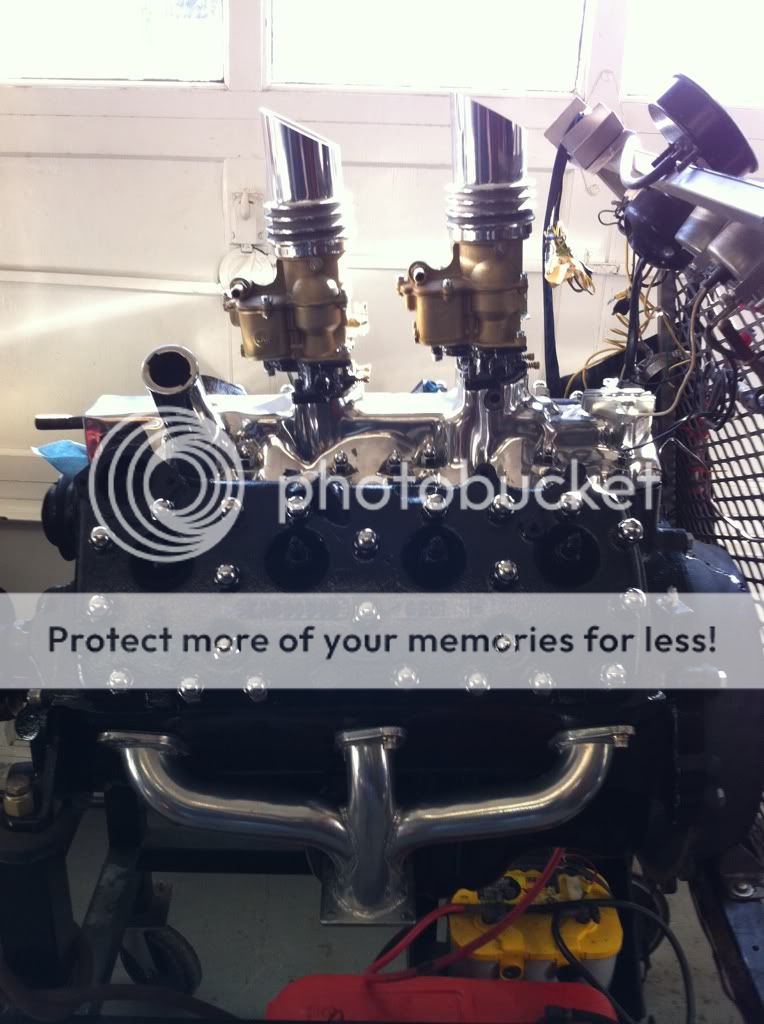

    Here are a few things that are all going on my '39 Ford as we speak
    Malp***i Filter King
    Original Marvel Mystery Oiler
    Sun Tach & Sender and Grant/Saplding Flamethrower
    Polished Fenton Intake, Velocity Stacks on 94's
    Engine on the test stand
    Who knows what else we can dig up before we are done!
