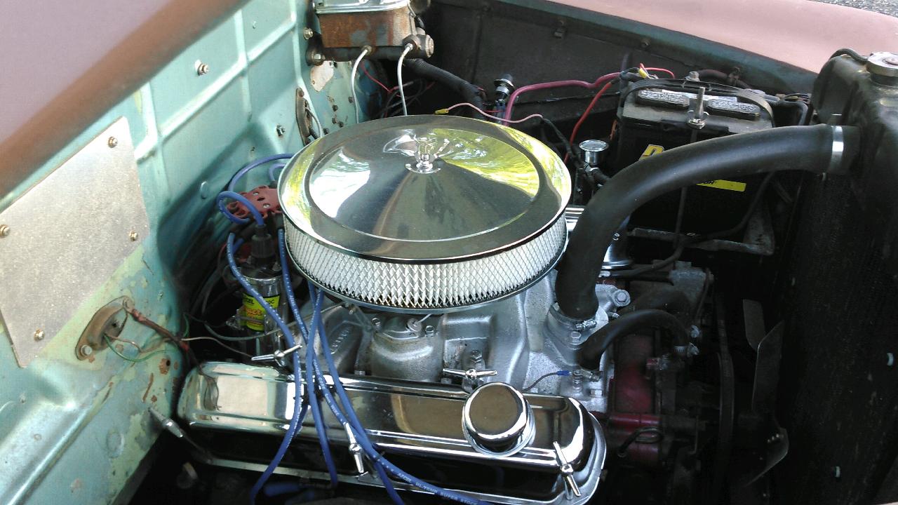

    Or... (wait for it...) you could replace it with a V8. Had a 318 in my '50 Dodge. 4231.jpeg

    Hey rustydusty. I spotted your car on a different post. Meadowbrook or coronet?
