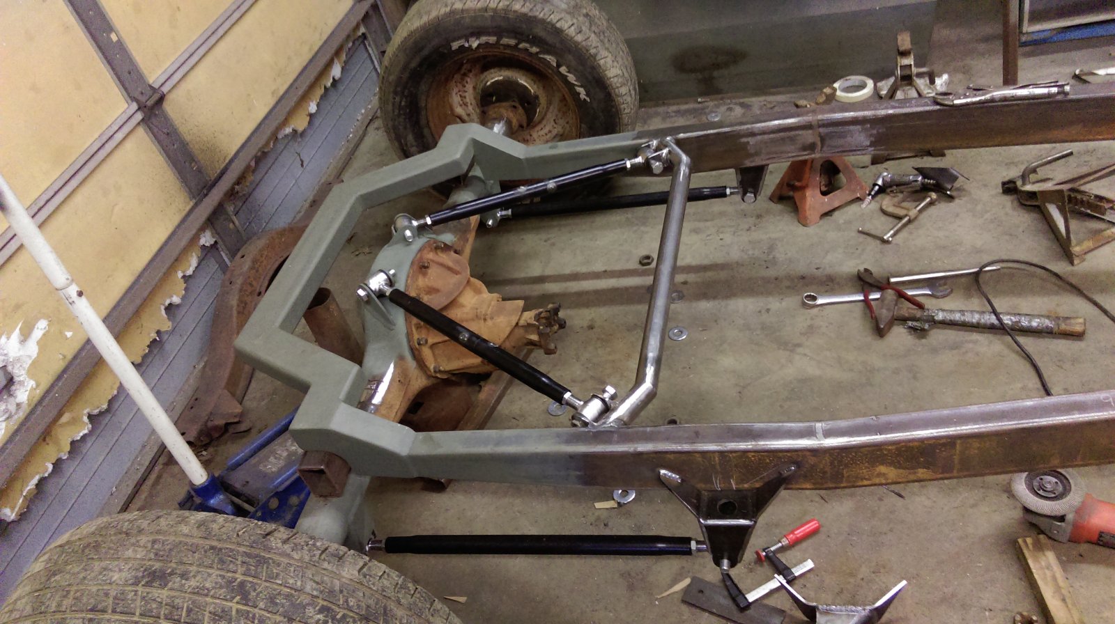

    This is a Heidt's triangulated 4 link. I'm pretty happy with it.
    ekimneirbo likes this.

    Jaracer, what angle are the top bars and length compared to the bottom bars on your ch***is, thanks Glen

    The top bars are 17 1/2 and the bottom bars are 21 1/2. The car is all together now so I can't really tell you the angle on the top bars although I believe they point downward slightly. It's currently on the lift so the measurements were easy. The lift is a frame contact lift so the suspension is hanging down and angles aren't at ride height.

    Jaracer, I meant the angle from housing to frame of the top bars, thanks Glen
