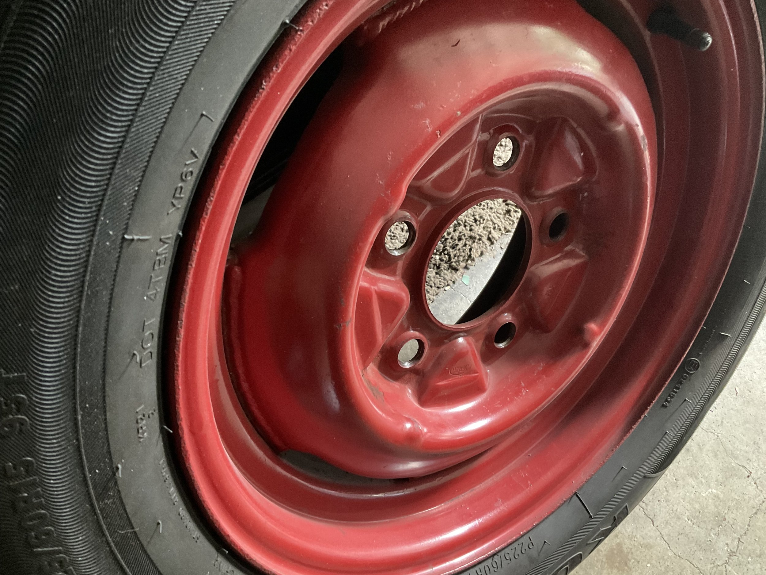

    Putting the 9” together for the 51. I’m going to run 30 or 31 inch tires between 10 and 12.5 width. Which rear bolt pattern and wheel studs are strongest? My disks are drilled for the common options and the wheels are unilugs so I can put in whatever works best. If it matters my wheels are Western slots that were SFI certified back in the day.

    It has 1/2 inch Ford studs now at 4 1/2. The wheels and my hubs go out to 5. I think I will call Quick Performance on Monday and see if the have time to do the 5/8 studs at 5 in. I need a second 3rd member with 3.89 or 4.11 gears to get the most out of the tires. If they don’t have enough time to do the studs in a day while I wait I’ll just move the 1/2 inch studs out to 5 and order the 3rd member.

    Make sure to fully check your measurements....as far as I know Western did not make 3 pattern in the same wheel, as without a recessed locating washer like E-T or an offset aluminum slug fitted from the backside like Ansen the middle pattern becomes worthless, it is just floating in the holes.
    Western made what is called dual-fit, 2 patterns....the lug shanks either fit the inner half-moon of each slightly elongated hole or the outer half of each hole.
    Typical fits are 4-1/2" and 4-3/4"together,... or 4-3/4" and 5"

    Since I hate being on ladders, I moved the studs on one side. I found out the rotors are drilled for all three, not the axle flange. So I moved them out to 4.75 and apparently Ericnova72 is spot on on these Western wheels. I just need 1/2 inch shank wheel nuts and I can see if I’m happy with the fit. 5/8 Studs are still on the table as the car will be just over or under 4 digit power to the wheels. When I road trip the car, it will likely have a trailer behind it. 2 spares and possibly a fuel cell wouldn’t leave any trunk space for spares, tools, safety gear, and the battery.

    The Western wheels are designed without washer slots as the washers sit flat on the face. And as Ericnova72 said, they have slots that only do 2 bolt patterns. The shanks are all the way at one end of the holes depending on the bolt pattern. Then the shanks make contact 180 degrees around their diameter and the flat washers help hold the wheels against the rotor. It must work for them to have been SFI certified. But 5/8 studs are still high on the considerations list.
