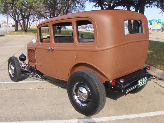

    I will eventually do a rear swap, but right now I'm trying to spend as little money as possible until I have enough money to do some of these things. Right now I just want to try & get the high boy look while keeping it as close to stock as normal. It seems like if I remove the fenders the body will sit too high or maybe it's because of the wheels being too skinny. Am I right about this or am I wrong.
    -Will I be able to put wider wheels on the original drums?
    -My plan is to put a flathead with a t5 transmission. If that's possible. Has anyone done this?
    -the stance I'd like to eventually obtain is like this
    [​IMG][​IMG][​IMG]
    Will I be able to obtain something like this with the original rear axle? I know I'm going to have to do reverse eyes on the rear spring, as well as remove & replace springs with model t springs to get a lower stance. I'm just worried that with the original wheels & no fenders it's gonna look like this
    Thanks for the info fellas.

    OK a couple of things. You do realize that your example car ( red 4 door sedan) is NOT a Model A. The stance is always going to be somewhat different because of that 32 frame. You can come very, very close to that stance though. The look will always be different mainly because of the difference in a Model A ch***is and a 32 ch***is. That is also a swap that can be made but since you are on a budget it will have to happen sometime in the future.
    There are two things you can do with your car now that will help a bunch. One is a dropped front axle not too expensive either, on the front will help a bunch getting that end out of the air. On the rear there are several ways to lower what you have now. There are spring kits and such that will help a lot. I am sure that some of the guys on here who are really up on lowering the rear will chime in a tell you the cheapest way to do that. Good Luck with this build !!

    You can get a really cool look on a Model A Sedan by leaving the fenders and aprons. Drop it front and rear and put a set of 35 wires or 40 wheels on it with 700/750s on the rear and 550s up front. Its never going to look like that example pic sitting on a Model A frame..... and like Trad V8 said, if you still have mech brakes, get that all sorted out first or you'll have a car that sits right but doesn't stop right.
