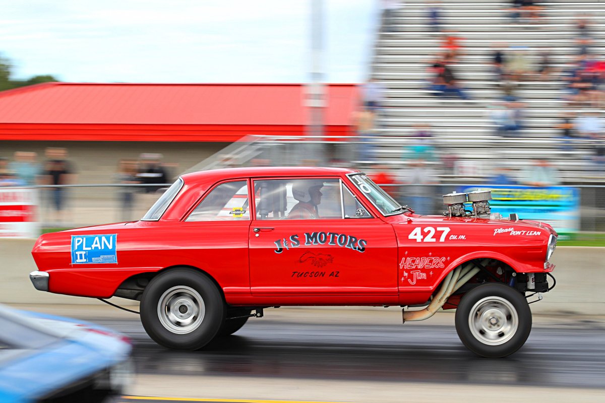

    When you move the wheels forward, it puts more of the weight of the car on the rear wheels. You get more traction when accelerating.
    works really well on my car....but that 55 does look kind of goofy. I guess mine looks goofy, too.

    Ya...goofy 9's...

    I'm thinking the builder wanted to go A to B as quick as possible...does an engines sitting 1/2 way into the cab look good?...no...does it help?...yes.

    More wheelie prone. Moving the rear wheels forward transfers weight onto them and off the front wheels. But it's done for traction, not wheelies. Started in the '60s.

    The AWB cars started back in the 60's because the cars didn't have wider slicks and horsepower was on the increase. So move the axles up and let the weight of the car help plant the slick better. I have to say that anything before '63 with a AWB looks odd. Can't deny it doesn't work though.

    For all you young guys,,The AWB cars were the begining of "funny cars" as thy looked funny..
