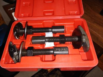

  9. This works, quick and easy most of the time.
    If you don't like that idea, or for some reason it won't work for you, a slide hammer with a hook of some sort will get the job done.
