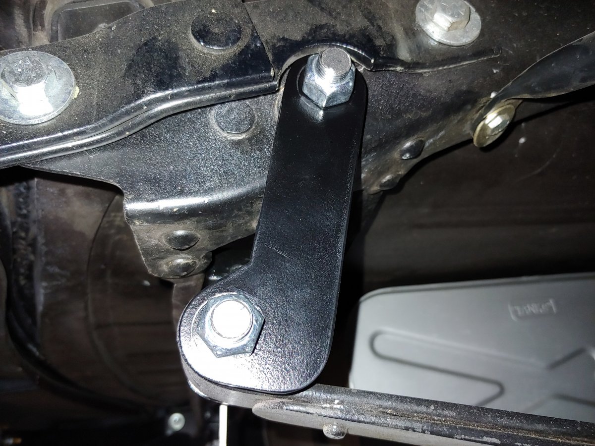

  17. rockable
    Joined: Dec 21, 2009
    Posts: 5,122
    rockable
    The reason my shackle bushings failed was that they had insufficient travel to compensate,for change in spring length as they compressed. Therefore, the weakest link, the small rubber bushings were basically sheared in half by the shackle bolts.
    In order to prevent that from recurring, I made some "offset" shackles that added 3/4" of travel and put the shackles at near vertical when the suspension is at rest. This should solve my problem.

  21. Hey @rockable, I'm unclear how the offset shackle solves your problem. Would you not have to re-locate your top shackle bolt rearward to solve the issue? I'm not sure the shackle shape makes a difference.

    Agreed.
    Having said that, the shackle, as pictured, whether modified or not doesn't appear to be 'wrong' in my eyes. Possibly the original issue was more to do with inferior quality parts, or fitting issues? For instance, they shouldn't be finally tightened up until the weight of the car is on them, as otherwise they're locked in in the suspension relaxed position and are then permanently stressed when the suspension is loaded, leading to premature failure.

  27. rockable
    Posts: 5,122
    rockable
    No, I think this works just fine. The original shackle was straight and it moves though an arc of about 50-60 degrees. It was already at about half of that arc before I changed the design. This shackle will move completely through the arc since it is nearly vertical while sitting in its normal position.
  28. Again, the key issue is the top pivot point at the frame, and the pivot point at the spring when it lengthens and shortens as the suspension travels. Those 2 points remain unchanged. The shape of the shackle between those 2 points is not relevant. If the spring is allowed to slide (removed from the shackle), at full suspension compression, how far rearward does the spring eye travel? Is the arc of the shackle capable of intersecting that point? You may need to move the upper mount rearward, or extend the length of the shackle in order that it can meet the intersect point.
    That said, as @Happydaze notes, perhaps the real issue is the quality of the bushings.
