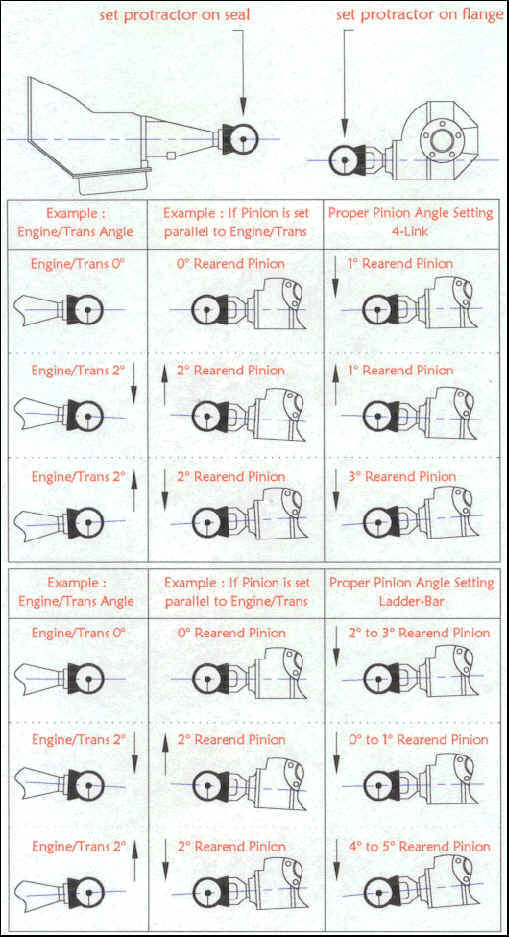

  18. frank dog
    Joined: Aug 2, 2006
    Posts: 655
    frank dog
    Hope this helps.

    Pinion angle is figured off final crankshaft CL amount. It all depends upon the vehicle as to what crank CL you are going to finalize with (considering carb pad level). You then adjust proper pinion angle to the crank CL.
    The theory is available in endless tech reports.
