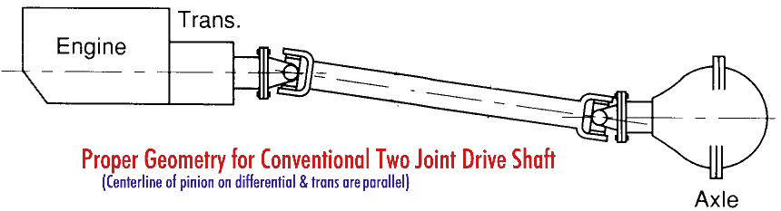

    ... the transmission output shaft and the pinion shaft CL must be parallel...

    I agree with Kultulz, and post #8 (link)
    Carb base and crank centerline are not parallel either, so you can't just go off of the carb base.

    Correct, If your setup is as per this pic and your UJ's are in phase it will work fine. 2-3 degrees down on diff is for race.

    something that seems to have been lost in all this is U-joint operating angle. Yes, the crank centerline should be parallel to the pinion shaft centerline, but also, the operating angle; crank to shaft & shaft to pinion should be kept under 3* , matters not what the other angles are [within reason] , but operating angles should be kept in this range! dave

    Do what you said here , then set your pinion parallel to the trans. tail shaft. If the body is off the frame estimate the weight that will be on the rear of the car and load the suspension before setting the pinion angle.

    You need a couple degrees at the pinion and the transmission weather they (output shaft and pinion) are parallel or intersect depends on the application as in post #18. In leaf spring cars the pinion will tend to wrap up under acceleration but regardless they (output shaft and pinion) need to be close to being in the same plane.
