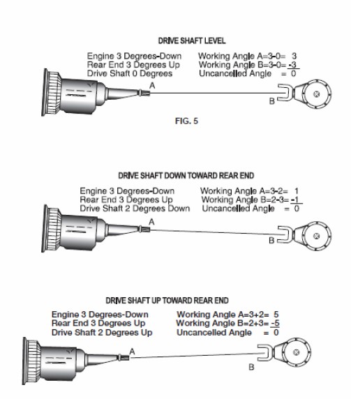

    Thanks for the clear schema.

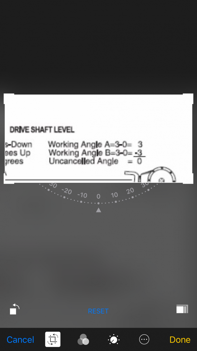

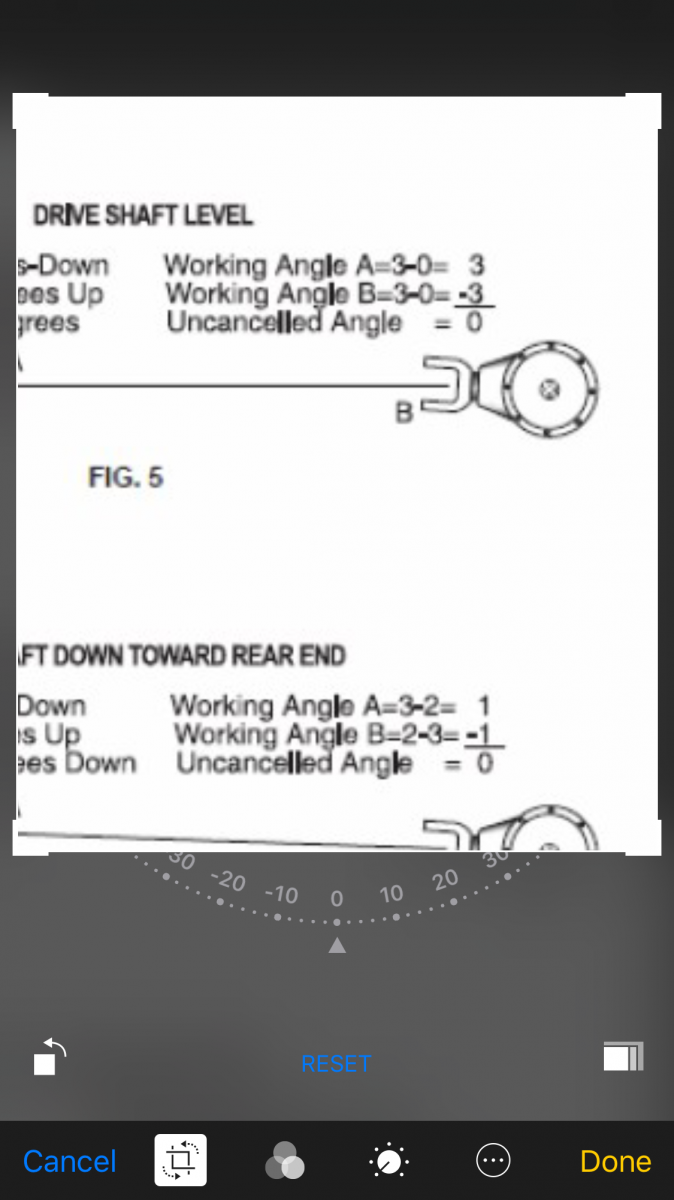

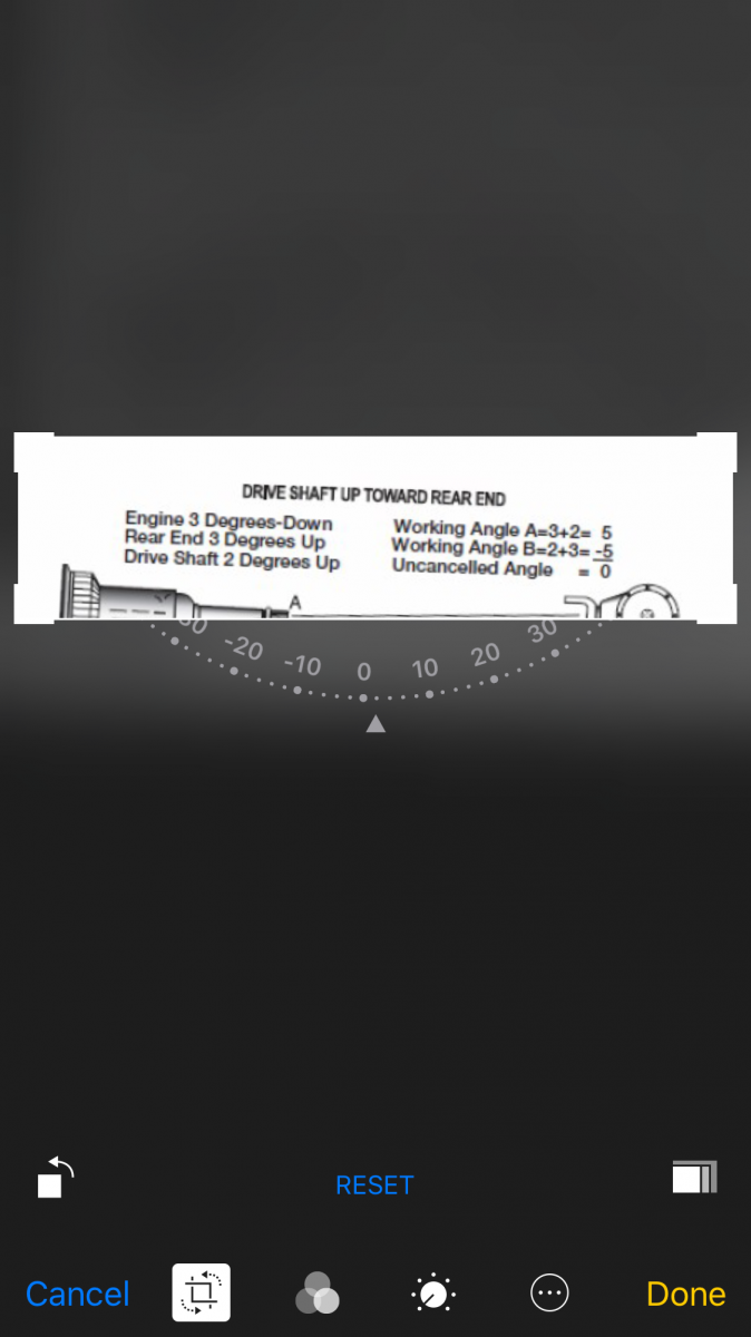

  6. And That image is still wrong.
    The text for drive shaft up is still doesn’t match illustrating media.
    Yep still wrong

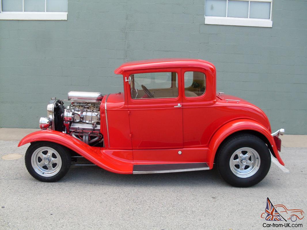

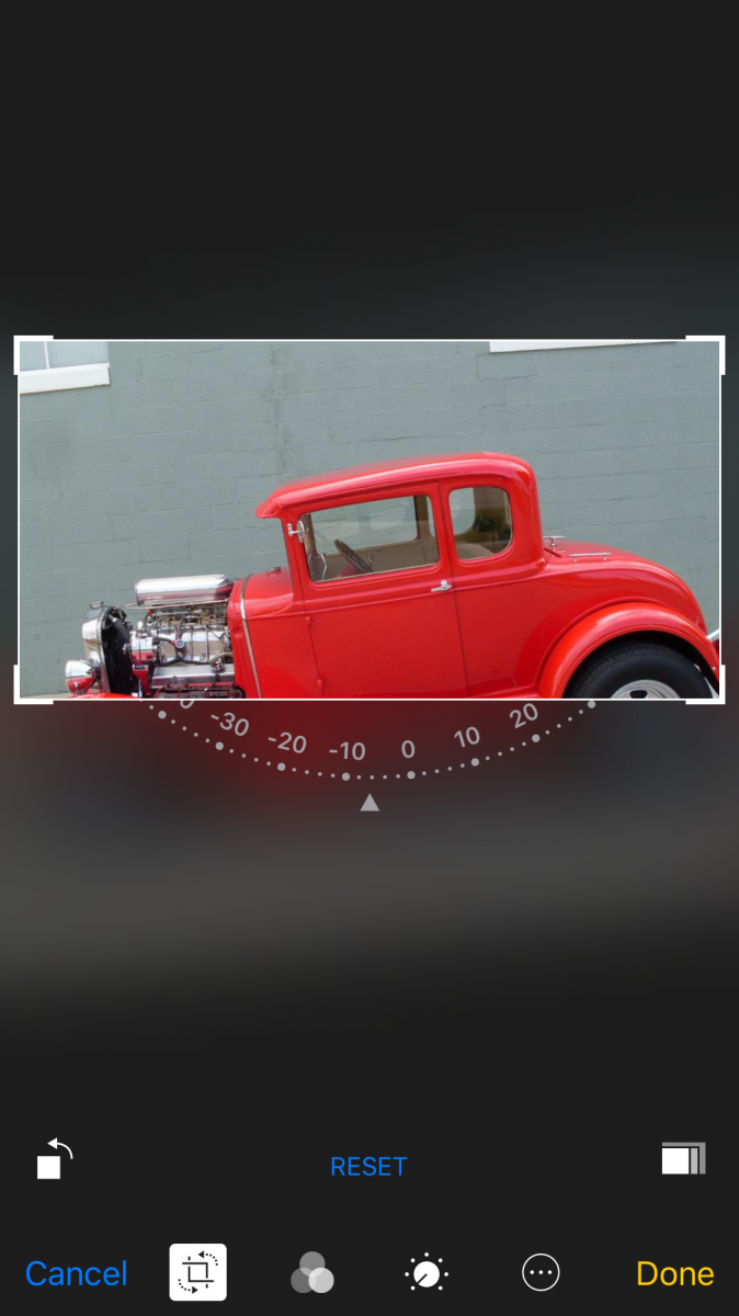

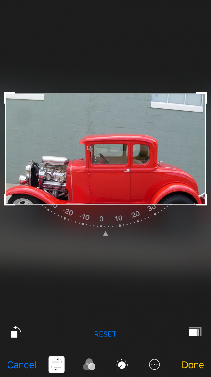

  25. Appears to be a nice car for sale.
    However ,,,
    If you bought it, my condolences
    If you built it, don’t do this again
    Here’s the body line rake
    Protractor on bodyline
    Here’s the results of this stupid 3* so called rule in action
    Protractor on engine
    The more observant viewers might notice the scoop lines up pretty well with the mortar joint that one can be more than reasonably certain the mortar joints are level
    Like my buddy says-
    “I can explain it to you but I can’t understand it for you.”
    dirt t likes this.

  27. Desmodromic
    Joined: Sep 25, 2010
    Posts: 570
    Desmodromic
    I don't get your point. The U-joints don't care in the least what the rake of the body or ch***is is. And the body and ch***is can have a radically different rake relative to each other, except it may look goofy. The U-joints will be happy if the crank centerline and pinion centerline are close to parallel under load, the joints are properly phased, and the individual working angles are reasonable. Joint mfrs. would like to see this limited to around 3 degrees, which is an appropriate goal, but in my opinion, can be exceeded substantially during transient conditions. (I estimate that the same Hooke type U-joints on a Jaguar IRS axle might be at around an 8 degree angle at full bump, and since it is beyond the differential, could see 3 or 4 times the torque in the drive shaft.) Some means to limit axle wind-up is prudent, especially with strong engines.
    As to the proper carburetor angle, I'll defer to those that claim to have relevant experience and knowledge. IMO, they are not as sensitive as others seem to believe. If accelerating or cornering
    at .5 Gs, the carburetor thinks it is leaning back or outwards at a 27 degree angle, but still works fine. SU and Weber side-draft carburetors are generally mounted level, but in several cars, at an approximate 15 degree slope.

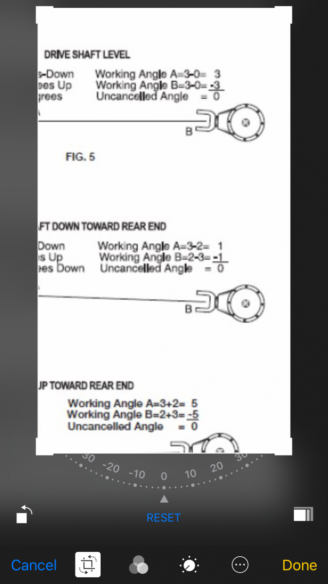

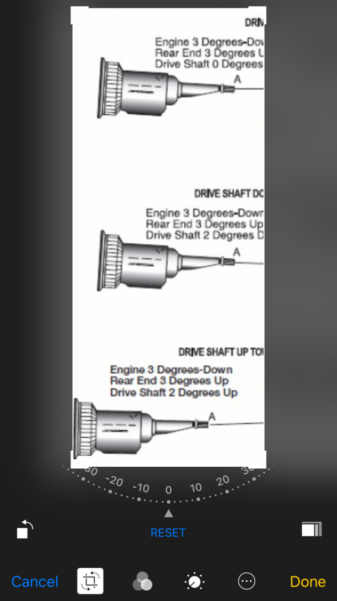

  28. Are you referring to this illustration?
    1 drive shaft level
    Text says “rear end 3 degrees up”
    Protractor clearly shows rear end at zero
    #2 drive shaft down
    #3 driveshaft up
    Text says rear end 3 degrees up
    Again drive shaft up
    Text says “Engine 3 degrees down”
    Protractor clearly shows engine at zero
    Indecently most hot rods with just a little bit of lowering or some rubber rake will wind up in the “driveshaft up”’situation.
    Do the math because they got that all ****ed up too. Engine 0 rear 0 and drive shaft at 2
    The way it’s drawn is the correct way to set it up in your hot rod. Just ignore the text. Much like one should ignore that 3* level carb horse****.

  29. Yeah that’s just one of my points.
    Mega buck hot rod, blower and related jewelry, open hood.
    Yeah so it looks goofy, it’s got to be that way because 3* down rules say so- what’s your point ?
    gimpyshotrods likes this.
  30. A 2 B
    Joined: Dec 2, 2015
    Posts: 609
    A 2 B
    from SW Ontario
    The body rake of that red '30 A shown is irrelevant of pinion angle regardless of how it looks.
