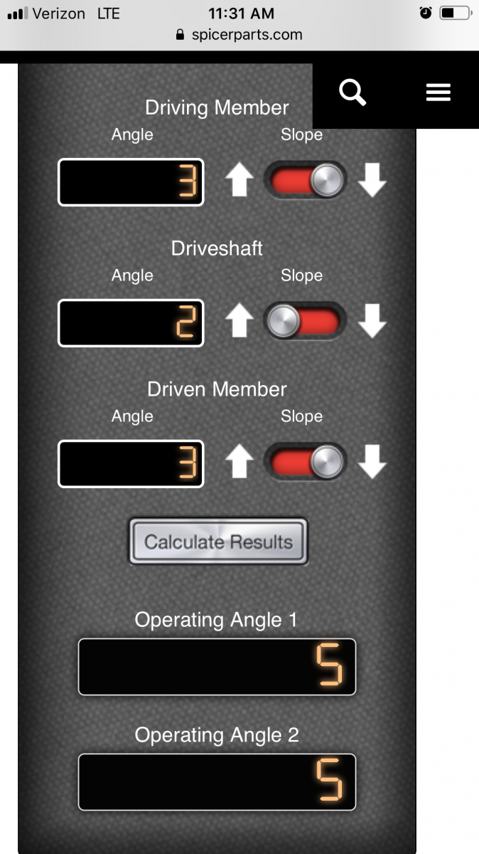

  8. Well let’s at least correct the “wording” of the narrative, that might help. Let’s see as I explain it correctly Parallel verbally.
    Trans down towards the rear 3*
    Pinion down towards the rear 3*
    Drive shaft up towards the rear 2*
    Plug in the values with slope correction.
    Ok!! Now we’re at least Equal.
    Just dont ever drive your hot rod over 3500 rpm according to ****er.
    FAIL AGAIN!!!
    And those drive line angle looks like this.
    That drive shaft may even be uphill to the Diff more that 3-4 degrees.
    Keep her under 2500 rpm
    You’ll be good.

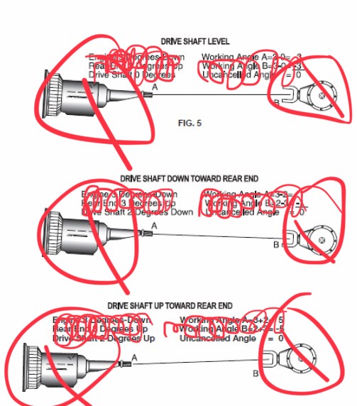

  9. If it’s at all possible,,,
    You guys would be way better off to get selection amnesias and forget that ******** narrative of “must be” rules.
    At least quit repeating it and quit posting this image for Pete’s sake. ITS COMPLETELY ****ING WRONG @mgtstumpy and innocent guys think it makes sense.

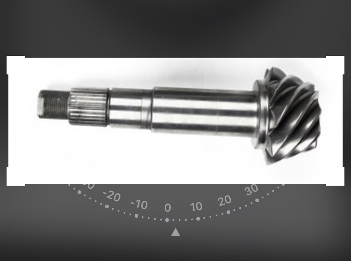

  16. Slope is always read left to right,
    Always and that’s a rule!
    Any two lines that are on the same slope are parallel. Also Parallel lines are on the same slope. Always and by definition that’s a rule too !
    Since Mostly the goal with drive lines is to get the center line of the trans out put shaft and center line of the pinion gear parallel, we aim for the same slope.
    Slope always expressed left to right
    Engine down x degrees
    Pinion down x degrees
    This is a pinion gear
    It’s shown at 3* down slope
    This is a rear end housing holding the pinion gear and it’s slope is down.
    Slopes down
    This pinion gear is sloped up

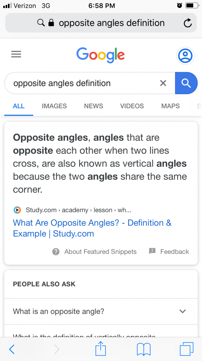

  18. Well that’s why I rephrased.
    “Body rake” could be established by shims. Shims between the body and ch***is. Or by wedge channels and changing the angle of the body in relation to the ground and the ch***is.
    Any of that would have no effect to the ch***is.
    As soon as you tell me that ch***is rake makes no difference to pinion angles that’s when I’ll tell you. You might need it.
    Btw - this is a highly conflicted statement.
    I have always relied on parallel placement with opposing angles.
    Opposing means opposite

  21. Those people who make the U joints tell us what’s acceptable for their product. I went thru it above and screen shot the all the results.
    A result of 5* is good for 3500 drive shaft rpm. If the vehicle is built and geared for highway cruising speeds of 60 mph with a 2000 engine rpm target then you’ll need to be reaching road speeds of 100 before reaching the maximum manufacturer set limits of driveshaft rpm. Change the mix of gearing in a build and we could see easily 3000 rpm at highway speed and simply p***ing a truck will exceed the manufacturer set limits.
