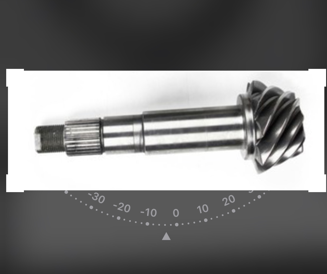

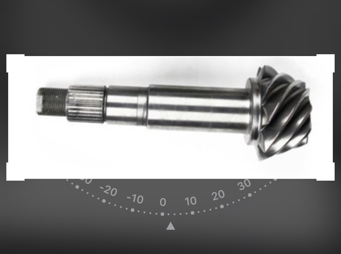

  23. Great post shift wizard.
    Nicely worded and great points.
    3 categories figuratively seems like this
    Here’s the results in reality
    I’d really like to comment on V8 bobs post,
    But I’m not going to ask him which side of the car he’s standing on or if he’s following the rules for reading a slope, because one really needs that information. “Broke back” seems to imply opposing with the trans down towards the rear and pinion up towards the rear,,, but he said trans down pinion pinion down and that expressly describes parallel.
    The trigonometry calculator won’t give correct information if the slopes are messed up.
    I understand that math isn’t everyone’s strongest suit, but this driveline angle stuff is nothing more than a simple trigonometry problem.
