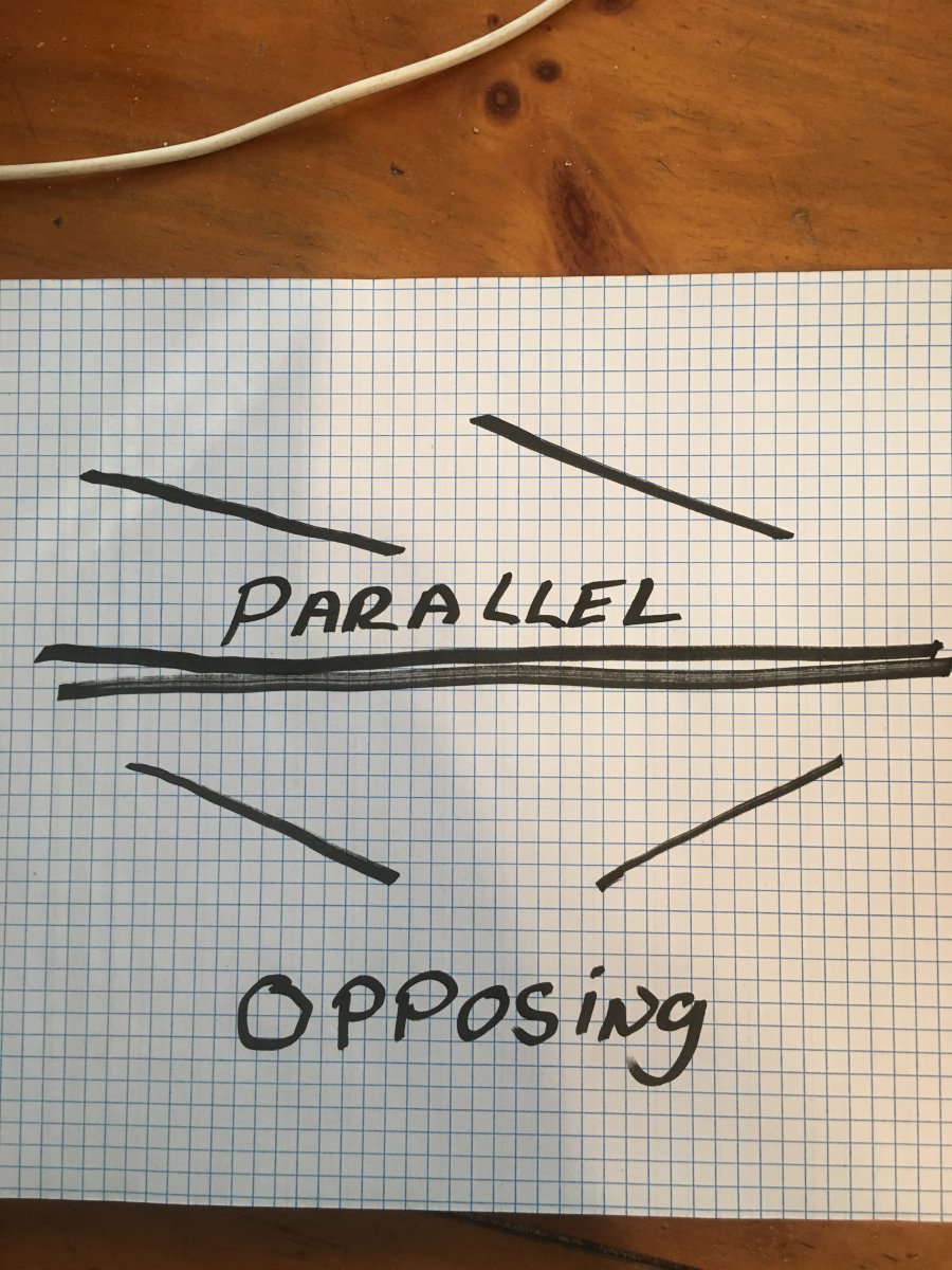

  8. Examples
    In the real world, in the parallel example above, Both are pointing down.
    In the real world, in the opposing example,
    Left is pointing down and right is pointing up.
    The angles are indeed opposite.
    Also Resembles a wide U
    In the hamb world the opposing example pictured above supposedly is not compromised of opposite angles.
    It’s perfectly acceptable to build a driveline in the opposing configuration provided the ujoint working angles are relatively equal.
    It’s useful on low slung vehicles
    buzz4041 and HotRod33 like this.
  9. That’s all great speculation and I bet every individual can express it differently in their own way. Which sort of just perpetuates the confusion. I certainly didn’t make up these terms, write out their definitions, nor did I disregard them. I never had any part in discovering the wonders of angles nor developed the common ground to work with them.
    In all respects it’s a technical subject and to discuss it the terms shouldn’t be eviscerated and definitions ignored. But **** it that’s what today’s world is all about right?
    As far as these so called academics ( not school work) getting lost in the shop,, well who the hell decided righty tighty lefty loosy Any ways? If you want it loose you need to follow that rule. And sorry but that 1/2” wrench is not going to loosen up a 1/2” bolt, it should right they are both 1/2”. Fight it all you want.
    Oh there’s no telling if that’s true or not.
    Maybe they are on their back looking up at the damn thing when they start explaining it. You’ve got no idea what’s going on in the shop nor what’s getting lost, as you say.
