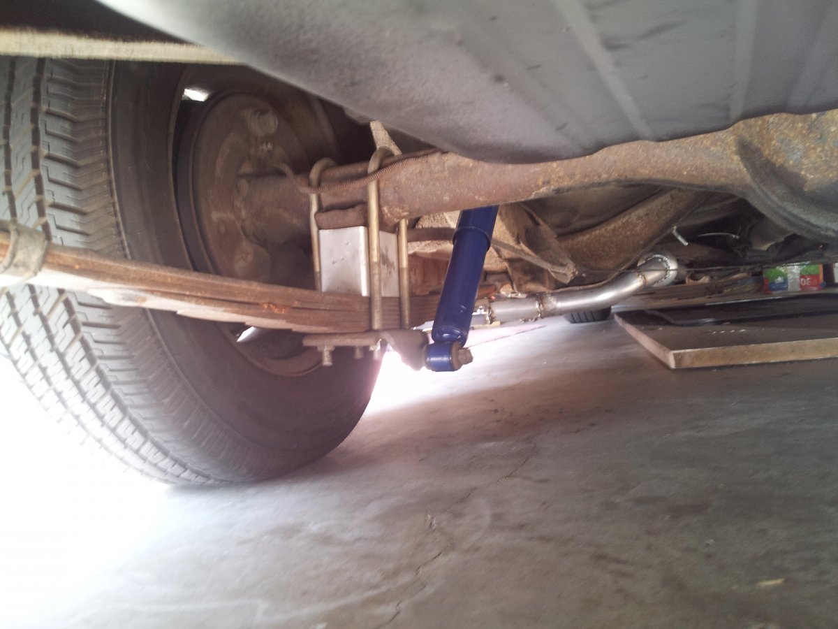

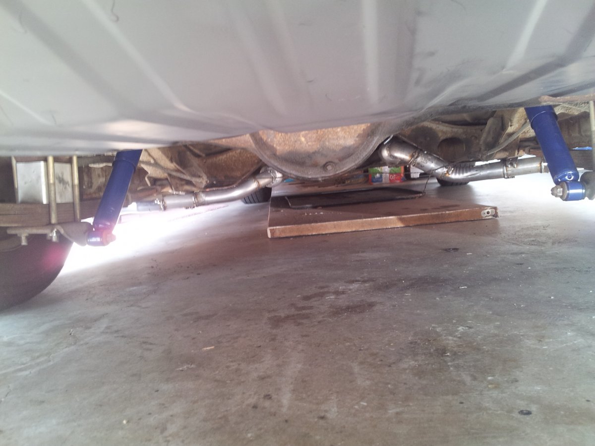

    It was jacked up in those pics so I could get under to take the pictures.
    Sorry for the confusion. I will get my son to crawl under and take some pic's sitting level.
  16. captaintaytay
    Joined: May 24, 2011
    Posts: 1,214
    captaintaytay
    Sitting level on the ground.

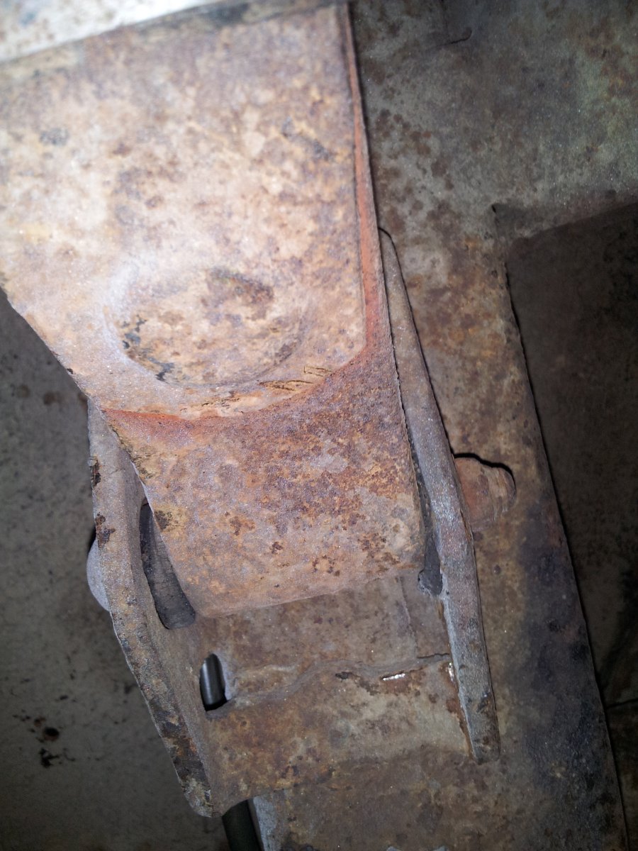

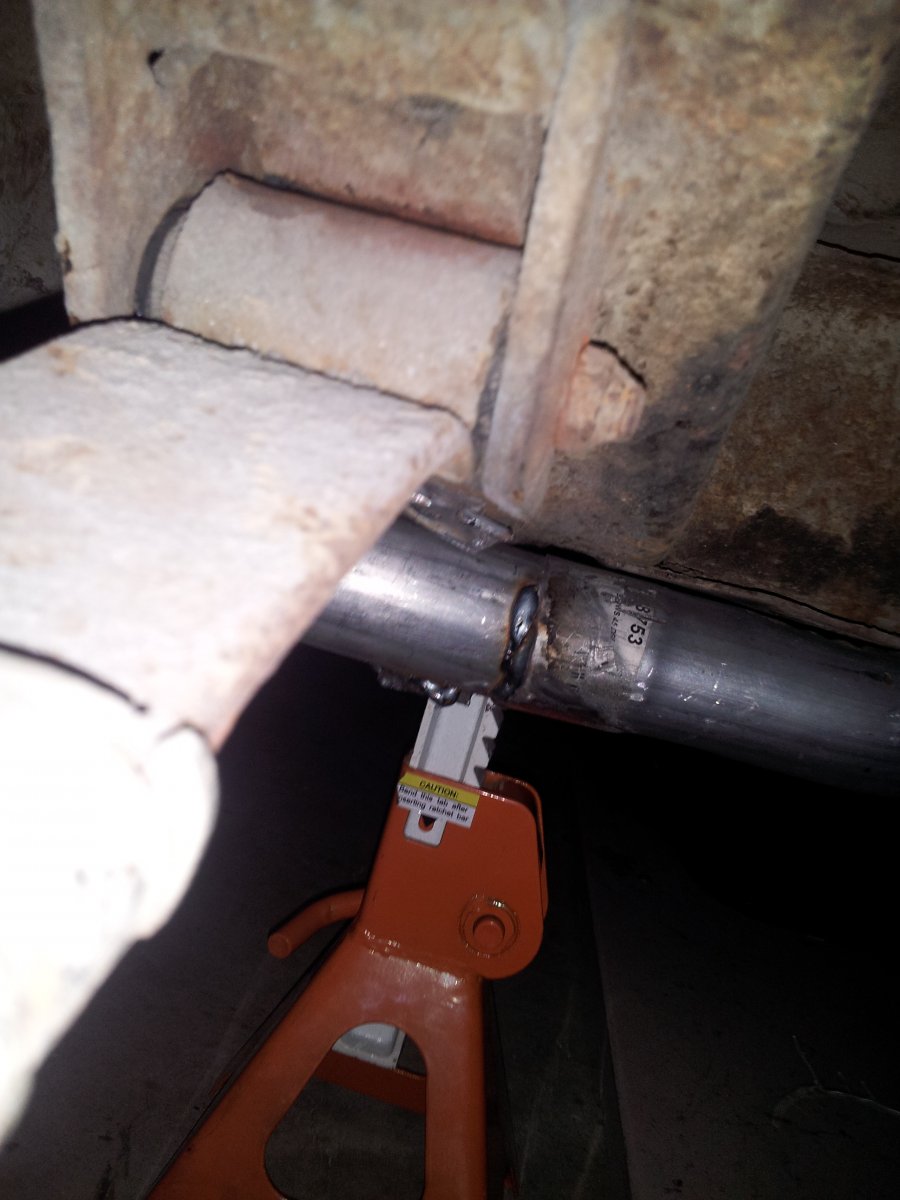

    Checked everything I could underneath. I did have to re-torque the u-bolts. Going to pull springs out and de-arch and replace the bushings. I'm also going to take it to a buddy of mine that owns a frame shop to check front alignment again.
    I'm sure this didn't help matters.

    I don't see a clear picture of the shackles but they may have flipped. Flip them back and you can probably sell those blocks for s**** aluminum. Harley
