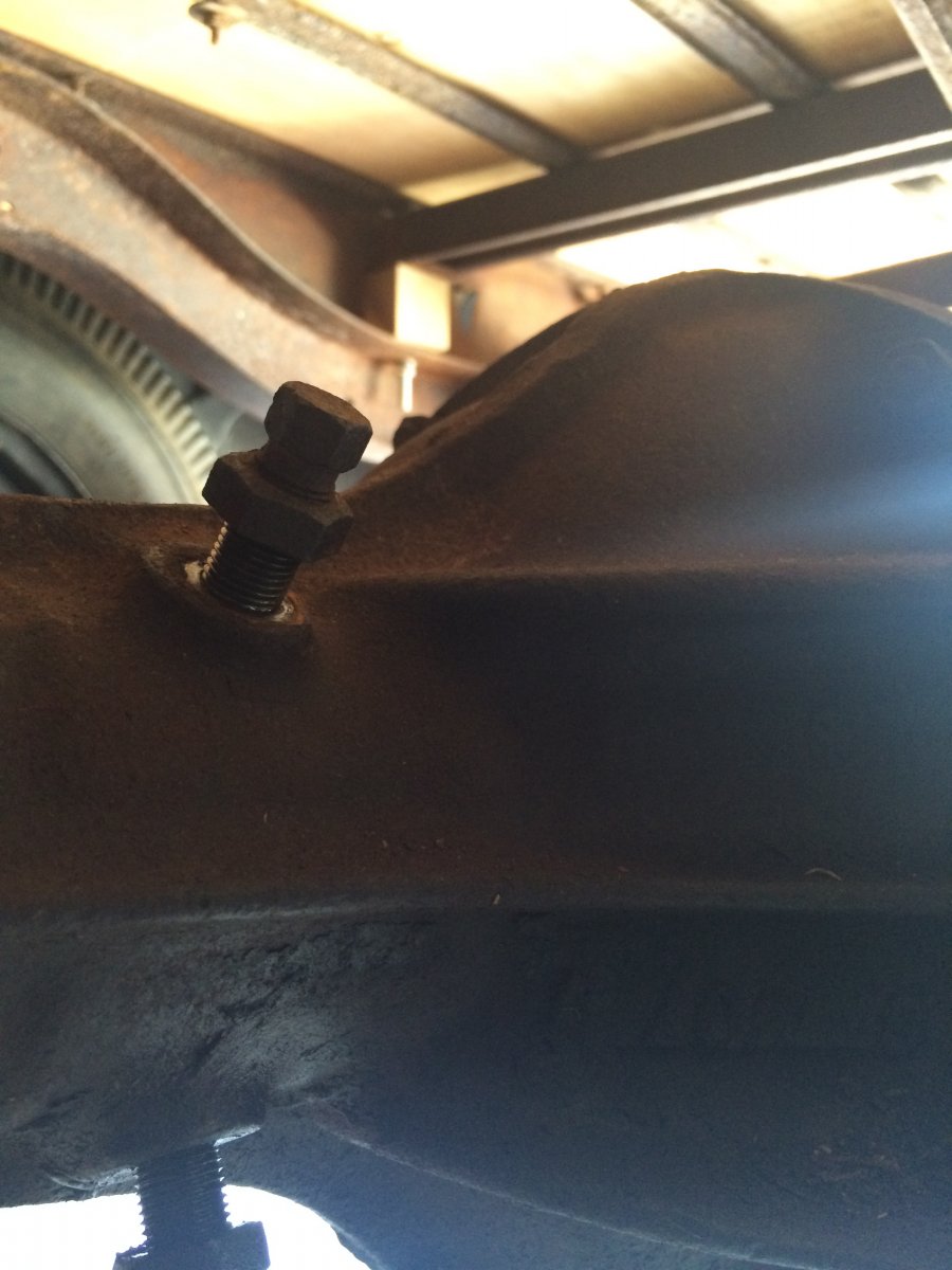

    image.jpg So would this be the drain plug on the right and fill on the left ?? What's the plug on the top for is it some sort of vent? 1937 Chevy rear end!!

    image.jpg Would this center plug also be a drain plug ??

    Fill and drain on the front two, maybe the one in the pumpkin is to check the level? Most transmissions you fill until the oil spills out the fill plug. But maybe you fill this one until it spills out of the plug in the pumpkin.
  5. tazareno
    Joined: Jul 21, 2010
    Posts: 49
    tazareno
    Center plug looks like a fill/check plug. Not sure about the other two
  6. Rusty O'Toole
    Joined: Sep 17, 2006
    Posts: 9,756
    Rusty O'Toole
    Center plug at the back is the fill/level plug. Fill till lube drips out, or check by sticking your finger in to the first knuckle. If you can touch oil it's full.
    Drain plug will be a similar plug, at the lowest point on the diff.
  7. Dan Hay
    Joined: Mar 16, 2007
    Posts: 6,457
    Dan Hay
    The two lowest are not low enough to get all the gear oil out, so maybe the back one is for inspection?

    center plug is the fill plug put the top bolts back how they were.no drain plug.it might drain if you took out a bolt on the bottom of the cover.
  9. Barn Find
    Joined: Feb 2, 2013
    Posts: 2,312
    Barn Find
    from Missouri
    Those three on the front are not drains or fill plugs. See the jam nut on them? That means they are adjustable for some reason. I don't know anything about 37 Chevys. I would be afraid that they set bearing pre-loads or pinion position or something else that shouldn't be fooled with unless you know what they are for.
  10. onetrickpony
    Joined: Sep 21, 2010
    Posts: 860
    onetrickpony
    from Texas
    If it doesn't have a drain, get a suction gun to pull the oil from the fill hole. They are only about $20.
  11. squirrel
    Joined: Sep 23, 2004
    Posts: 59,982
    squirrel
    if you turn those funky screws with the lock nuts, you need to do some adjusting...
    There is one plug on the back, which is the fill plug. If there is no drain plug on the very bottom of the housing, then there is no drain plug, and you remove the cover to drain it, or you use a suction device to **** the old oil out if you're too lazy to do it right.
    lothiandon1940 likes this.
  12. TagMan
    Joined: Dec 12, 2002
    Posts: 6,364
    TagMan
    Squirrel is exactly right - don't touch the screws with the lock nuts ! The screw have a tapered end, that exerts pressure on a collar which in turn, preloads the pinion bearings.
    The correct way to drain the oil, according to the '37 Shop Manual, is to remove the cover. I usually remove the lowest cover screw and let it drain overnight, then remove the cover and clean the housing with a rag, as much as possible. Don't, however, go squirting any solvents on the pumpkin - just wipe it clean as you can.
    -Bob

    Man I already took those completely out I haven't moved the truck though, nothing came out no gear oil, I will tighten them back up and remove the cover, I hope nothing was disturbed!

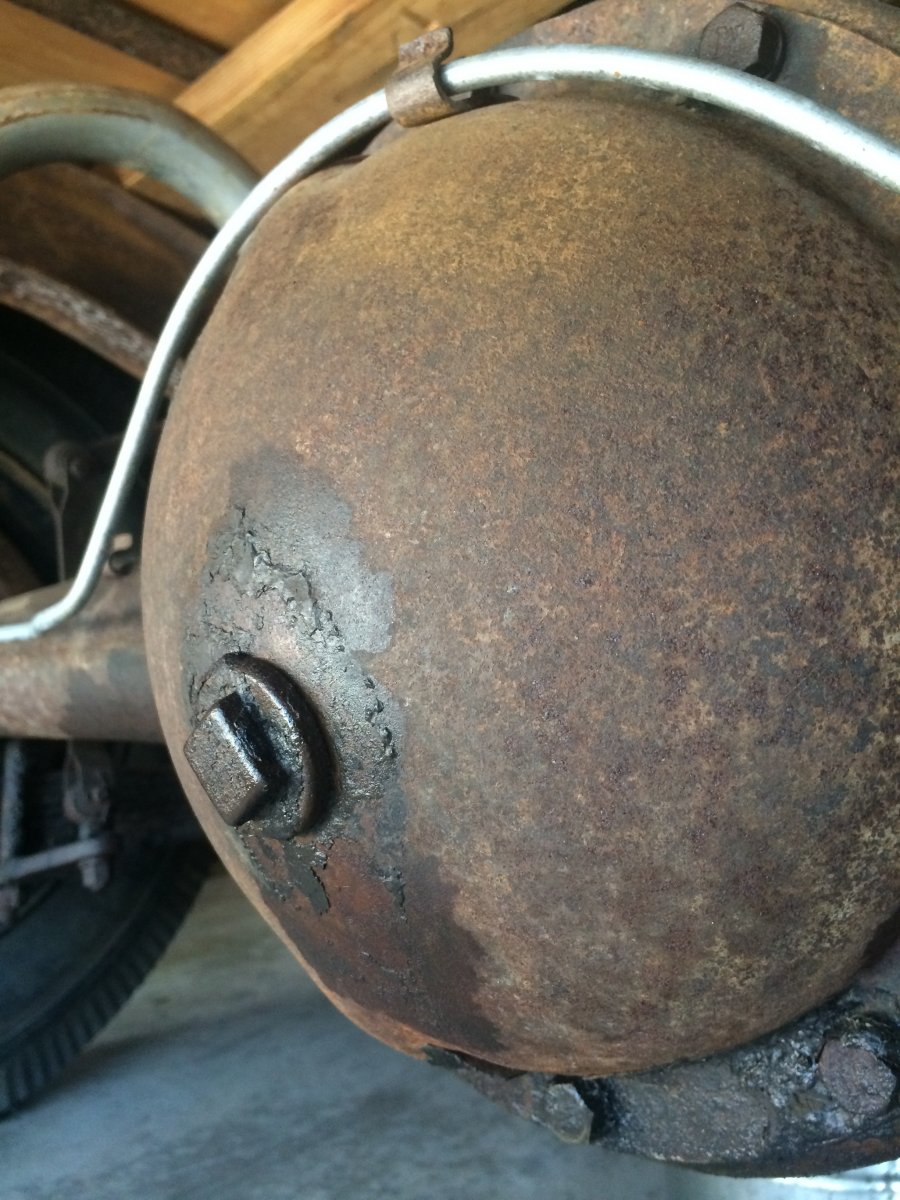

    image.jpg So would the fill plug be the one in the center of the plate?
  15. belair
    Joined: Jul 10, 2006
    Posts: 9,036
    belair
    The fill plug is the big square one.^^^

    If you din't move the jam nuts in relation to the screws, you can likely just screw them back in until they touch.
    If you loosened the jam nuts, just screw the bolts in until they touch and resnug the jam nuts. Probably didn't disturb anything.
    If you have screwed it up beyond repair, I have a completer rear end you can have for the cost of the shipping.
  20. squirrel
    Posts: 59,982
    squirrel
    Probably didn't hurt anything, as he said, just snug the bolts and tighten the jam nuts.
