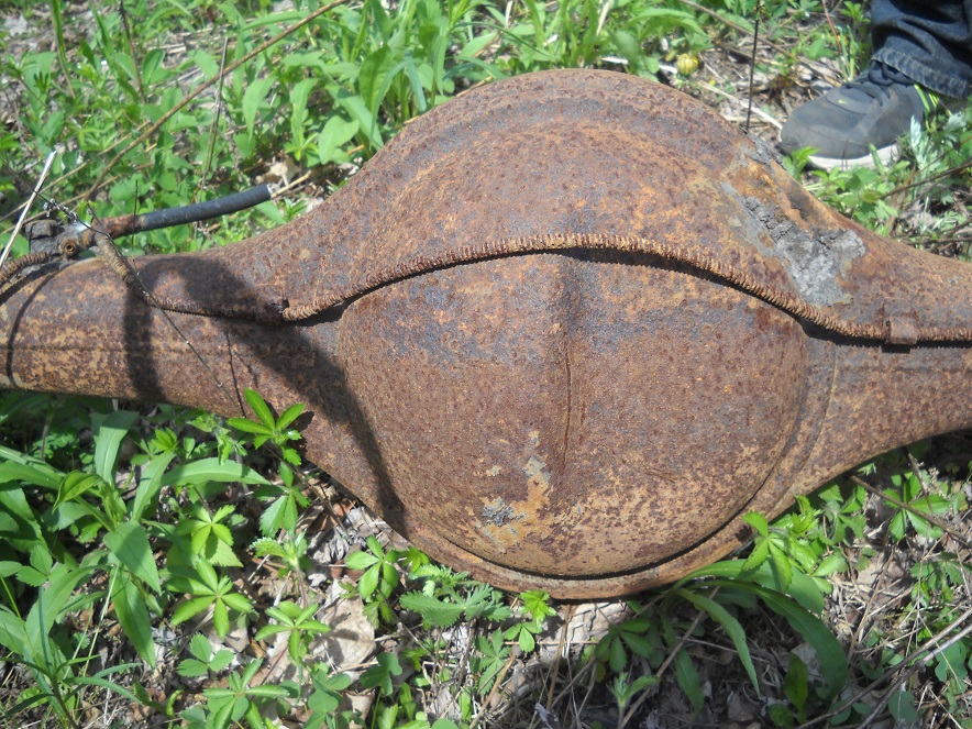

    will some help me i.d this rear end im pretty certain its a 8 inch or a 9 it has 10 holes for the gears and for mounting the axels it has 4 I don't know a lot about fords

    I think it mite be a early 8 3/4

    Looks Like early Olds, Pontiac, style rear.Not Ford or 8 3/4

    Agree with the olds/pontiac

    Olds/Pontiac for sure. 57-64 Diff. You have a three rib carrier, visible in you 3rd photo, somewhat rare and superior to the usual 2 rib. Looking at the leaf spring mounts prob a 57 Pontiac, worth some bucks to someone as a direct bolt in to 55-57 Chevys.

    62/64 Olds/Pont. Rear in a 57 housing. The best ones out there. Nice find. Bolt in for 55/57 chevy or 56/62 corvette.

    yea I should of know its not a 9 inch there more ovald and theres a 58 olds parked rite next to it but is it a good rear end are they strong is it worth getting?

    Definitely Olds/Pontiac, definitely strong. Not only strong, but one of the coolest rears out there. I'm running one under my '38 pickup. That is...if I ever finish the damn thing!

    Heck that was the rear end of choice for racers a long time ago. rebuild it and it will be nearly bulletproof

    What is the bolt pattern? 5 on 5 would be olds, like others mentioned.

    I swapped the Olds/pont rear into my vette in 1967 because even a built 283 or 301 could break the chevy rear. They were very strong for the day. But with todays tire compounds, even the mighty 57/64 Olds/Pont of yesterday can easily break some decent power and traction. Today the only part I use is the main housing, With a 35 spline spool and axles. And I still have managed to twist the axles. WTF??
