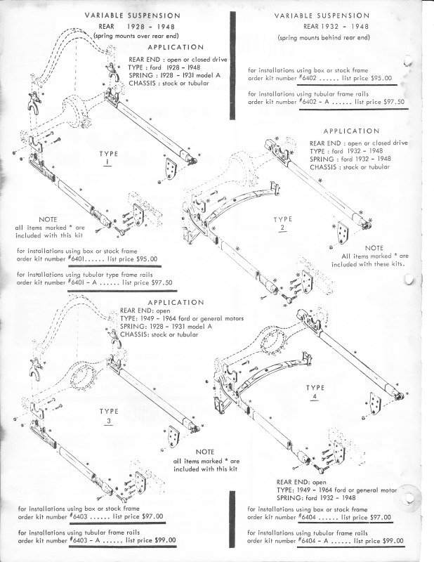

    Heres a neat use of 36 radius rods with 9 inch.
