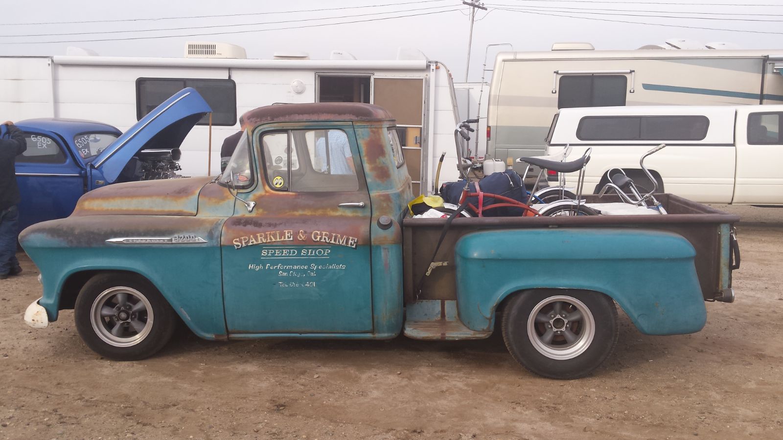

  8. lumpy 63
    Joined: Aug 2, 2010
    Posts: 3,343
    lumpy 63
    It completely fills the wheelwells with not a lot of room to spare:D

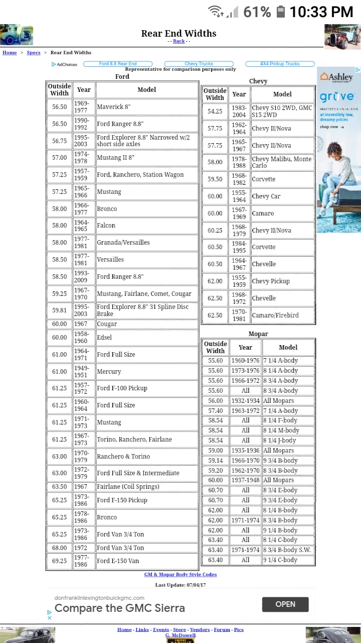

  9. Lloyd's paint & glass
    Joined: Nov 16, 2019
    Posts: 10,796
  10. hpBent
    Joined: Jul 16, 2019
    Posts: 79
    hpBent

    So it's been a while... I am finally picking back up on my project. I forgot to ask you about the backspacing on your wheels on the rear? And, what are you running up front for wheel/tire and suspension? Thank you!
  12. lumpy 63
    Joined: Aug 2, 2010
    Posts: 3,343
    lumpy 63
    If memory serves me the back space is 3.75 the front wheels are 15x6 with 215 70 r15s
    hpBent and Truckdoctor Andy like this.
  13. lumpy 63
    Joined: Aug 2, 2010
    Posts: 3,343
    lumpy 63
    IMG_20241226_180532.jpg It has a subframe swap on the front but we're not supposed to discuss that here
  14. hpBent
    Posts: 79
    hpBent
    Thank you for the info. It look good and the patina is awesome!
