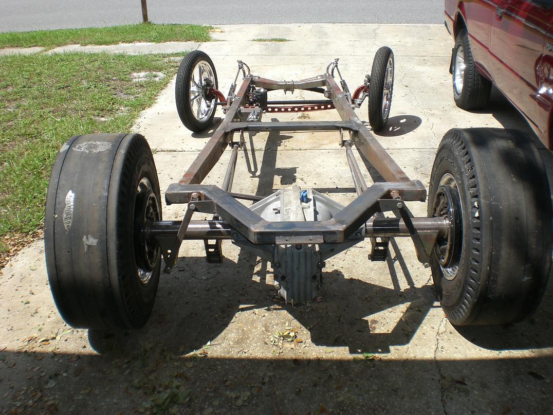

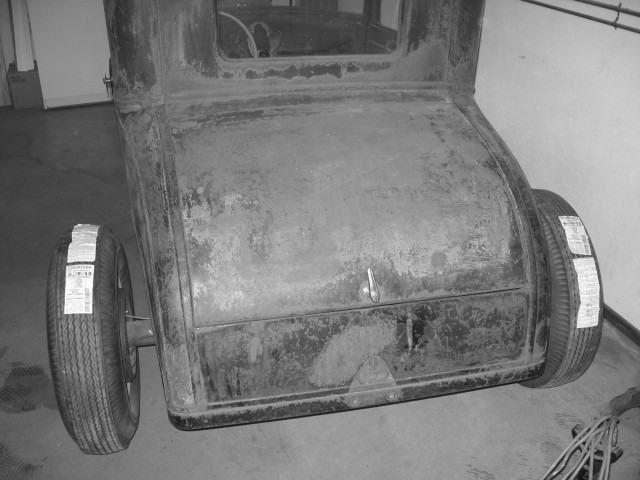

    This is what I'm running under my 27 Roadster w/ a ch***is.
    This is under the coupe. It'll get the Hot Rod Works conversion to 9" shafts since my Y Block will be a tad more powerful than a flatty.
