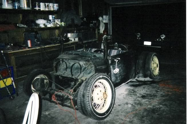

  13. When Walt reached that point, he mentioned in his build-up progress thread, that the design flaw using those two components was something that bothered him... so he did something about it. Here's a close-up.
    http://exphose.com/albumtn.aspx/mid_7-95F7CE17685349A3A9799FDF401F5AD5.jpg

    http://exphose.com/albumtn.aspx/mid_7-55BA11FC360C4E4CA4AD568F5243E015.jpg

    Here's mine, sorry to offend soon to get the 28 grill and ford axle treatment in front.
    http://img.photobucket.com/albums/v295/PAPA_SMURF00/scan0001.jpg
