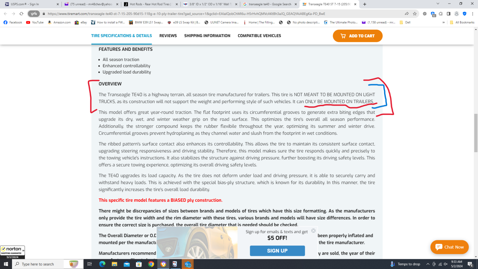

    Good lord, those would ride rough as hell on my car trailer. They are for a 10,000 lb rated trailer with 4 tires. Plus the manufacture says not suitable for light trucks. Screenshot (98).png

    They are trailer tires not meant for p***enger car or pickup use. I understand money can be tight and getting tighter but the safety of your self and family are more important than not getting the right tires. Tires are no place to scrimp.

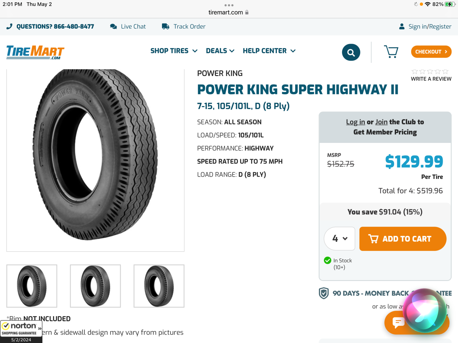

    How about these? 7:00x 15…29.5 diameter, load range D

    I would not venture out in the rain. The tread is meant to just 'tail' along not transfer power.
    Not being bossy bu ut,, Keep looking

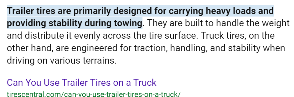

    Trailer tires don’t say “trailer” on them for no reason…

  21. Zax
    Joined: May 21, 2017
    Posts: 991
    Zax
    Sharpone and swade41 like this.
