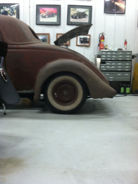

    Just working on another CE set up on my coupe, same results---too high, higher than my kid's '36 with a stock buggy spring. Made a set of blocks to get it lower and in the center of the wheel well.
    Picked up a set of Posies '35-'40 parallel springs from the cl***ifieds and going to try a set of their
    adjustable mounts on the '40 sedan (if I ever get to it).
